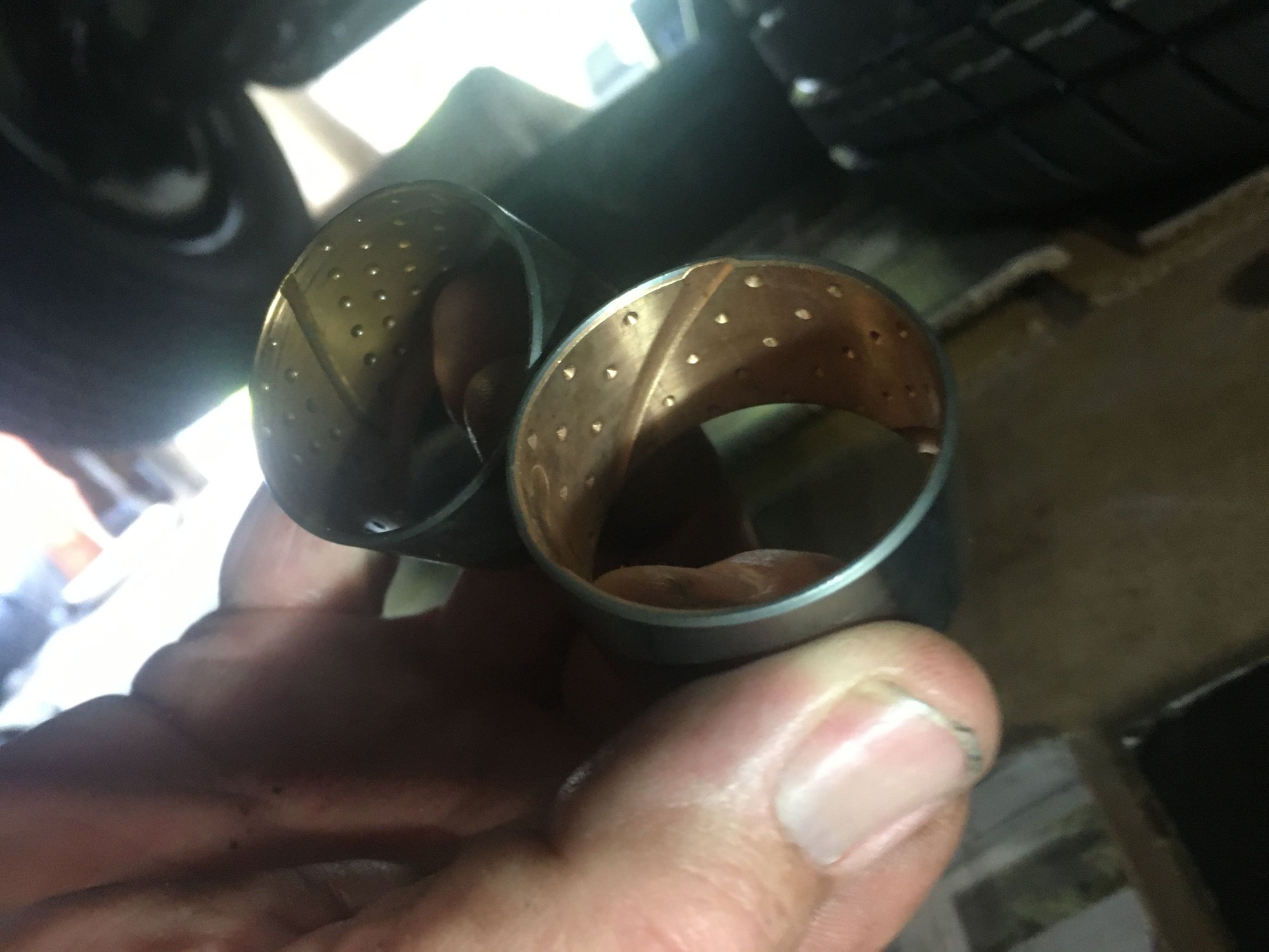

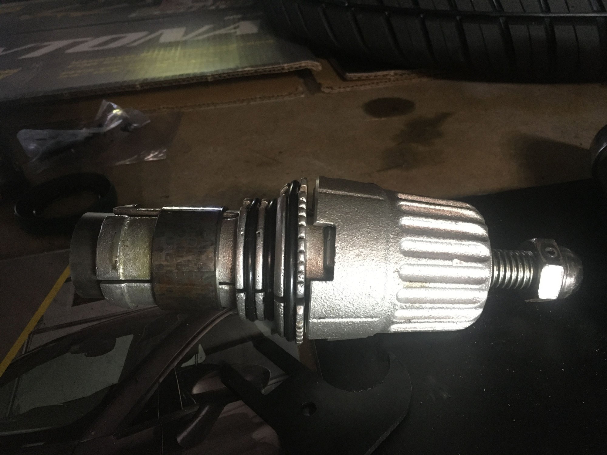

Got it done today in about 15 minutes taking my time though I did make 2 round trips to the shop doing the rebuild on my differential. That was good for about 150 miles but though a lot of driving that tool saved me a ton of labor not having to remove the exhaust and drop the trans to take to the shop.
The tool itself was of good quality and from what I’ve seen in my search it’d be one of the crazy expensive ones probably around $400. I made sure to return the tool clean and promptly because when a pro mechanic trusts you with one of his specialty tools you don’t take that lightly.
It made the task ridiculously easy. Once the bushing was out it wasn’t too bad but showed the odd wear pattern that you’d expect from the ball worn yoke.
It looks to have been replaced as was the seal but was doomed to an early failure because they put a ruined yoke back in when it should’ve been replaced.
That will be done that right way now.
