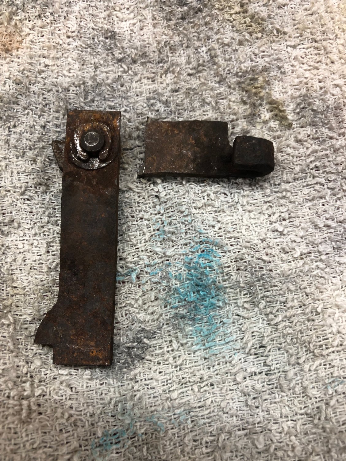

Worked at it for half an hour. Not enough clearance. So decided to cut activator in half. Came out nice and easy. Turns out clip on underside but too rusted to see or take off. Hope new one goes in easier.
