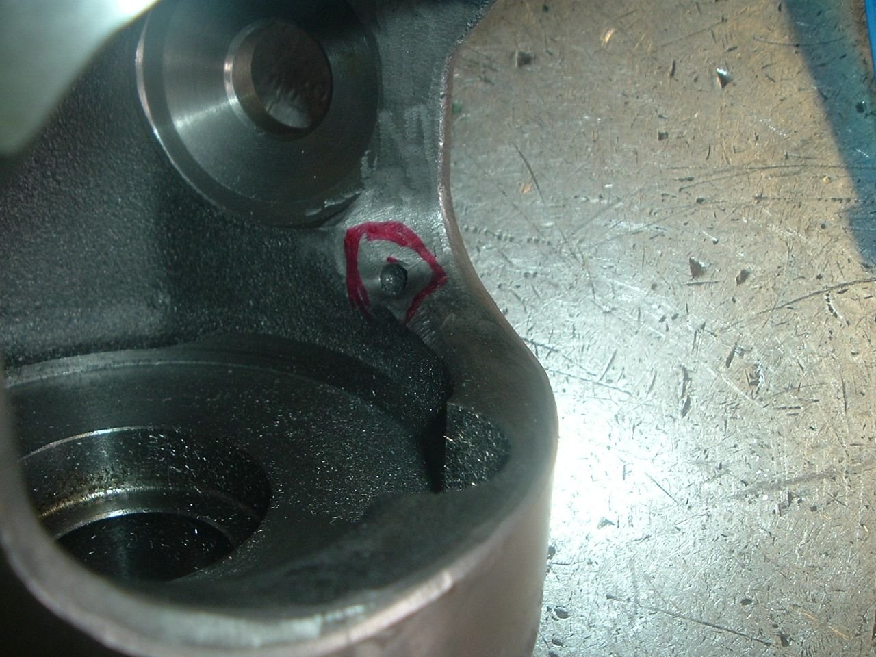

I started to blend the bare housing and found a good size casting hole in it. Looked like someone spotted it with a ¼” drill bit. This case was then reassembled and shipped back to Summit for a replacement.

The pin hole is not common, the sloppy setup I have seen plenty of times. Once assembled it will work, smudging away the clutches at every turn. The oil will be black in 100 miles.

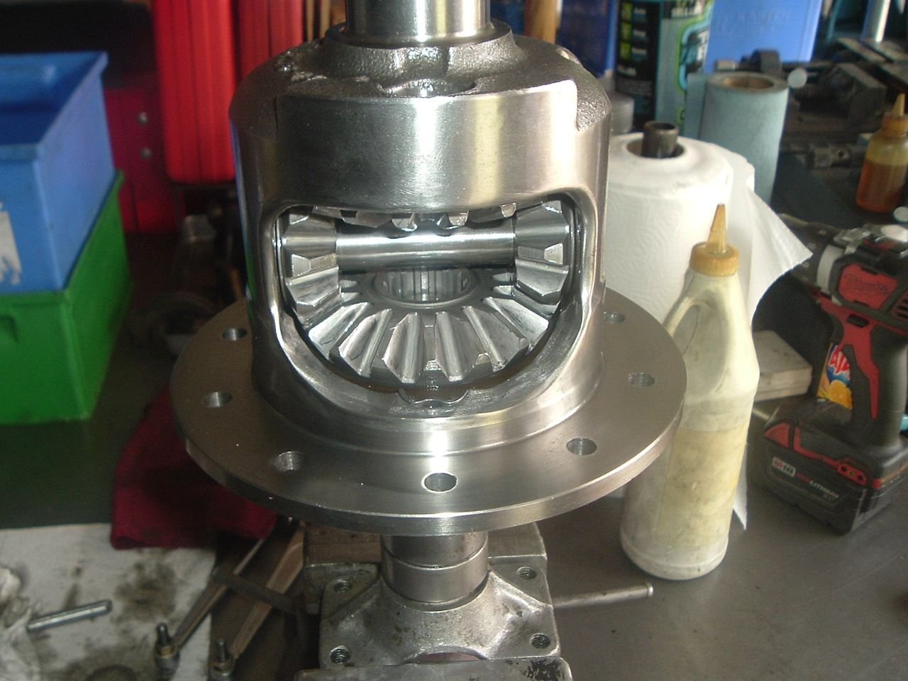

New case opened, checked, polished and tuned. No lash, no endplay, no binding, requires grinding shims to size and correct knowledge on how to do it. Action is smooth and quiet. Balanced between the sides.
Note.
I did not invent this procedure, it has been around for 60 years or more. Done correctly it works better than a spring pack setup. Done incorrectly and it will act like an open diff or bind and break the spiders.
