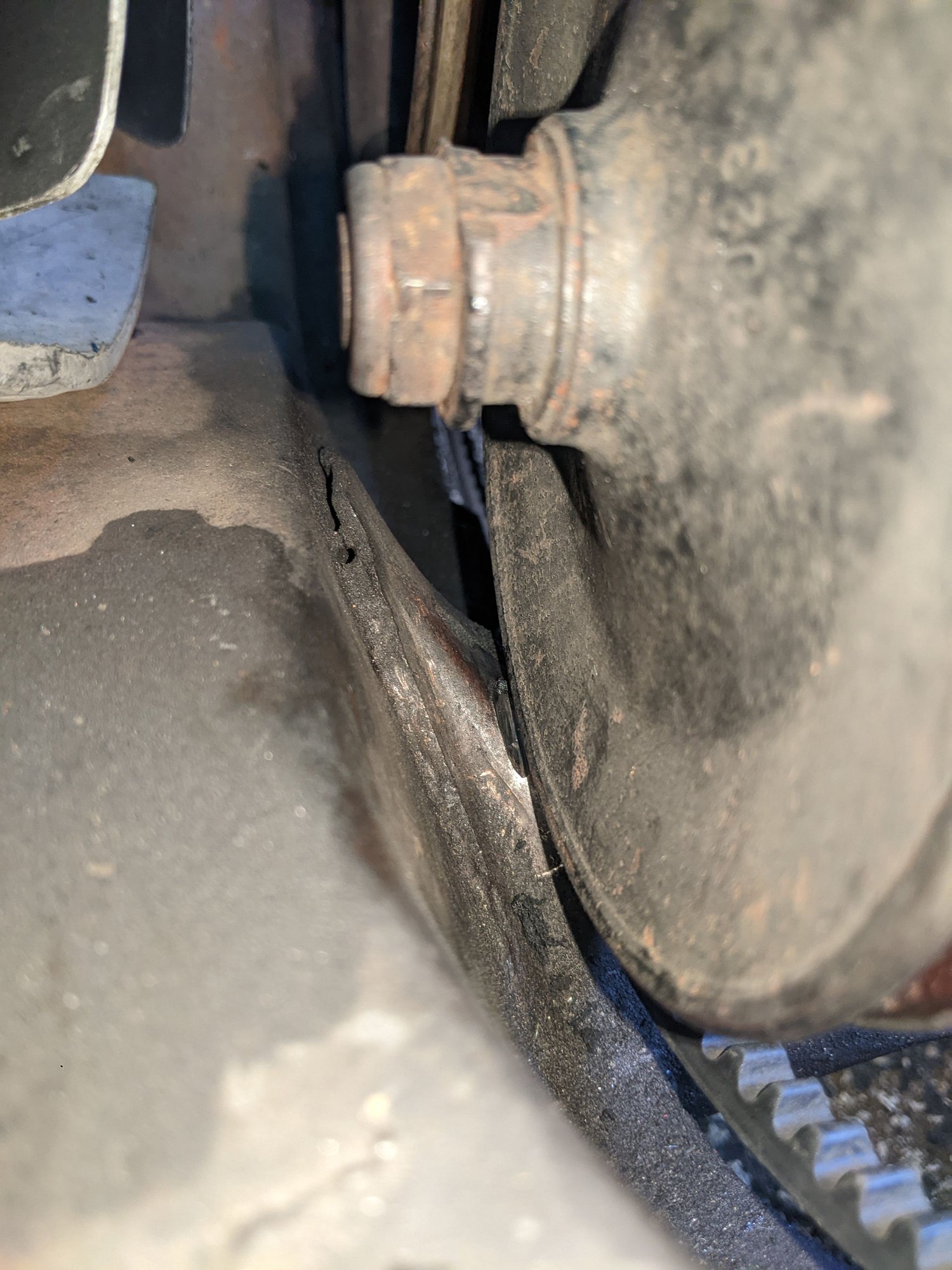

Ah, I can also say that I have installed a poly trans mount, and with what you said I can almost guarantee that it is taller than a stock... so that can definitely be contributing to my issue.
​​​You can see where the belt surface has been abraded to the same height as the pulley.

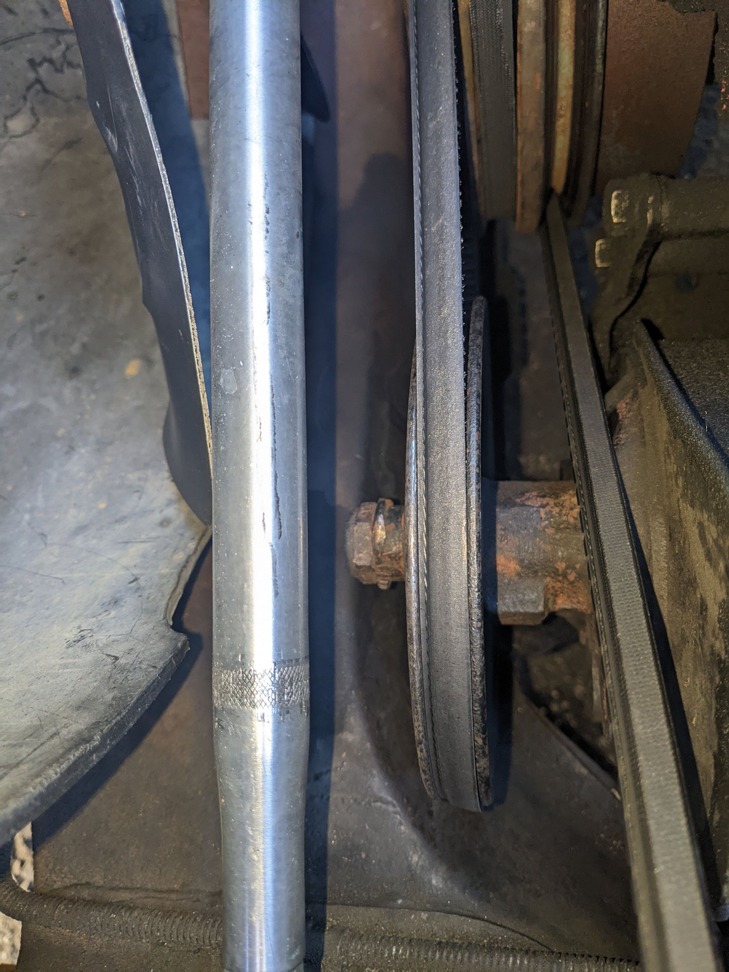

Here is a better pic of the rubbing:
I am thinking that switching to a stock style trans mount will do it!... Too bad I'm 450 miles from home and my floor jack!

The cheapest and easiest thing to try first would be a slightly shorter belt, it will pull the pump inward and upward based on how the bracket is set up IIRC. Or even just a fresh belt of the same size. It's possible your belt is stretched.
I remember running into this myself, and had to try a couple different belts to get everything to fit correctly.
Old Jul 14, 2023 | 06:14 PM
4-vettes's Avatar
4-vettes
Posts: 13,225
Likes: 7,823
Cruise-In VIII Veteran
It does look like your belt is just a little long. Keep in mind these are available in 5mm increments. I run a 11A0925. Sized belt. A 11A belt is 11mm wide or almost exactly 7/16ths.
A thicker than stock trans mount can cause all sorts of issues from driveshaft U joint alignment to fan to shroud clearance to the type of issue you have here.
both things to look at. Belt and trans mount.
