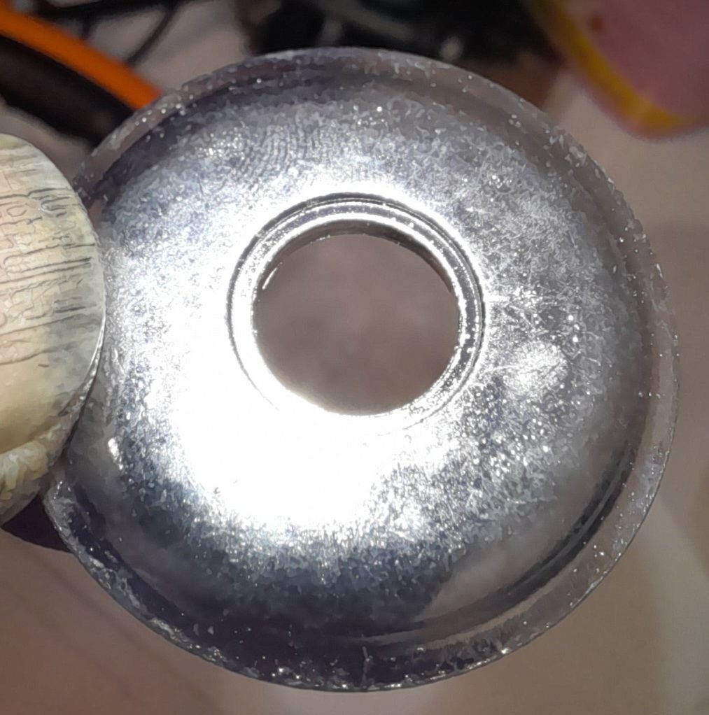

So, of the 3 washers. One has a chamfer machined in. This one.
See old instructions from Bilstien.
Please note that this chamfer is designed to hold the snap ring from spreading and sliding down the shaft. If the snap ring is captured in this grove it can not spread and thus slip. Like this.

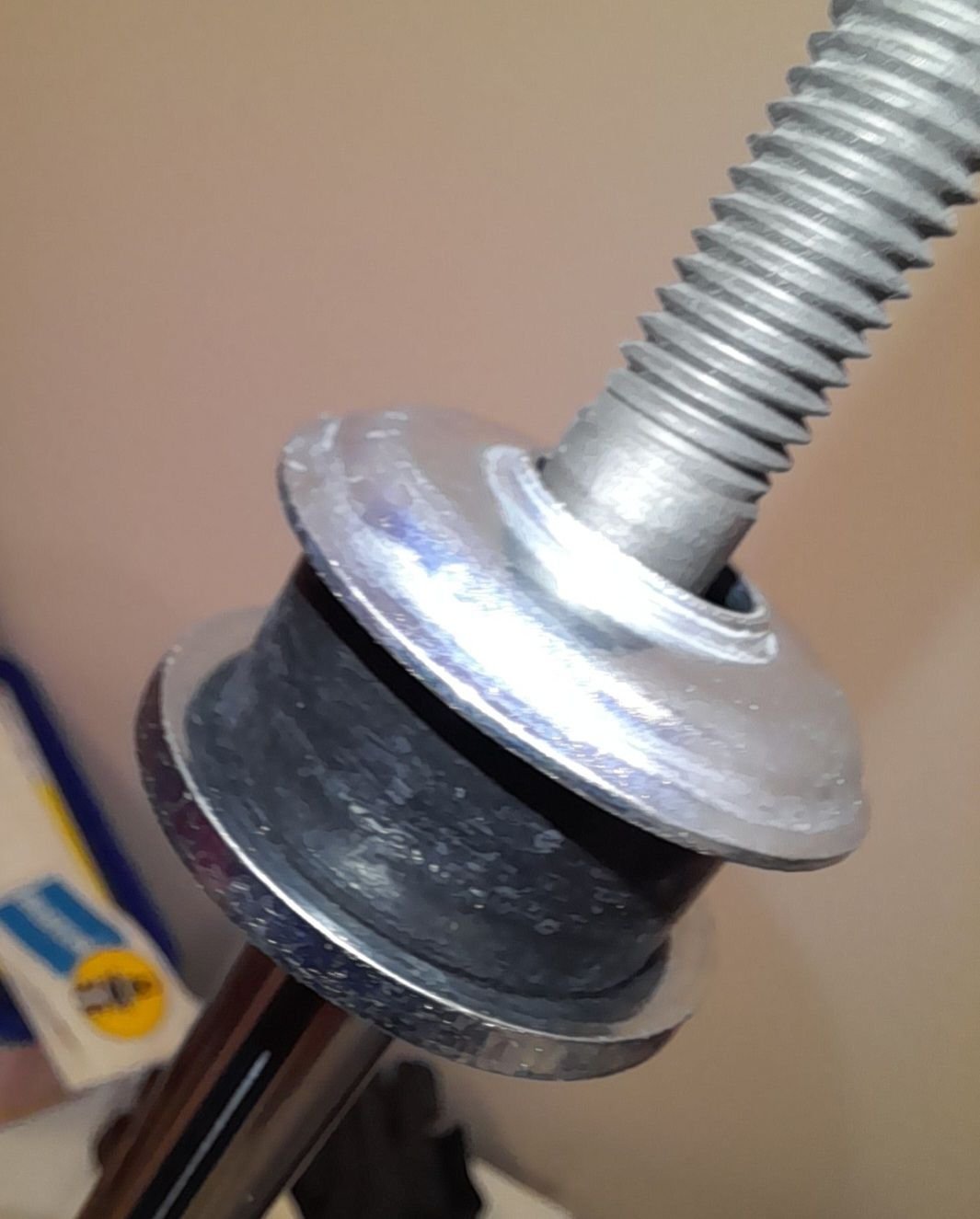

Next you install one of the rubber bushings and then the washer with the larger hole and the lip on it. Like this.

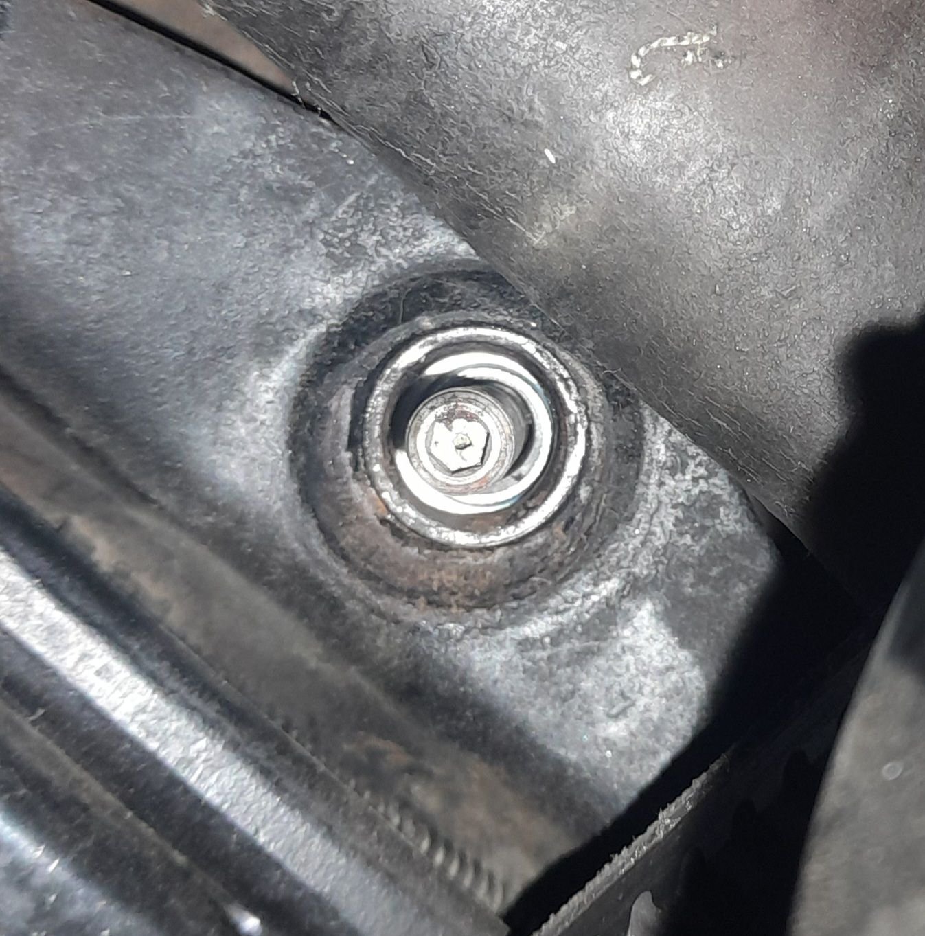

This washer with the lip helps center the shocks shaft in the frame tower hole. Like this.
Then on with the other rubber bushing and lastly the unfinished washer. And this of course is where all the confusion comes in. Why is it the only washer you actually see once everything is installed is not plated or painted? Doesn't make sense to those of us who want a good looking engine compartment.
But I assure you this is the correct assembly.
