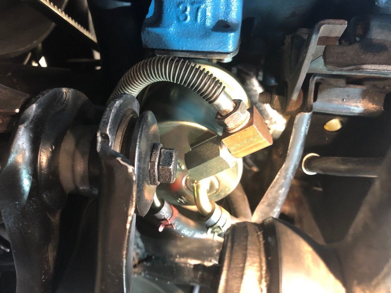

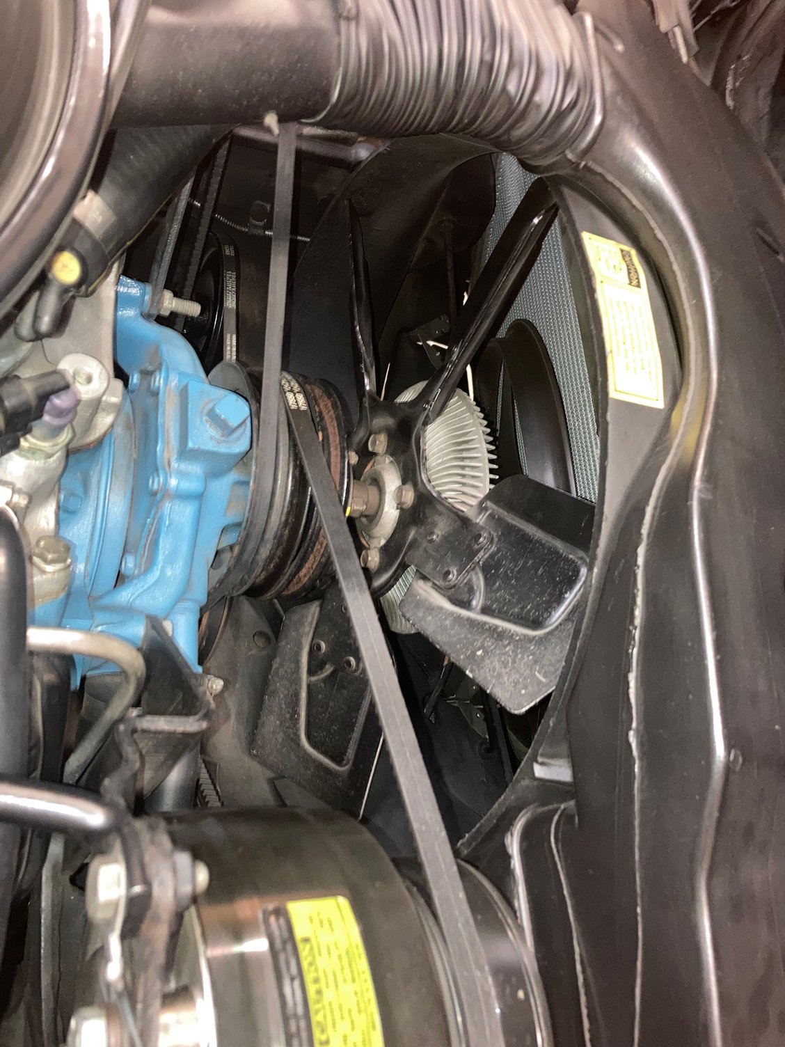

this help ? 79 L82 4 speed

Thank's alot interpon, I see the 90 degree fitting on the pump. Now I'm just gonna figure out how to get the line up to the carb. Still think I need to remove more stuff to get it in place.
I guess the line is under the heater and vacuum hoses?
yup
Old Jul 22, 2023 | 11:31 AM
7t9l82's Avatar
7t9l82
Joined: Oct 2010
Posts: 6,952
Likes: 858
From: melbourne florida
Slip it up from the bottom between the engine and behind the accessories. Might need to twist and turn etc.

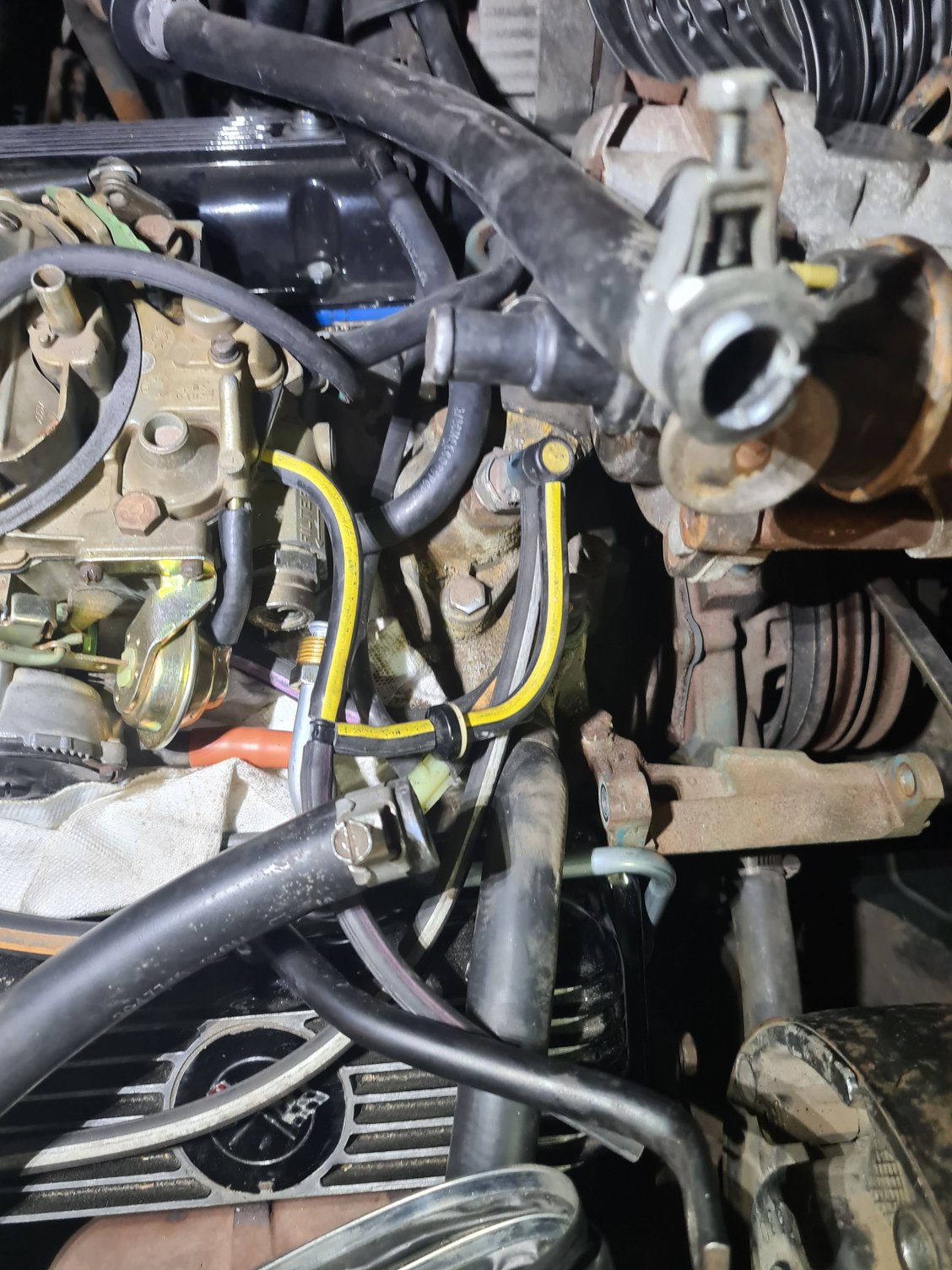

Old Jul 23, 2023 | 02:33 AM
redkenyan's Avatar
redkenyan
Joined: Jun 2017
Posts: 19
From: Helsingborg
Getting closer...
