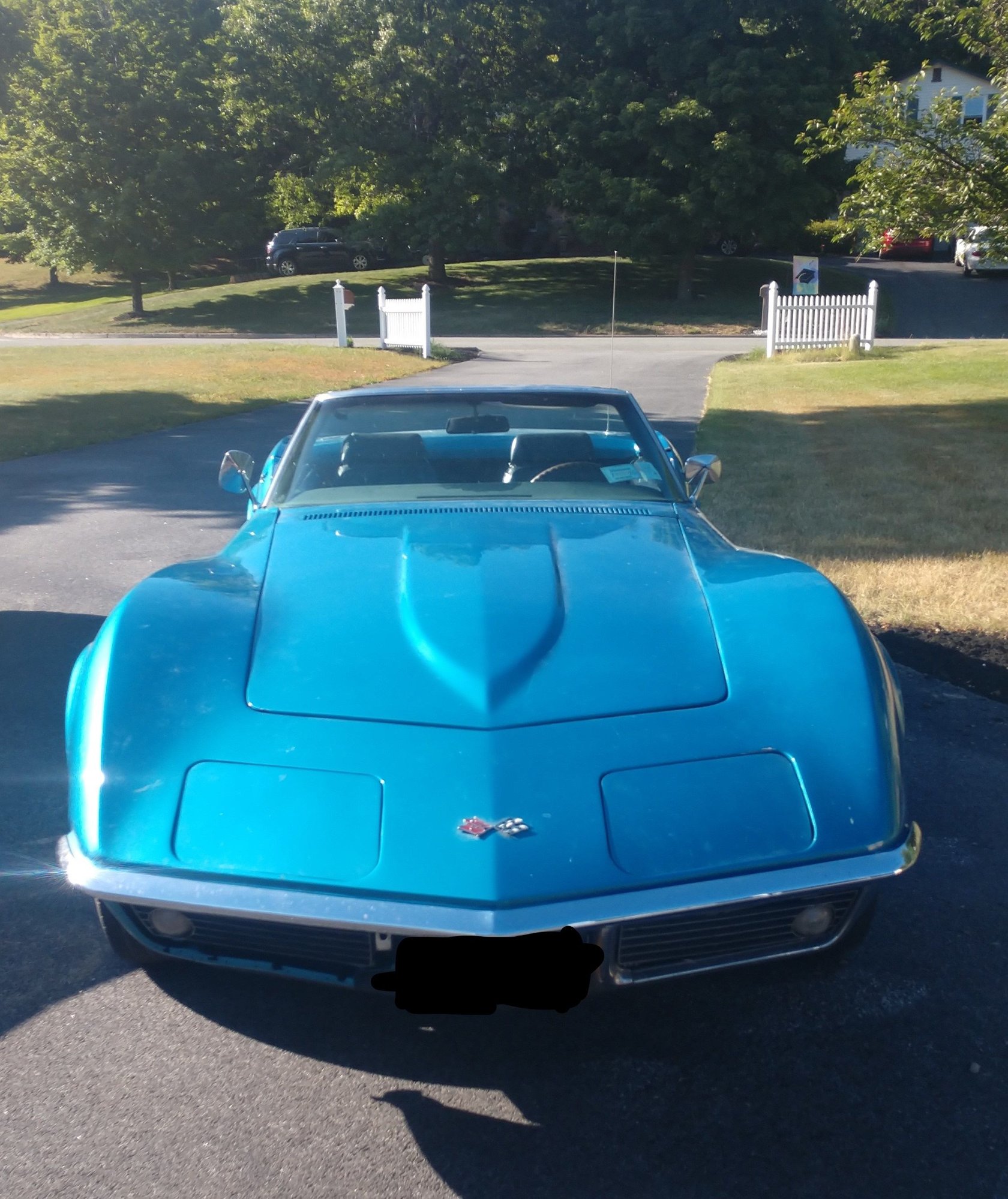

Hi all, I have a 1968 vette with Monroe shocks (30 years old) and its time for new ones. I have 460 lb springs up front and a fiberglass rear spring. The car is used for all around driving fun.
Any suggestions?
