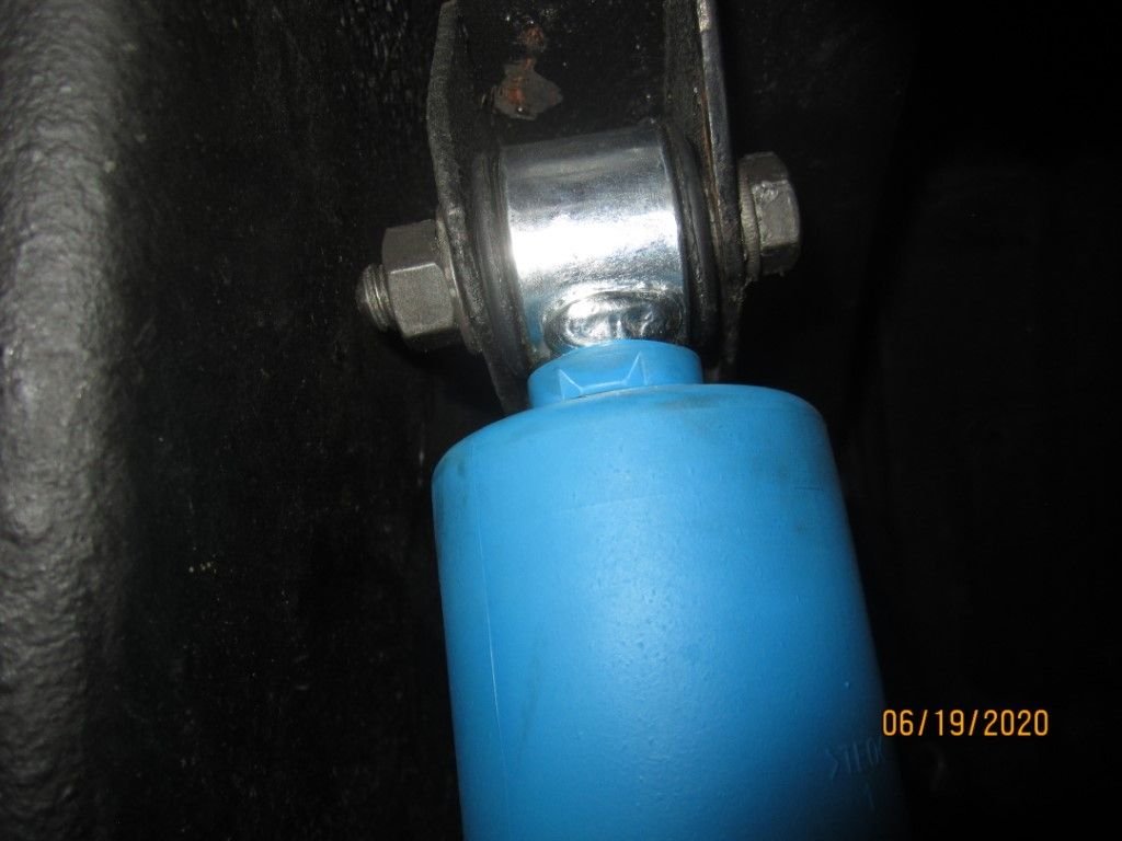

Picture is on a weird angle but everything should be 90 deg to the bolt holes
M
M
I agree. When I try to pull the bottom of the shock towards me to get it aligned, it hits a part of the car below and will only go so far. Crazy!!! We will keep trying in the morning. Thanks!
