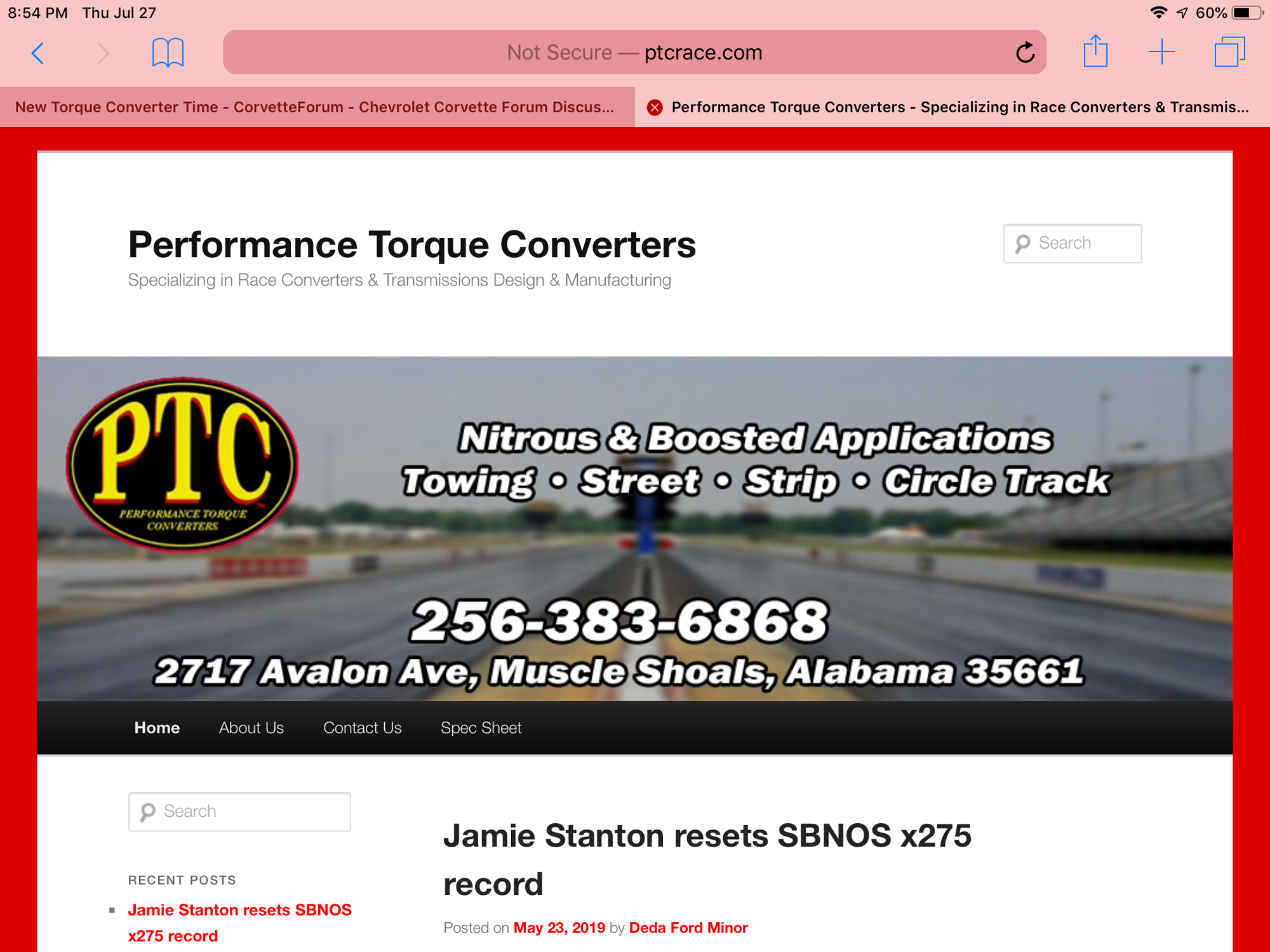

I’d contact PTC with all your information and ask for their recommendations. Great product and service from my personal experience.
shaved a second off my 1/4 mile ET in this off topic street car
