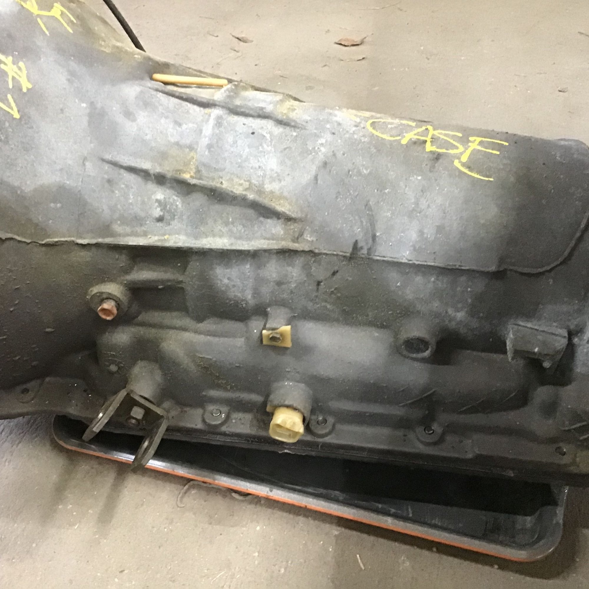

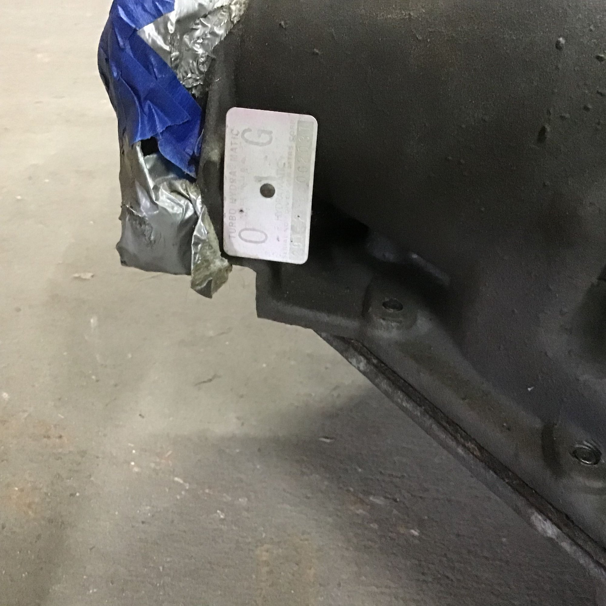

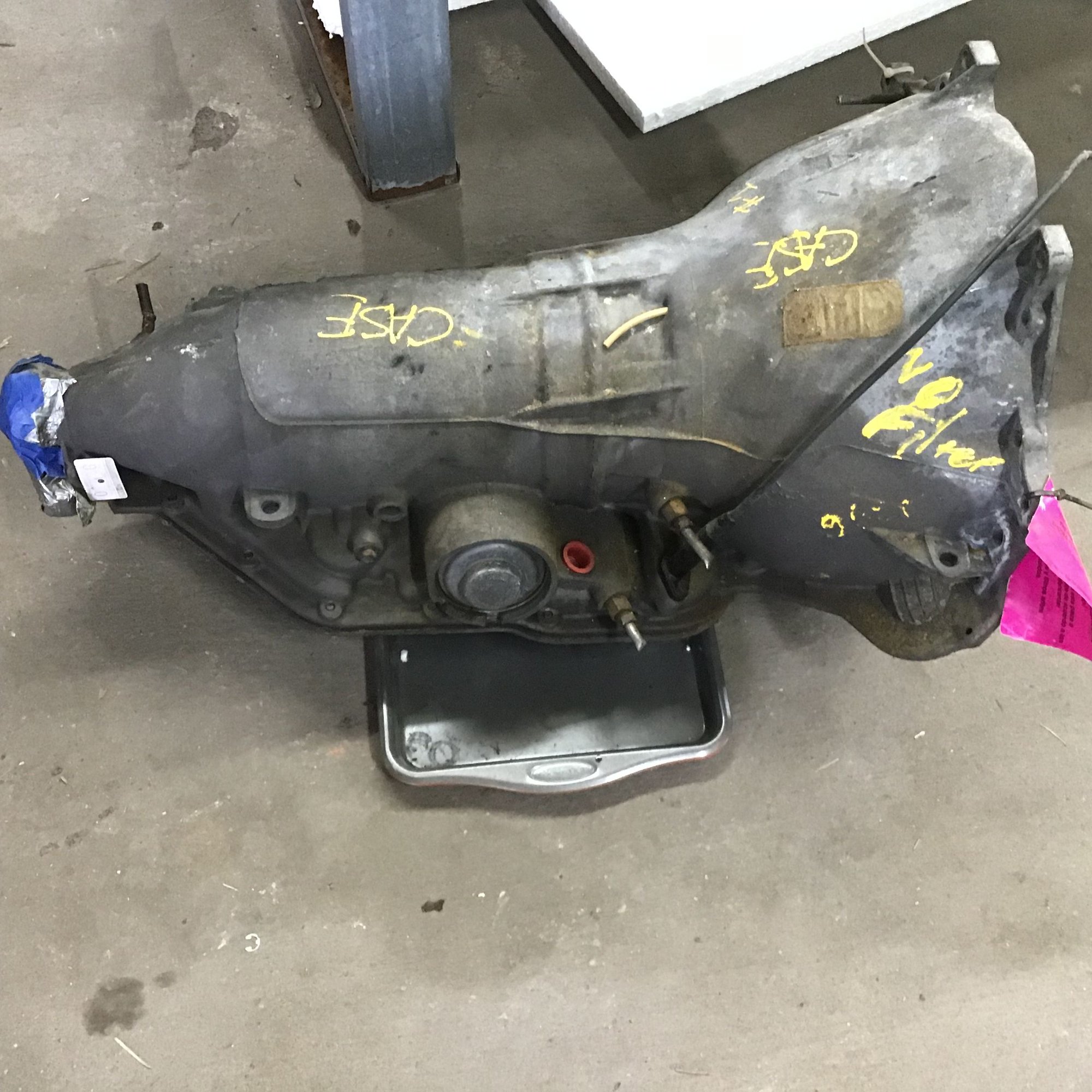

I picked up a tranny a year ago,and now ready to try and rebuild this one,with some help of course,never messed with tranny before other than putting one in.
It has OG on tag,only need to be for less than 350 hp. It seems to be a good core to start with.

these are some id’s. I have a CZF in my 79
​​​​​​BRF 1986-1987 Grand National, Turbo T, T-typeBQ 1984-1985 Grand National, T-type
BR 1983 T-type
CZF 1985-1988 Chevrolet Monte Carlo SS
CRF 1985-1988 Monte Carlo 305 engine LG4
KZF Oldsmobile 442/Hurst
OZ 1983-1984 Hurst Olds
OM Oldsmobile 350 Diesel Engines
OG Oldsmobile 307 Engines
BY 252 V6 cars
AA Cadillac
AP Cadillac
Old Jul 26, 2023 | 07:58 AM

If that is in fact a 307 Cutlass trans......I don't believe it has the Chevy bolt pattern......it has the BOP bolt pattern.
EDIT: Looking again....it appears it has both......

I built my own 200 4r many years ago, I question those case markings shown above. wonder if the case is good, but beyond that, the source here in Jax Fl. region for hotrod/HD parts was reasonable in cost the entire project only ran about 400 bux, but of course I did all the work and followed rebuild manuals and mods done according to some parts supplier who knew their **** really well........the trans has been a good one so far....336 rear ratio so 80 mph is about 2500 rpm....not so awful evil.....my car had a 4 speed stick in it, and the trans bolted in no sweat, same driveshaft, cross piece had to be cut on each end leaving aoubt 3-4 inches tied to the frame rails on each side, and the cross piece is highly modified so it's removable with just 4 large bolts, and the exhaust pipe holes were opened on the bottom, and reinforced up top for the obvious strength, so it drops the exhaust pipes about 2 inches down at that spot, so what??? I can drop the entire dual exhaust with crossover pipes clean as a whistle, no sweat.....GOD, I"m lazy.....
