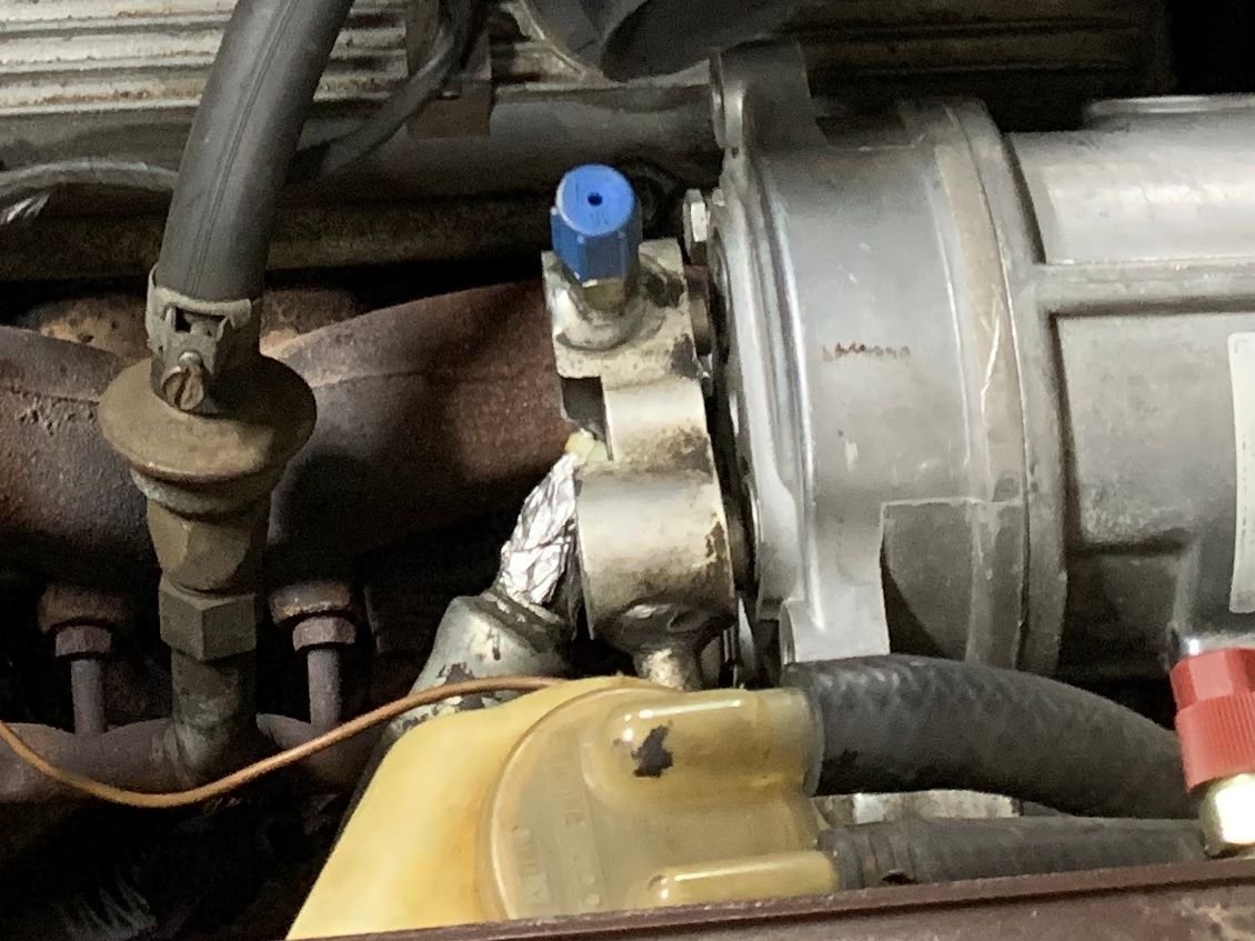

1974 L82 original unmolested AC car. I believe the AC system is complete. Does this look like an original compressor? PO informed me there was ‘an explosion’ and one of the hoses blew off the rear compressor hose mounting block (see it wrapped in foil). This is how I purchased the car. No idea why the mounting bolt was removed.

compressor doesn't look OE
find the blockage that blew hose
do you know what gas is in/was in it?
r-12 has small shrader fittings
134 has big shrader fittings.
I don't know what type "expansion" system on 74?

That is not the original GM compressor. It looks like it could be a Sanden which would be a working replacement.

and now that I look close.
those are 134 fittings.
maybe the valving has been upgraded?
a Parallel flow condenser is needed.

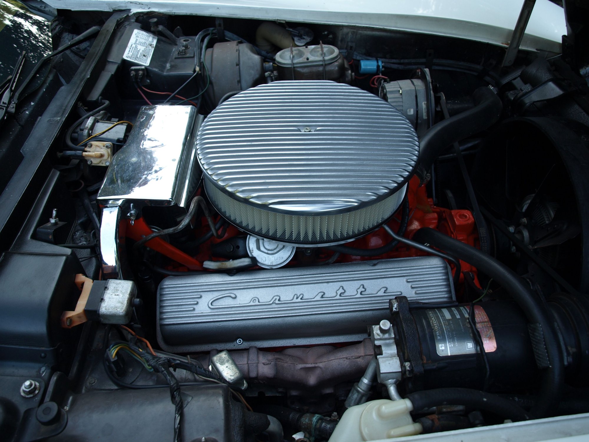

Here's the A/C unit on my '74.
Looks different from yours.

First off you already have a factory AC car so there is no value in an add-on Vintage Air System. Second, the PO or someone before him removed the factory GM A6 compressor and converted the system from R-12 to R-134 freon. I'm going to assume during this upgrade the original VIR was replaced with a VIR Eliminator and the current AC pump that is on the car.
If this was my car I would not trust anything the PO said on the subject considering he is using words like explosion and you have a missing pump manifold attaching bolt. I would first re-attach the manifold (use new o-rings) and pull a vacuum to verify if in fact you have a burst hose unless a visual inspection shows a burst hose.

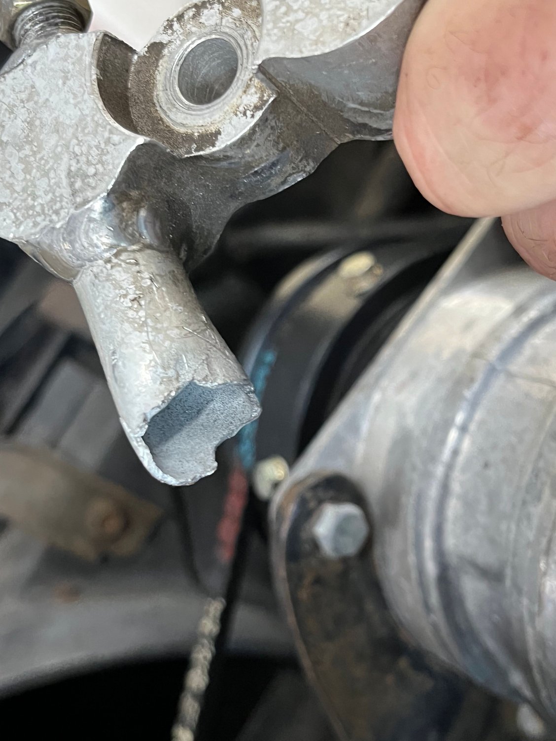

I was not clear and I understand the skepticism with the word ‘explosion’. The PO simply said, “while cruising with the AC on there was an explosion and a vapor cloud…..” I have attached additional photos of the hose he claimed blew off. It was wrapped in foil and a zip tie when I bought the car. No attempt was made to cover the compressor side of the open hose - and as mentioned the bolt holding the hose block onto the compressor was removed. All strange indeed.

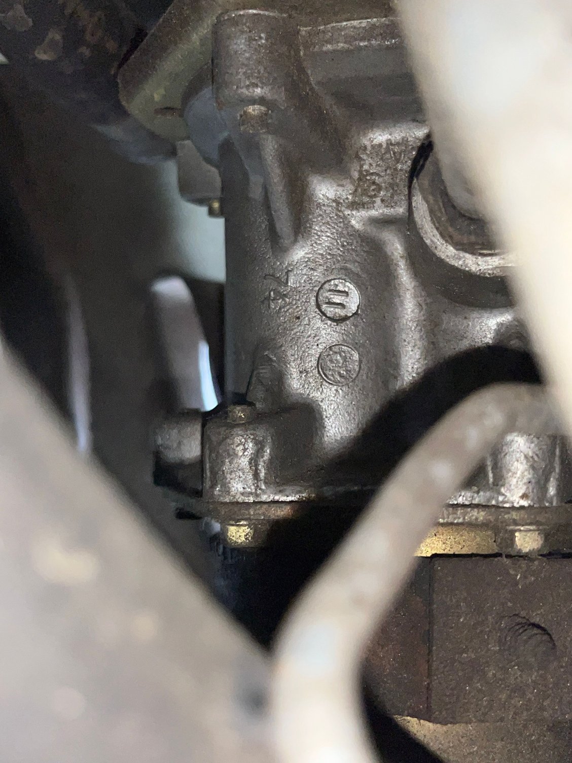

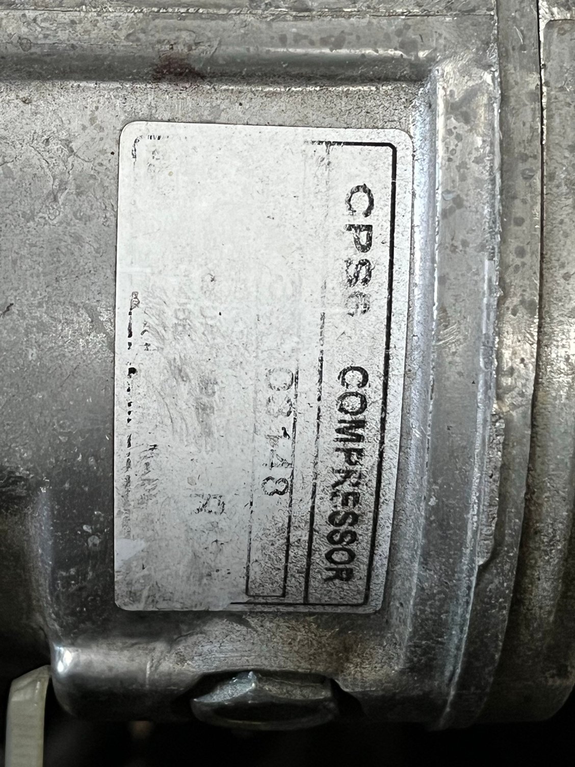

Thanks to folks responses; I now know my compressor is not original. Looking closer at the tag I think I can make out R134. I have also attached photos of a device down inside the fender that is certainly not original. Is this an older style VIR eliminator?

You have an aftermarket R-134 AC pump and the original R-12 VIR and what looks like the original hose that is unserviceable. If you are not concerned with having an OEM R-12 system, the least expensive path is to go with a R-134 conversion. The link I provided in post # 6 from Spot Rot is a good example of the parts you will need.
Wild card is the condition of the evaporator and condenser based on this "explosion". What would I do if this were my car, buy a new hose and O-Rings and pull a vacuum on the system and if it held, I would flush the evaporator, condenser and hoses and install the parts that Spot Rot used to upgrade his system. You should be all in for less than $1K doing the work yourself, if you out source it to an AC shop expect to pay $3-4K.
