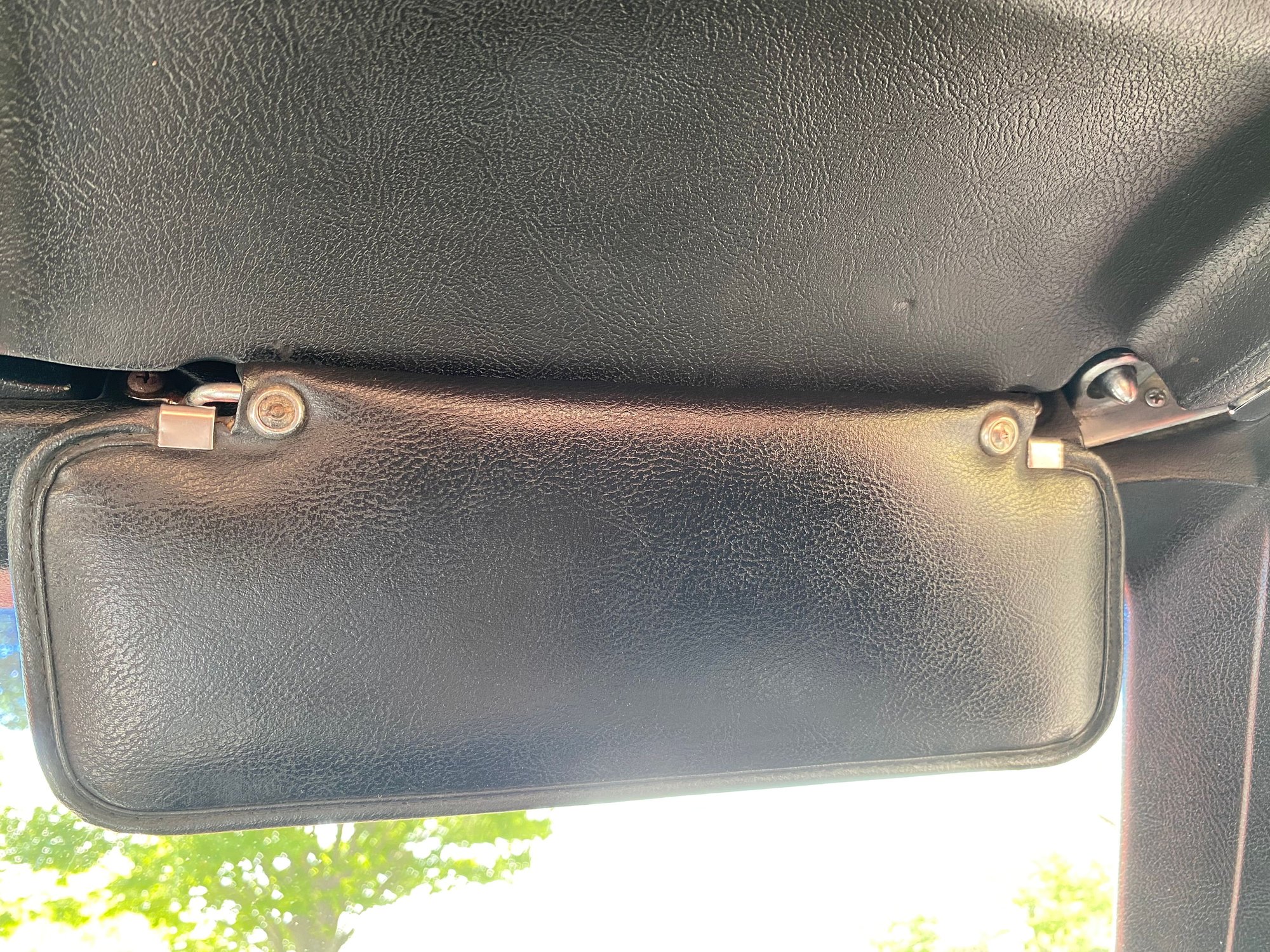

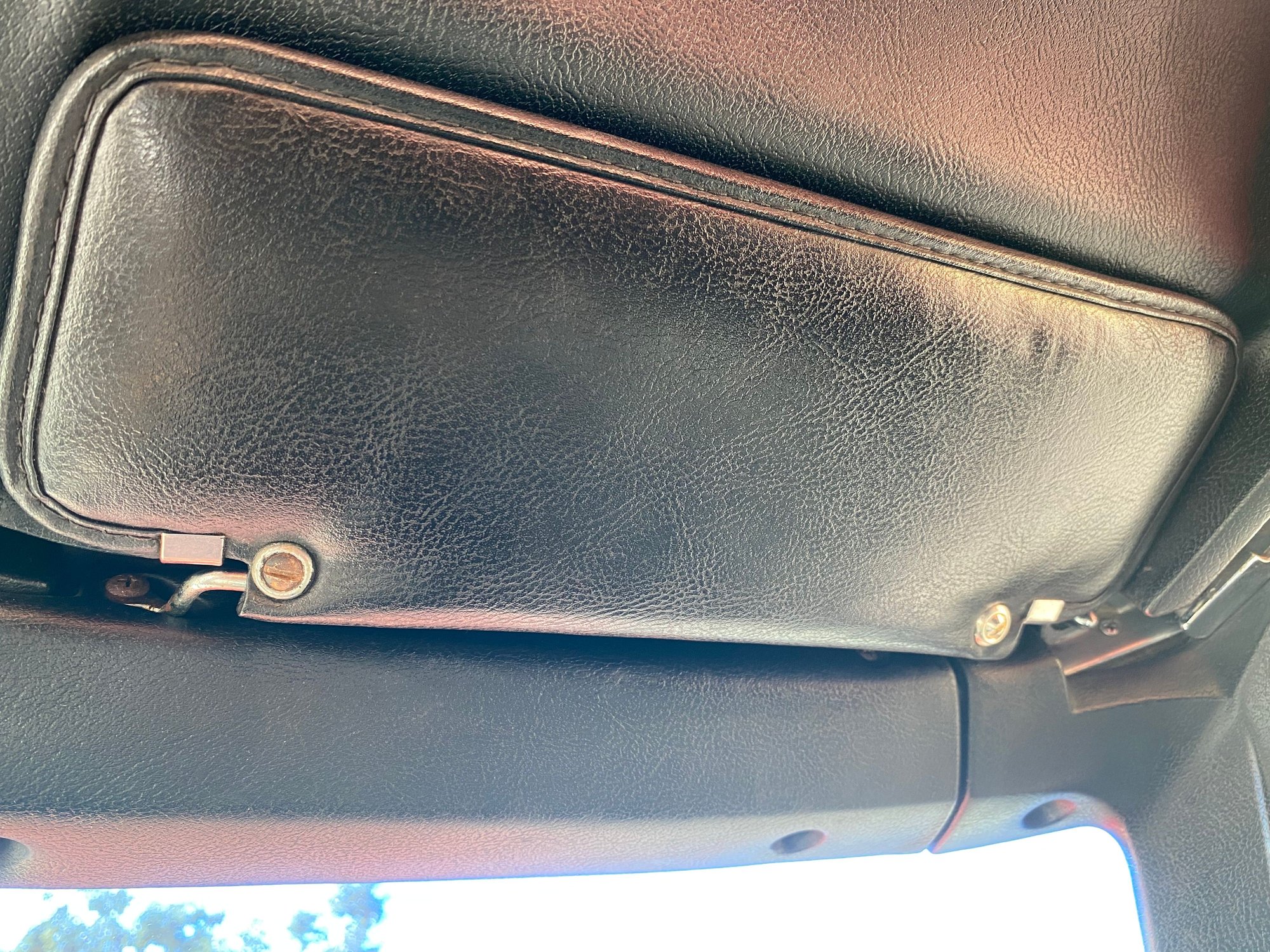

Is there a tool for these screws? I was able to remove one from each visor. The remaining 2 won’t budge.

Some vendors sell a tool to remove them, but it's really just a flat screw driver with a slot cut in the middle of the blade. I made my own years ago from an old screw driver I clamped in a vise and cut a notch in.

I thought to do that…I have never seen a setup like that. I couldn’t imagine there was a stand alone tool for such a unique nut and screw.
I will grind one tomorrow.
