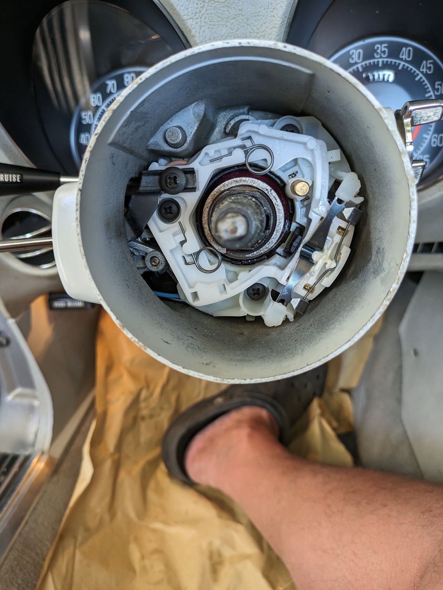

1977 Corvette w new turn signal and wiring installed
Just bought this Corvette and the previous owner said the turn signal did not work, but he bought the parts and gave them to me. I installed the new (used) turn signal lever with the associated steering column side switch. One wire was broken so I bought a new terminal connector and reattached. I also installed the new turn signal switch with the new wiring terminating in the harmonica connector. I re-assembled the steering column up to the steering wheel. When I went to reconnect the battery the horn turned on and would not shut off. So I pulled out the horn relay and started to disassemble the steering column again. Every time I removed a part, I would plug in the horn relay to isolated the problem. However if you look at the attached pic, I got down this far and the horn is still blaring when I install the relay. Does anyone know what may be causing my issue? I would like some hints before I take more parts out. Thank you.

Did you disconnect the turn signal switch connector? Was that wire you repaired a black wire?

yes, I disconnected it. I can't recall which wire I repaired. (should have taken a pic). Only one wire was disconnected from it's terminal, so I bought a new terminal connector and reconnected. Since it was only one wire, I am sure it is in the correct place. Definitely open to more suggestions. Thanks.

So with the T/S connector disconnected the horn relay is still active?

Did you test that the relay is good?

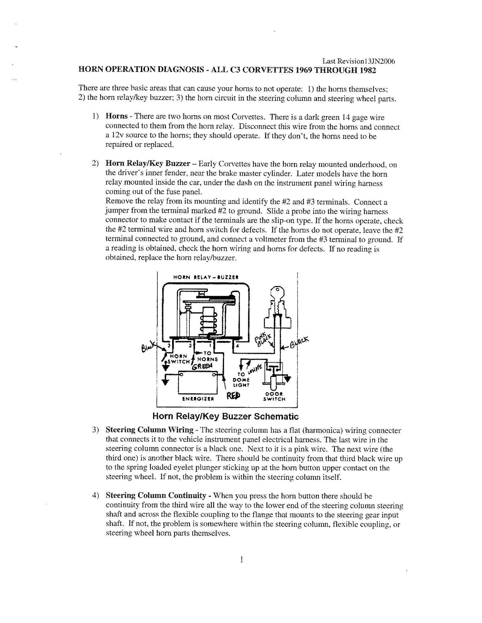

Default Might be the same for your '72
Here's another 'How-to':
To Horn continuously on
