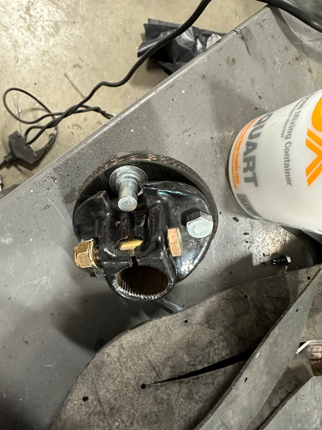

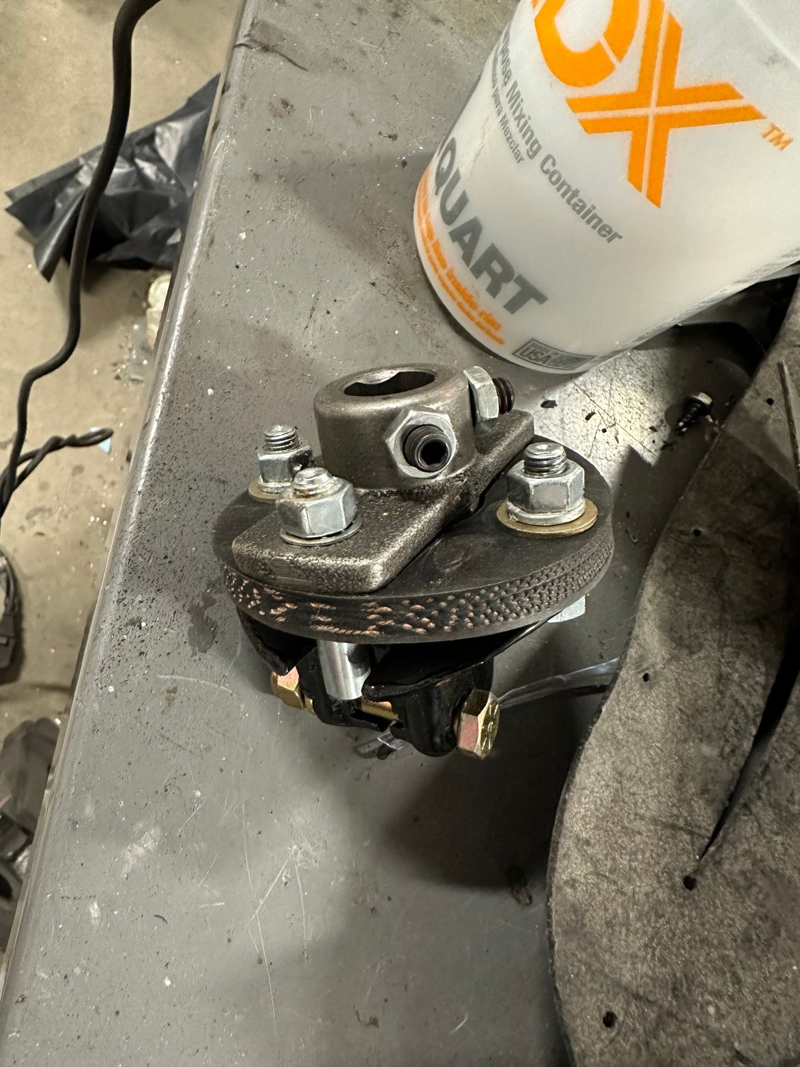

Pictures of the top stick rag joint mounted to the Borgeson bottom. If you are interested.
