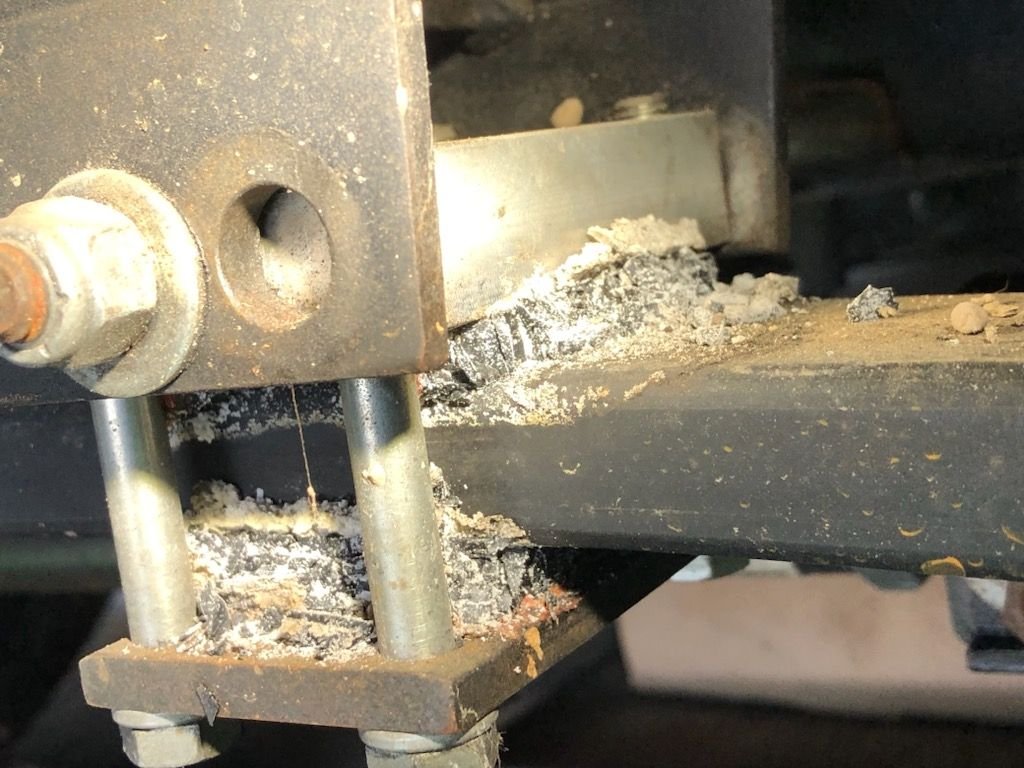

My VB&P dual mount spring cushions both front & rear have also crumbled. will be making new pieces out of Delrin as soon as I get the car on the lift.
Van Steel has stepped in for replacement pieces for this for those who don't have access to machines to fabricate themselves.
