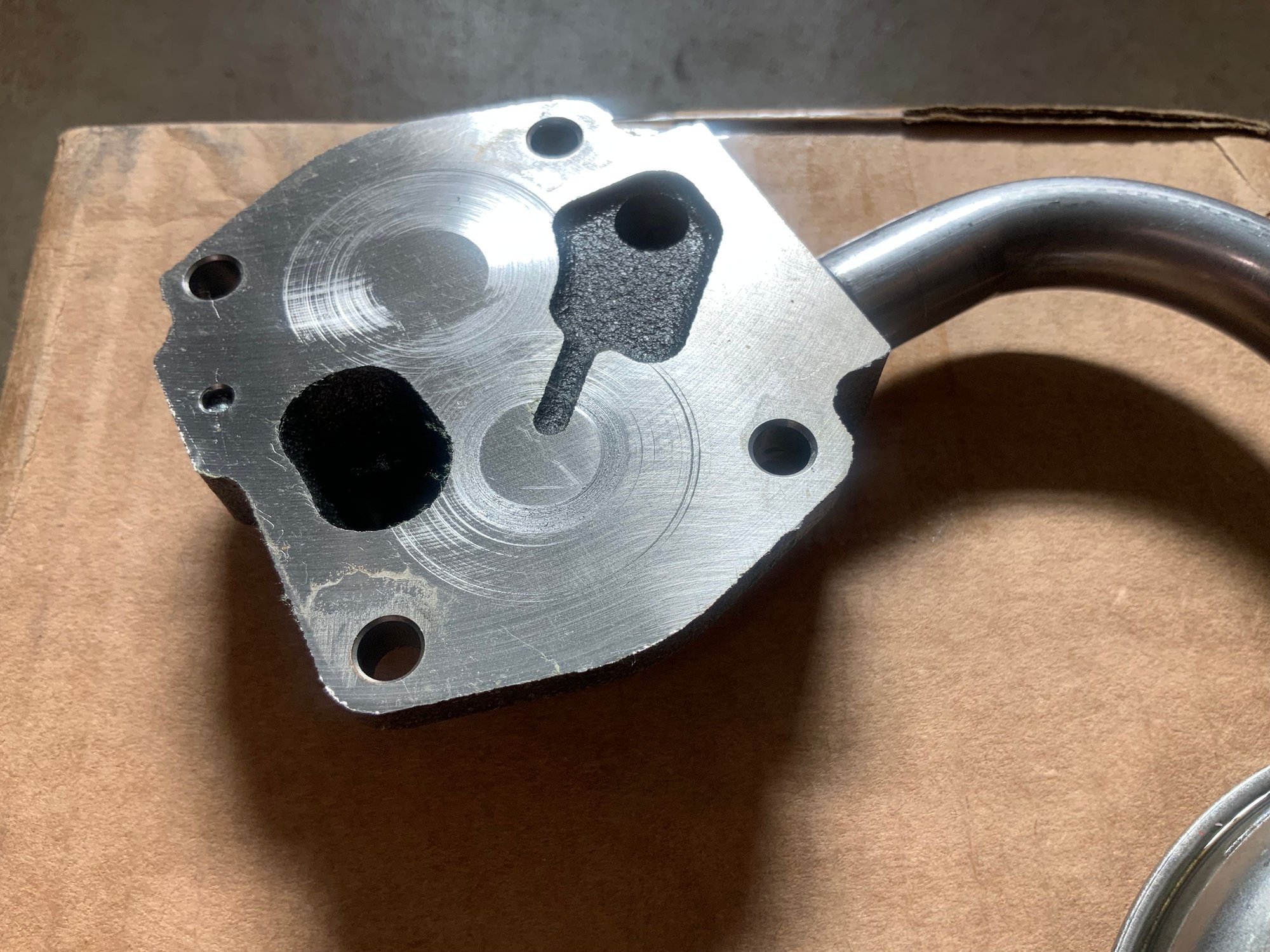

I took my oil pump apart and found this wear, it’s the gear that the distributor drives. Could it be that the distributor sits to low.

No....if it was too far down.....it would look far worse than that......that gear got dry....for a short period of time.....notice how it is only scored toward the center where the gear is solid.....no residual to drip down form the gear teeth.....most likely it got aerated......
Is the pickup fully brazed to the pump all the way around? Is it a very tight press fit?

Great explanation Jebby, what would you recommend in preparing a new oil pump? I’ve read, checking end play and through cleaning.

It's a little bit like the "chicken or the egg" argument, did foreign particulate enter the pumping cavity and cause damage, or did the damage taking place create the particulate that caused greater damage? Dry does seem reasonable, but I'd be more inclined to believe possibly a simple case of an initial dry start-up occurrence, as once there is oil in the pump some aeration isn't so great an issue for that of consideration here. Always be sure to prime the oil system before first start-ups or in instances where the engine hasn't been operational for some period.
We always disassemble, even "new" pumps and inspect them for cleanliness, end-play sum and squareness, rotor to housing clearance, shaft bores, casting flash, etc, and freedom in rotation, including just possible handling damages, this often involving some sort of reworking before being installed.
And yeah, just replace it.
