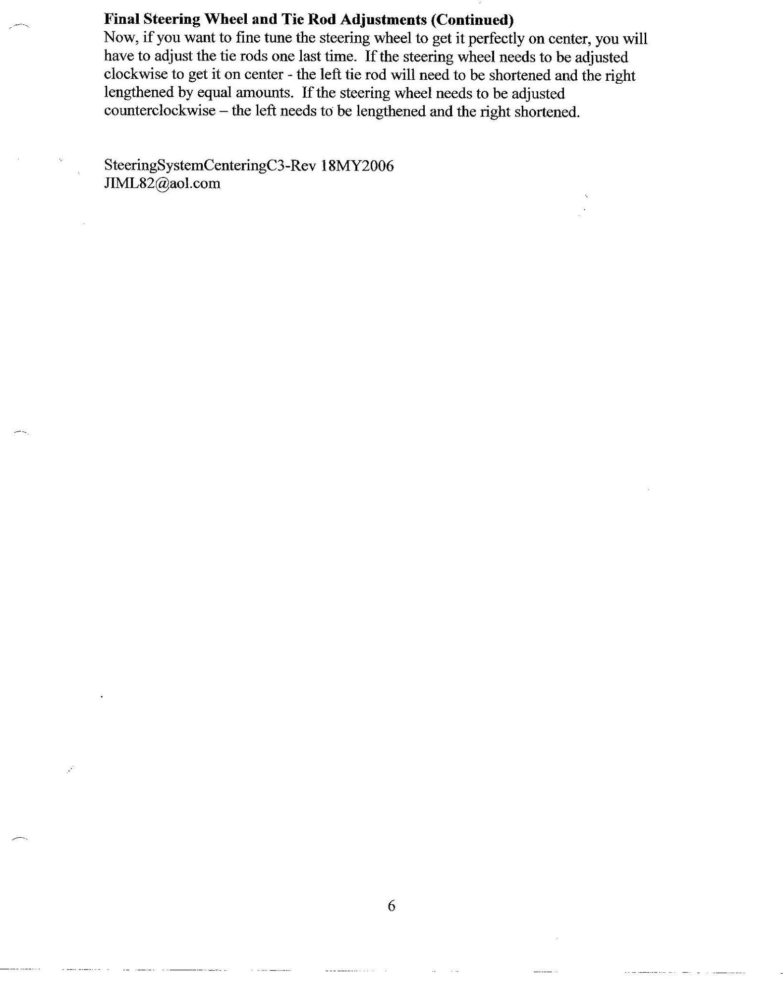

When I drive my Vette I have to hold my wheel in the 2 o'clock position to keep car straight. This makes my turn signals hard to use. I searched and read other threads but I am a bit confused.
If my wheel is at the two oclock position while my stop pin is at 12 o'clock wouldn't adjusting my tie rods make the stop pin move out of the 12 o'clock position? Or do I not need to worry about that? I'm also assuming my alignment is way out of wack as the car feels darty. It drives straight until is doesn't lol. I might try the string method but wanted to make sure wheel was centered and correct before getting crazy adjusting toe. I did not pull wheel cap and check detent to make sure no one had moved the wheel before me.

That PIN will stay where it is, try adjusting as per Jim Shea's instructions:

Excellent! I do have his PDF. This should be pretty easy then. I thought if I adjusted tie rods it would move out to 12 pos.
