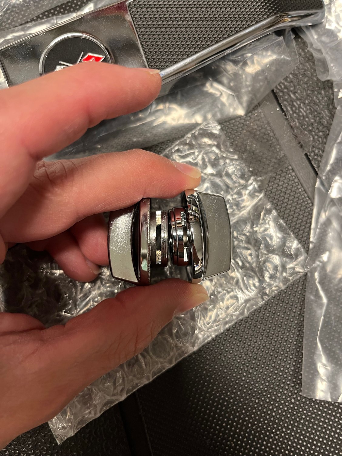

Aftermarket door panel and repro ****, here a photo between the original **** and the repro ****.
Look to the slot, they aren't at the identical position. (left: OEM, right: repro)

Where the locking pin is inserted doesn’t matter. The same for the manual window handle. Even after putting on the plastic round washer, the **** is still loose and not a tight fit. The **** only goon ONE WAY. Try to put the **** on without the clip.

The problem is also the repro door panel. The fit is not the same, I must push the panel harder backwards so that the **** has a grip. That the slot is even further forward has a further influence on the assembly, you have to press the button even more in that it is far enough to insert the clip. That the **** only goes on one way is clear and you can see it.
