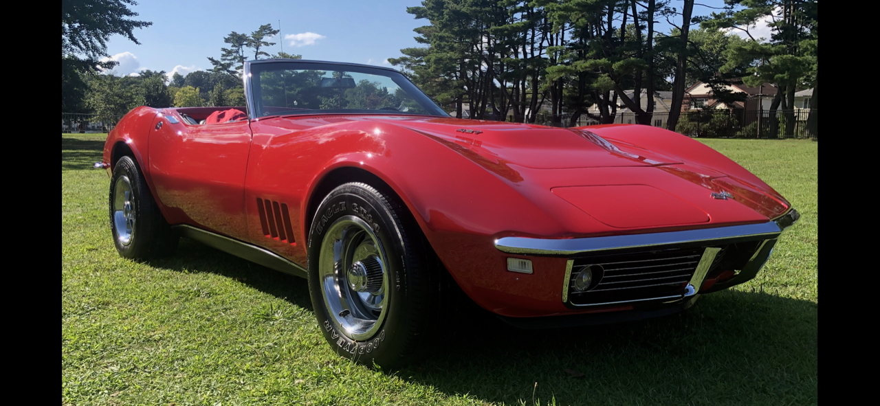

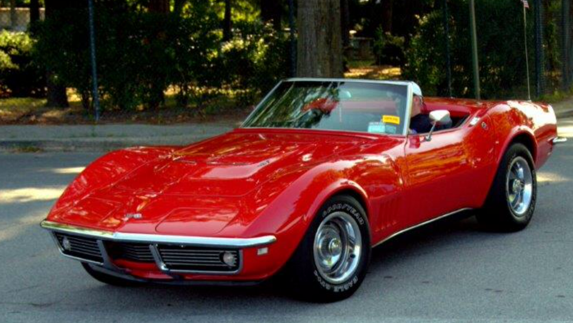

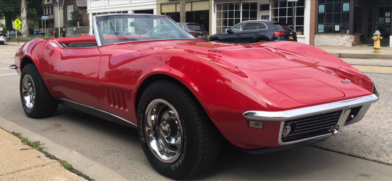

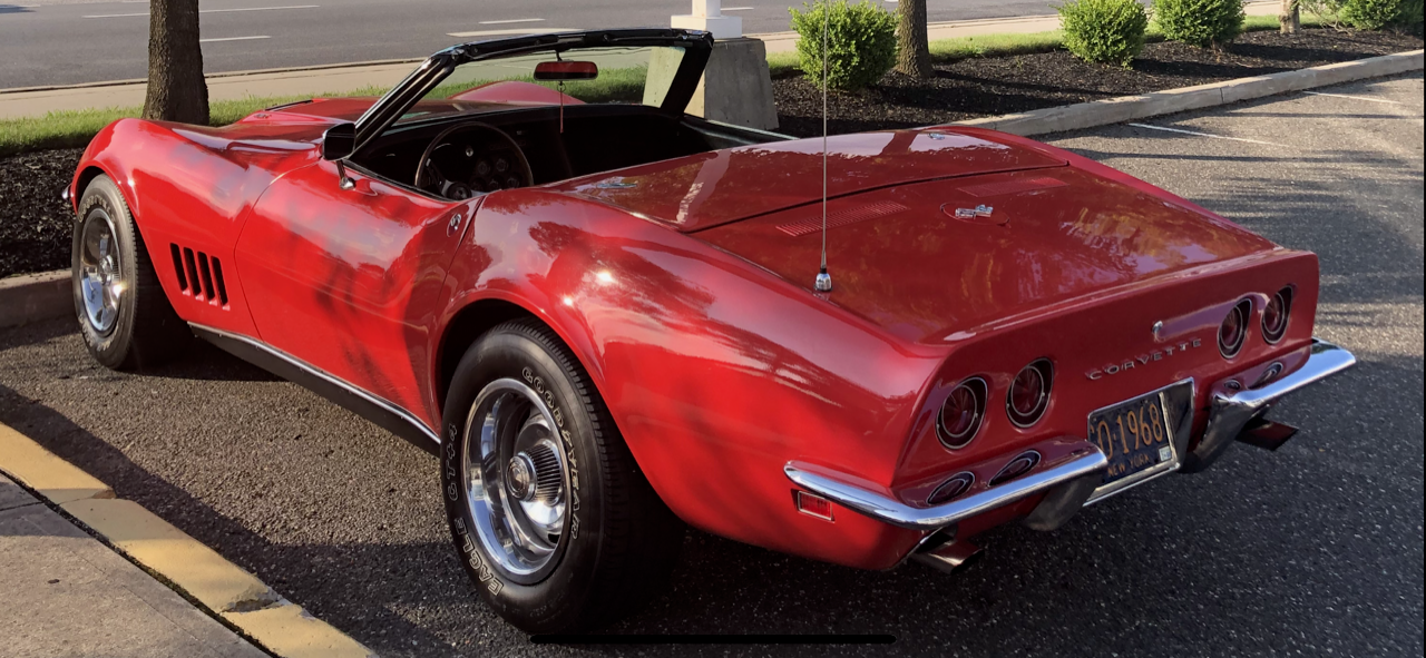

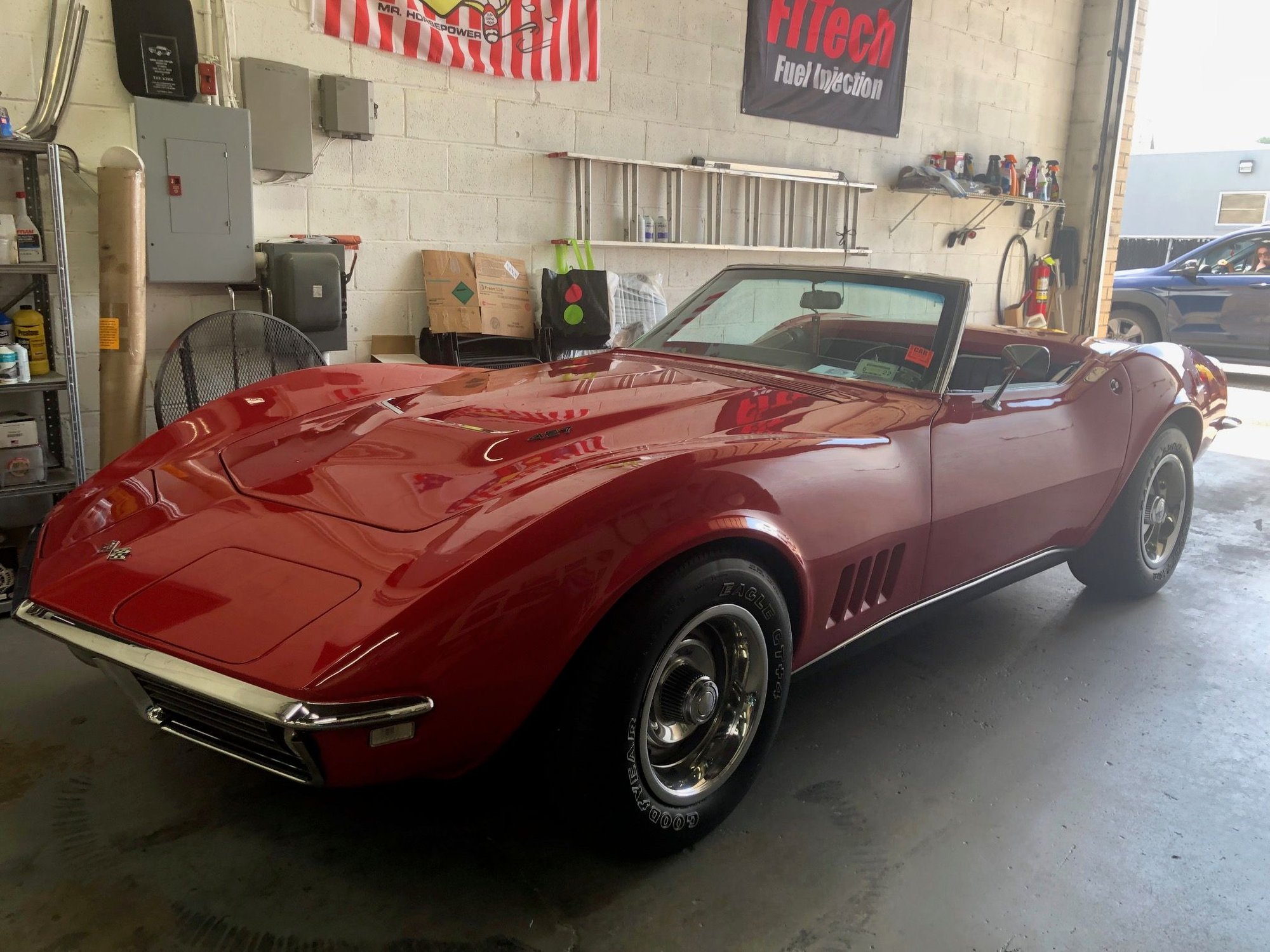

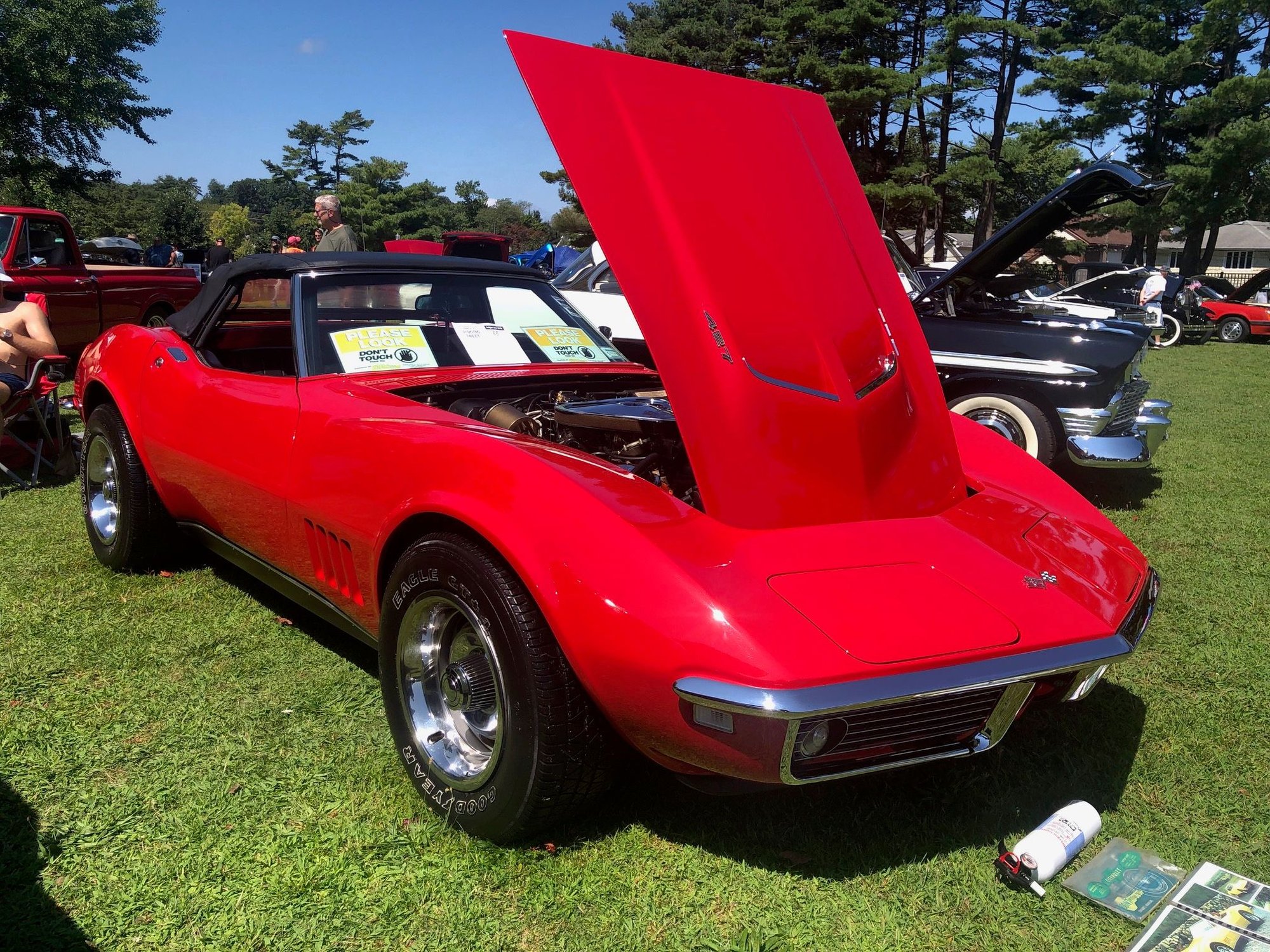

This is 100% incorrect. A good painter experienced with Corvettes, paint & fiberglass can match blowing a nose ( no pun ) into the doors making it perfect or nearly impossible to tell. I Had it done on my car. Entire nose, hood etc & blown midway into both doors. The best of the best can't see it even when i point it out. This was done about 10 years ago, and the older paint was 25+ yrs old at the time ( CAN'T TELL ) !!!
All depends on who is holding the gun SEE BELOW: .
Note: the color has alot to do with the quality of the blend, Glad yours turned out great
I have never seen a good blended silver for example, And I would blend Black every time
