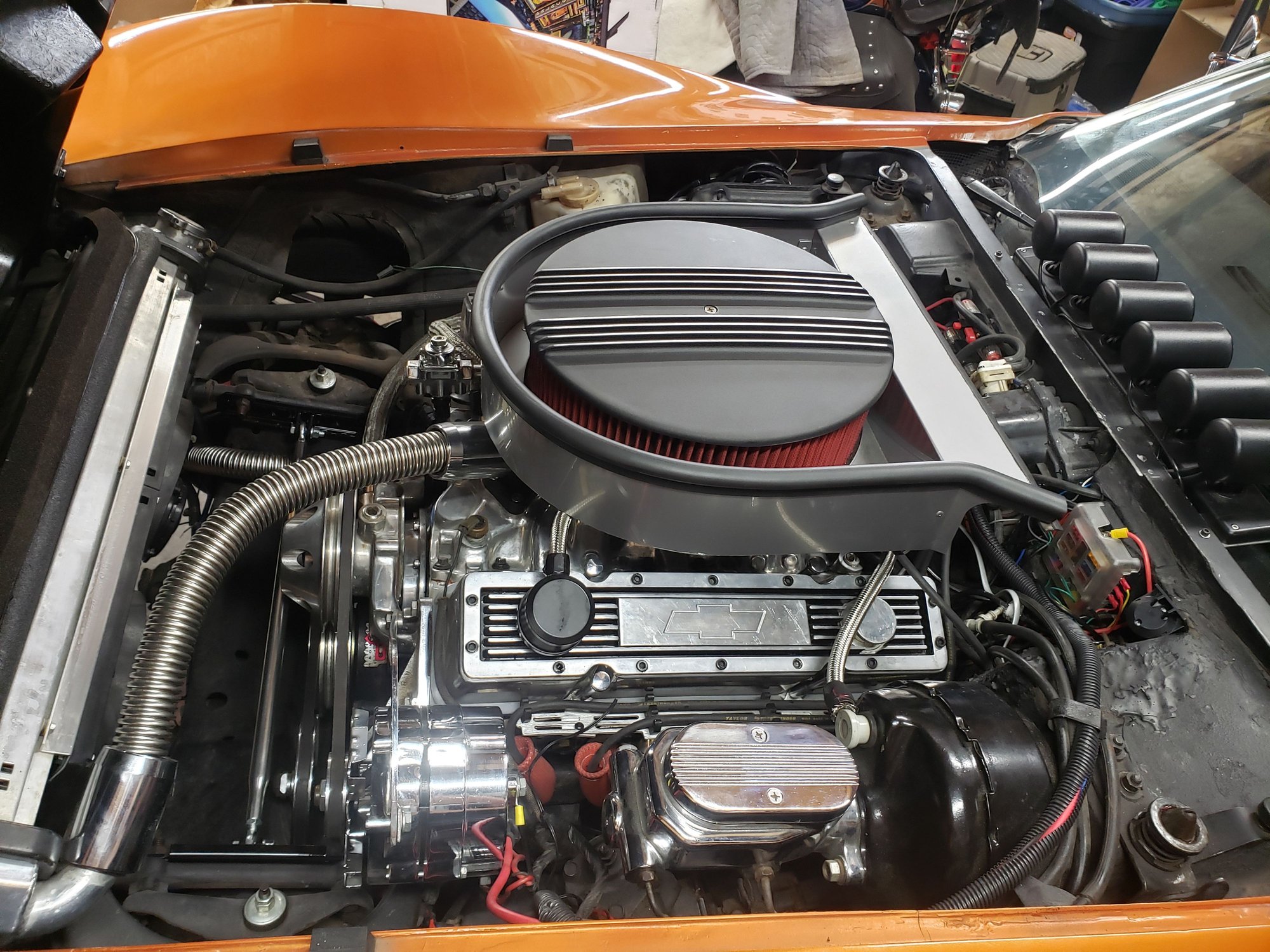

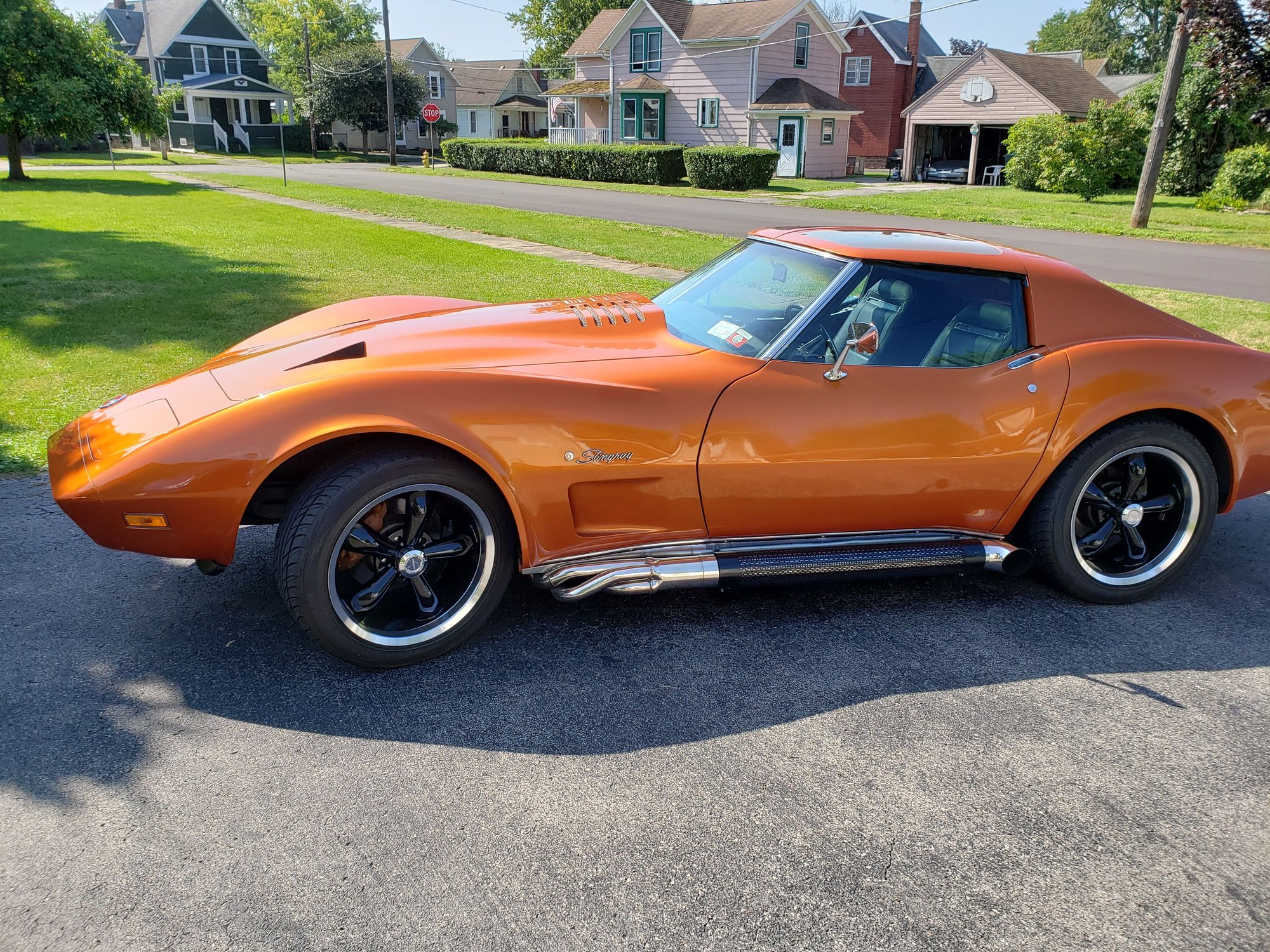

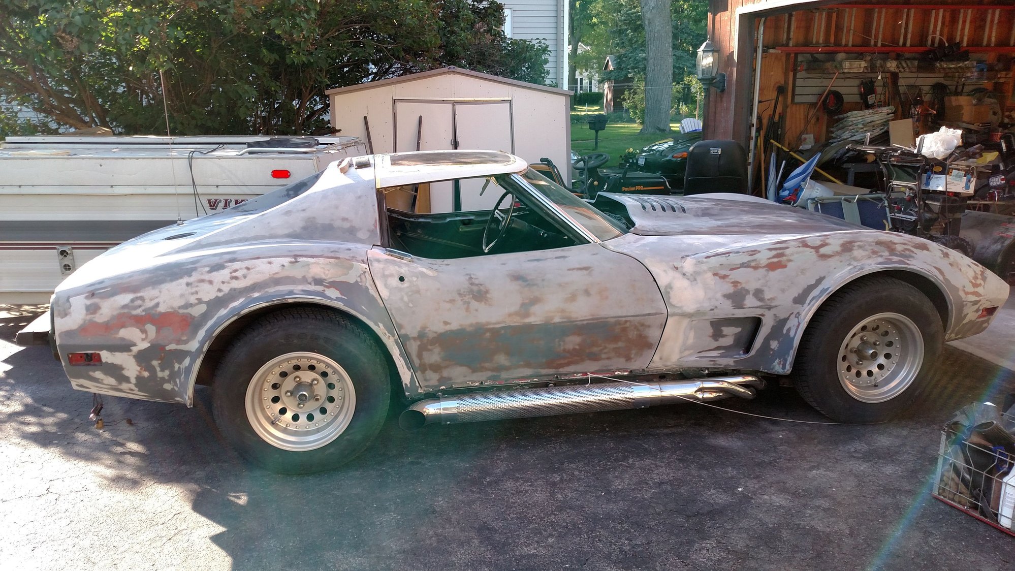

I'll be the devils advocate here and chime in with my own experience and opinion to say im happy with my 74 I bought for $2,900 in bad need of not only body and paint work but interior and engine work I had never built and engine or done interior work and youtube is where I learned to do it all as well as forums like this. I also used youtube extensively to learn to paint the car.. It was under $1000 (one thousand) for me to do my own body and paint work and that included the used compressor and paint gun from harbor freight, so lots of ways to skin a cat. It all depends on a persons situation and mindset as well as ability to learn the skills And my cheap chinese casting heads outperform the dart heads I replaced with them... I could have bought the AFR enforcers as they were in my budget... But those are literally the same chinese castings with different machine work. The truth is a large portion of parts including restoration interior parts come from china now so rather than pretend thats not the case by buying the chinese stuff through american middlemen brands I just accept it and research what I buy first. btw this car as pictured was under 15 grand start to finish up until I chose to do additional mods like the roller cam, $700 heads, 2004r overdrive trans, borgeson steering. 3.55 rear tubular a arms composite spring and coil overs all of which were more recent changes many of which havent been added to the car. with all that I likely have closer to 20k wrapped up into the car now but its been a fun enjoyable hobby learning how to work on cars in the process and theres just something about doing it yourself that gives you a feeling you cant buy..
BTW I had the l48 I pulled and replaced with a 355 I built myself on a budget of $1200.. no complaints. Of course I made upgrades over the years to it. If I had an l82 I may have tried to rebuild it but I got a great deal on a freshly machined block.
this is with the $300 craigslist dart heads and rocker I replaced with aluminum this summer. I used steel shim gaskets with 4 relief flat tops for 10 :1 compression and a .041 quench (i did not use that oil pan)
after stripping with razer blade
I used 3 different primers polyester filler primer, epoxy sealer primer and urethane primer before the pearl basecoat.
