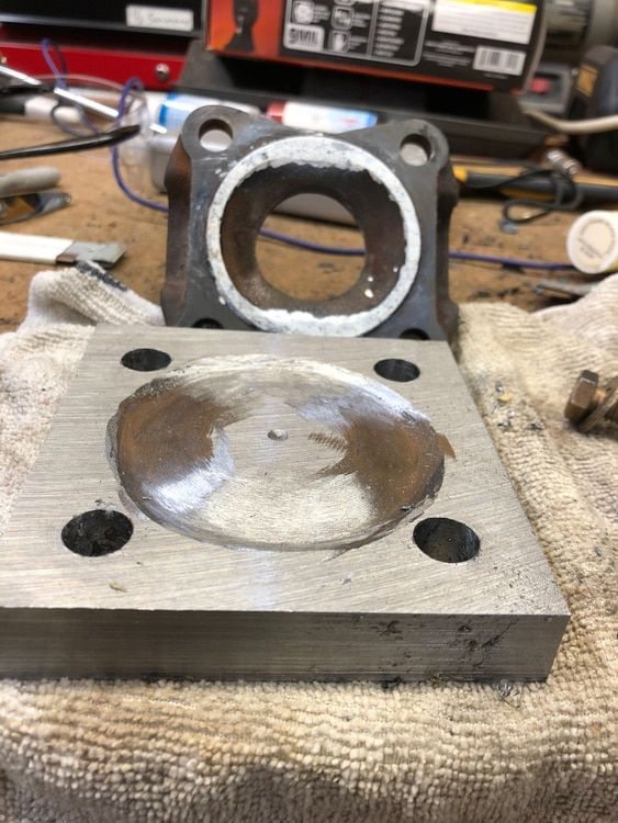

So i bent my flange last week as I wasn't aware that you have to have it bolted to prevent bending. I have a new one on order will arrive tomorrow. However, non of the vendors have this plate in stock. I even thought by time I bought the plate and U joints I could buy the assembly is not in stock anywhere. Does anyone have this plate I could rent to install these u joints?

bolt both of the flanges together & you have the same support.
make sure the insides where the u joints set are clean & wipe a finger of oil inside before assembly
or I have a homemade one you can use, pay shipping

I bent mine even bolted together..
that plate imo is required.
nice offer to borrow!

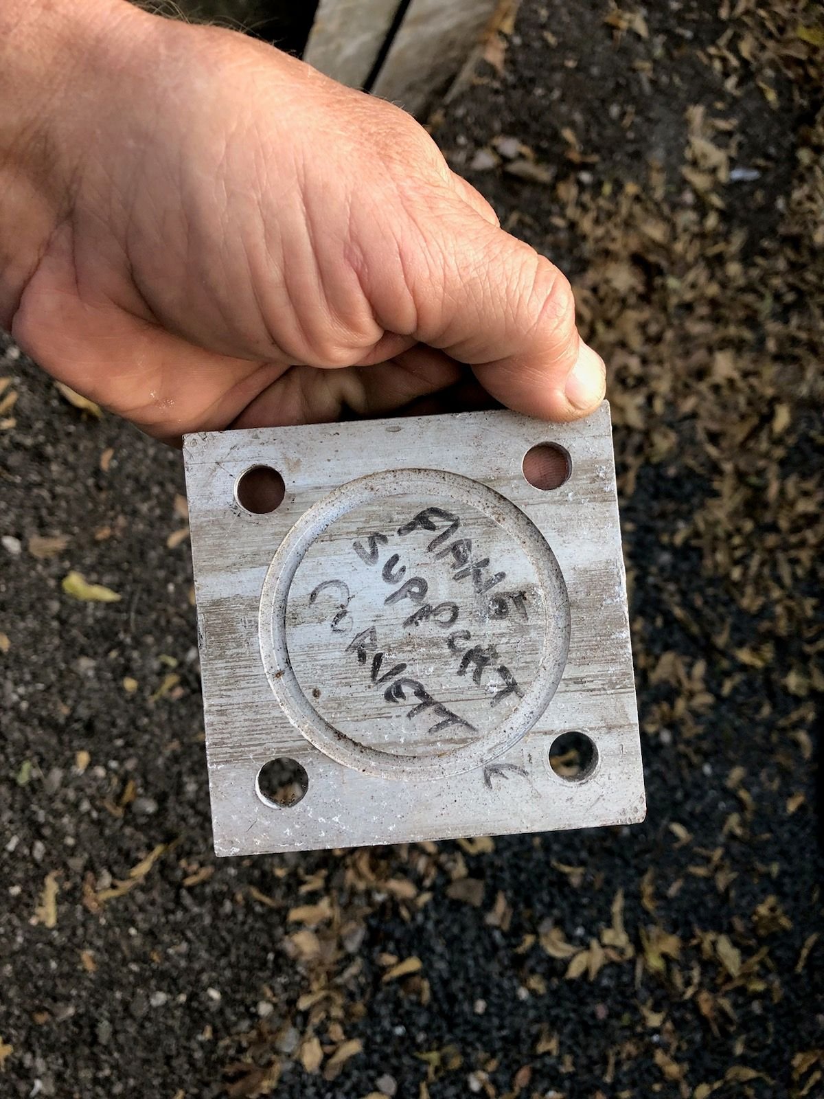

i also made homemade one.
op where r u? U may get lucky if someone nearby..
warning..pack that plate well..i shipped a trailing arm tool to member and got shredded at post offce and an empty box showed up.

Honestly don't this plate (1/4" thick ) is any stronger than a flange, if you bent yours than you were to hasty.
Hell I can built those for cheaper than $50.00, just have to find a deal on material on the bay place.

My only haste was not using a block i made ( not 1/4 inch).. and bolting them together and bending (not by much) them.
those flanges are not asrigid as 1/4. You also need to clearance for the raised lip..tokeep flat

Those common plates are too thin. I make them out of 5/8 or 3/4 steel.

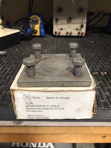

My flange plate I bought from one of the vendors many moons ago, steel and 0.370 thick.
