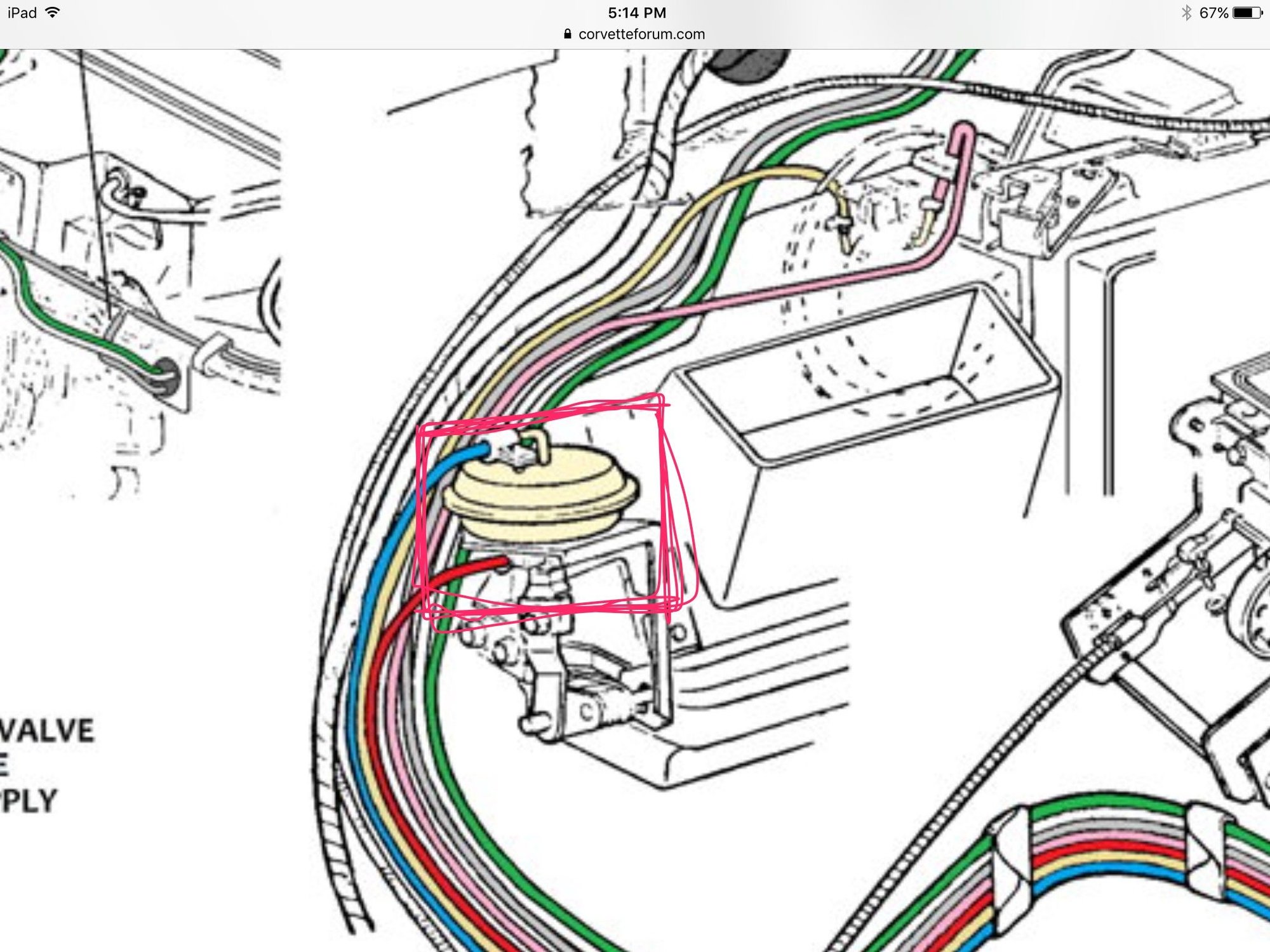

https://www.corvetteforum.com/forums...-switch-2.html

Hi,
Thanks for your response. I was told the relay is behind the glove box. Is that correct and where is this piece your showing located?
Pat

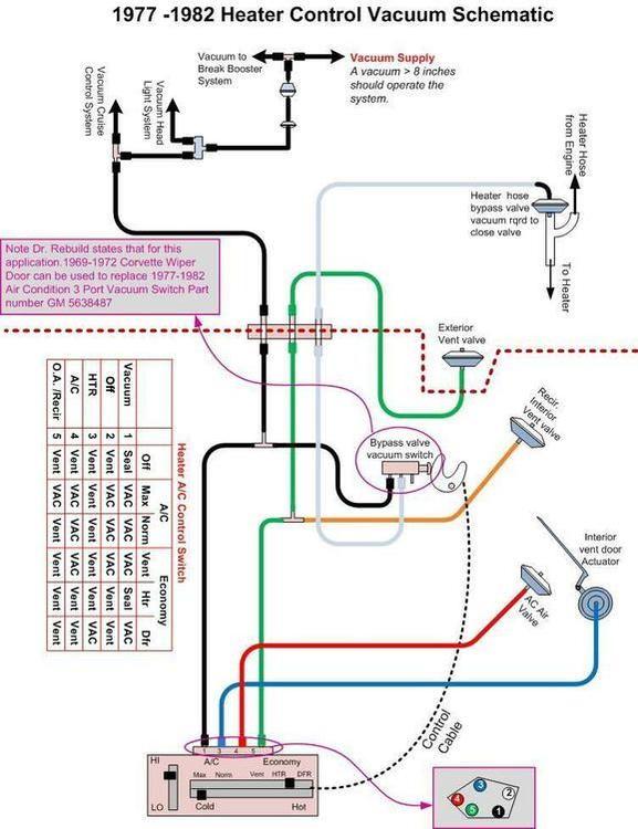

Here is a drawing showing the vacuum system. It is for a '69, but that system is pretty much the same for a few years.

[QUOTE=robertea;1607023015]Here is a drawing showing the vacuum system. It is for a '69, but that system is pretty much the same for a few years.
[/QUOTE
78 has a different controller

Then see post 2..link
behind the glove box is only hot water shutoff

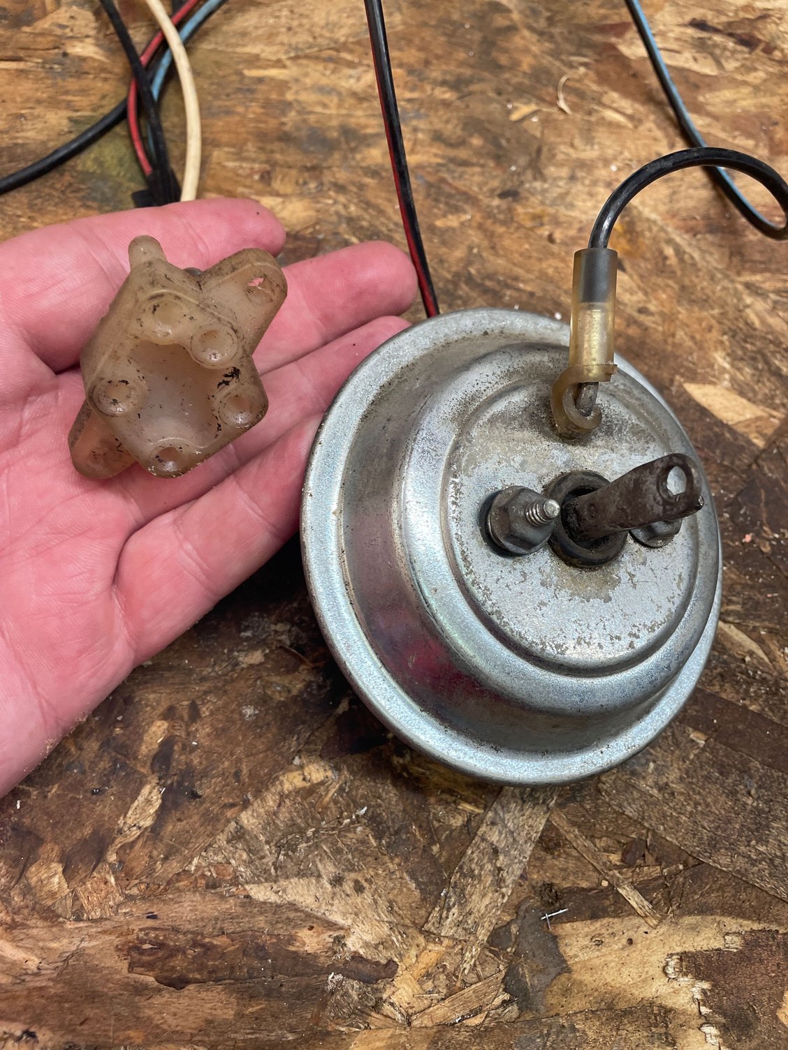

I have a non ac version of the gizmo in the red box above on my workbench right now, if it'd help you out. Not sure.
can add pics later if you think it might.
looking at it, I think it's the same, two hoses on it

Originally Posted by Dodosmike
Yes, that actuator is for a NON A/C car, push/pull to move door and requires 2 vacuum lines.
A/C actuator is a single line.
If OP has some vacuum grease the witch hat rubber seal can be rolled back, apply some v-grease to shaft ans inside of seal.
Sometimes it works...

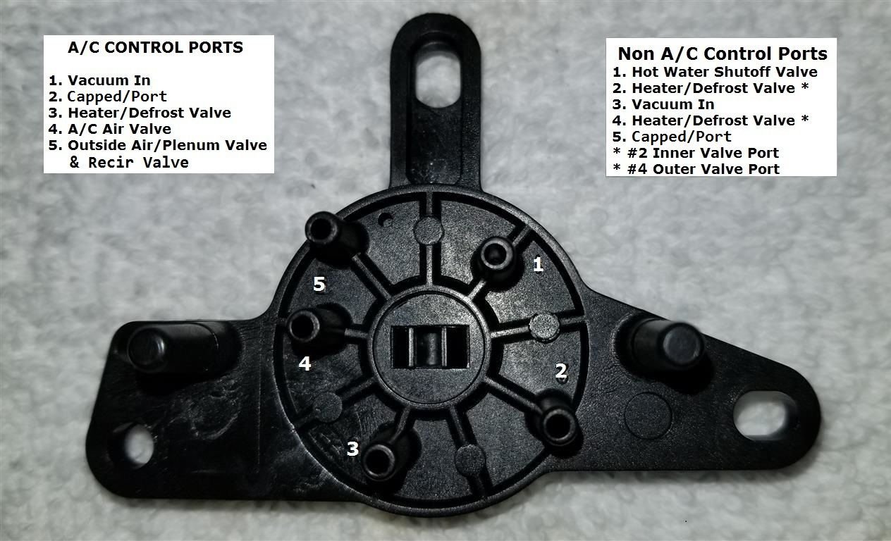

Old Sep 10, 2023 | 04:24 PM
bmotojoe's Avatar
bmotojoe
Joined: Oct 2007
Posts: 4,381
Likes: 1,751
From: Seattle Area Washington
The same vacuum function switch was used on both A/C and NON A/C cars.
Difference is the ports of the switch and what they control.
A/C & NON A/C porting...
