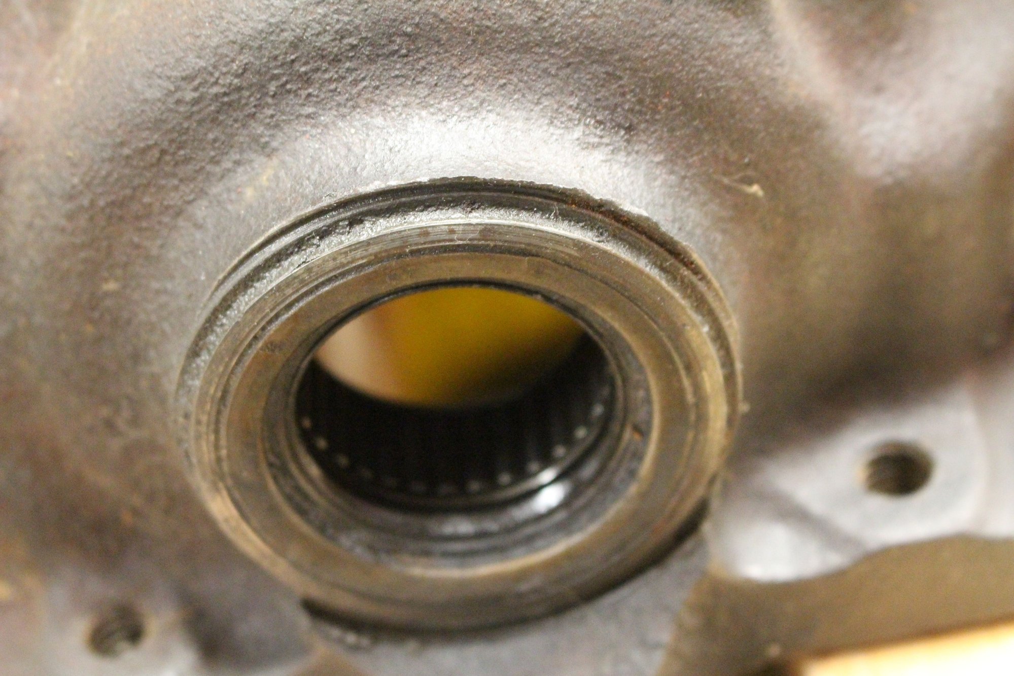

Axle seal area on diff case. This is what you DO want to see. No rubbing marks, both case lip & seal intact. The lip on the case is raised somewhere around 1/8" or so where it holds the seal. Because your bolts hit the ears at the bottom of the pic, you are very close to damaging this lip.

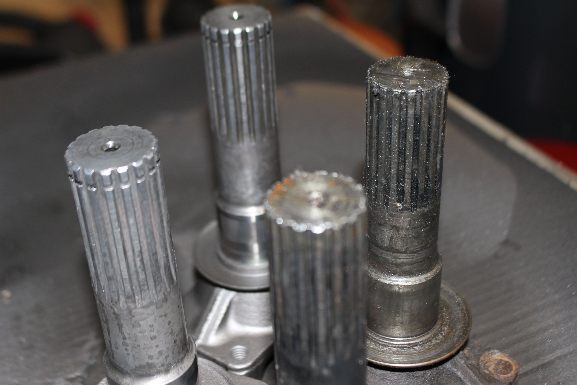

Axle stubs. Good ones on the left measure 0.185" c-clip groove to tip, and have a beveled edge. Worn ones are on the right. Sometimes they go all the way down to the c-clip. These were almost there. I'm guessing yours will look bad and need replacement because the bolts hit.

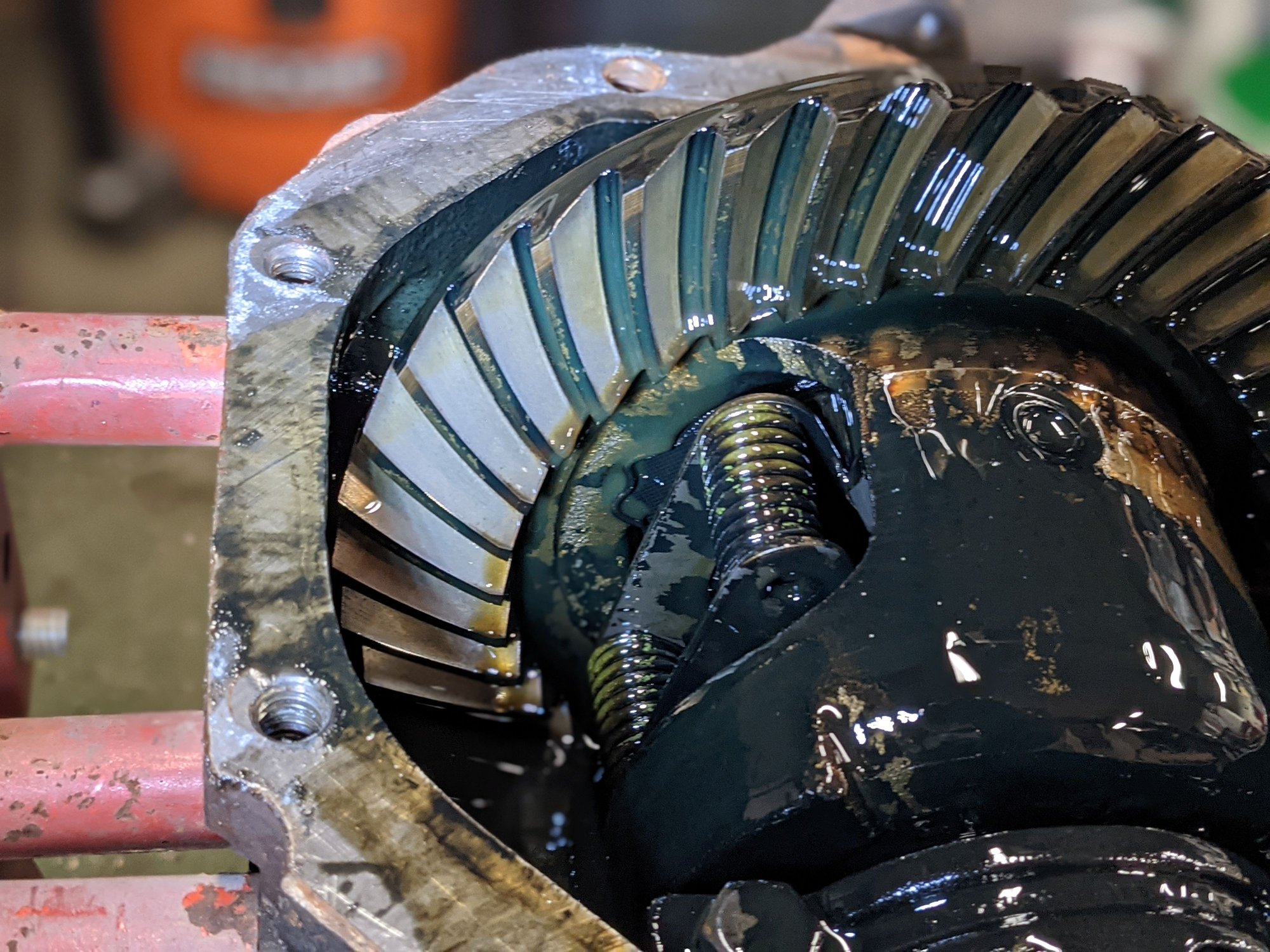

Main gears. Hopefully they did not whine or make noise. Then likely the main gears are still good. Unmarked gear teeth is what you DO want to see. A very smooth shiney surface.

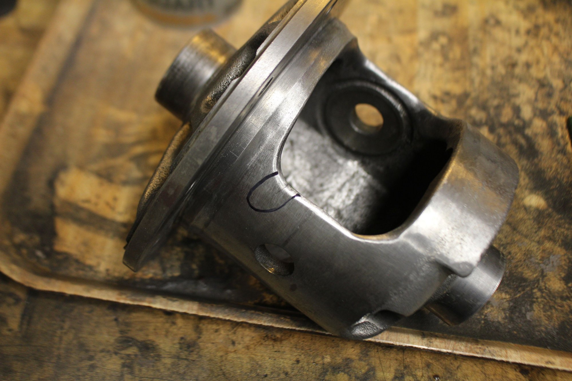

Posi case. This is what you do NOT want to see. Spray the grease with brake clean and look carefully for cracks, especially near all the windows and the pin hole. The pin should fit pretty snug in it's hole. I went thru 3 cracked ones before I found a good used one.
