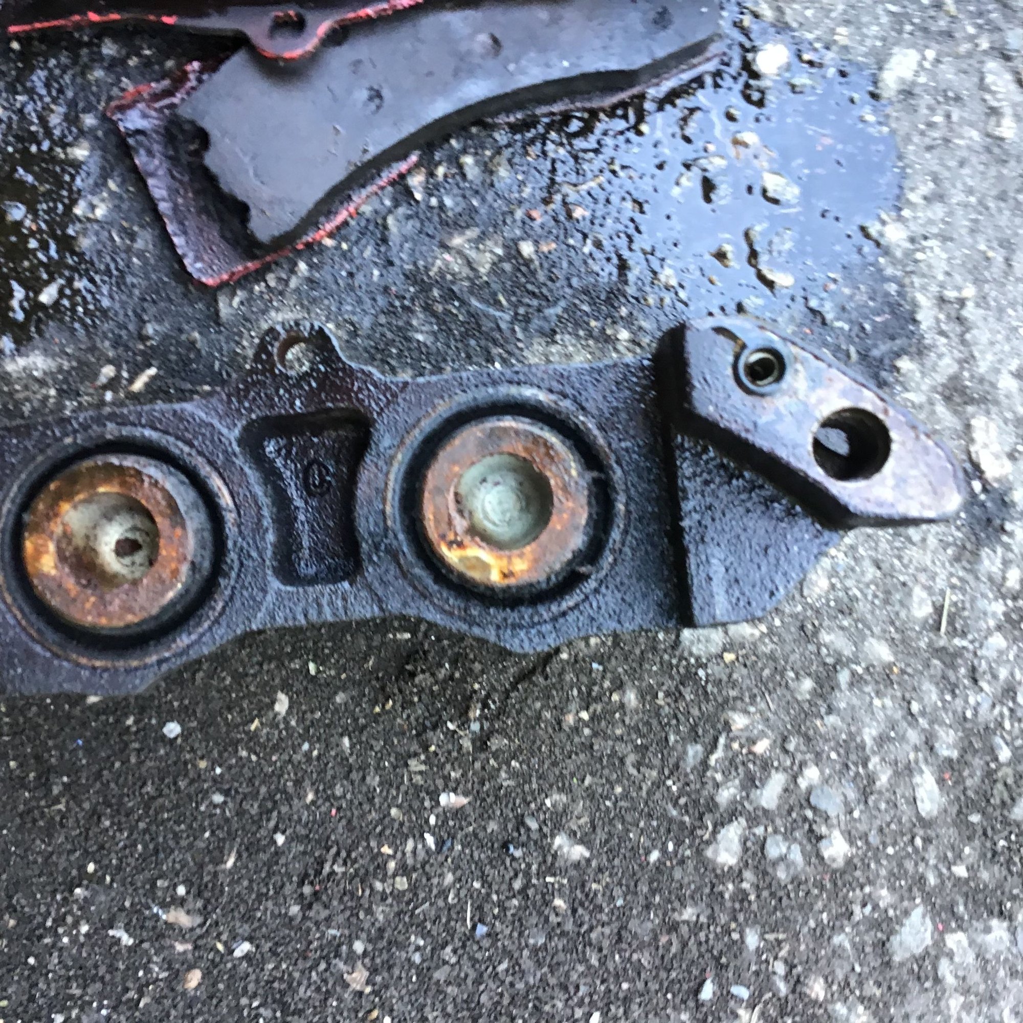

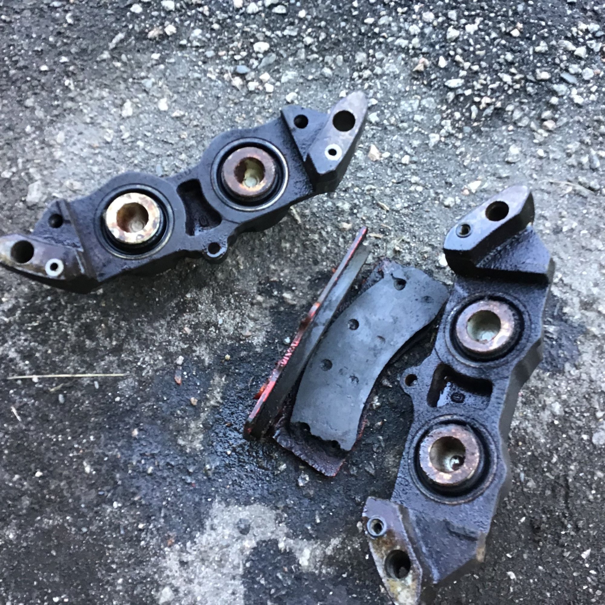

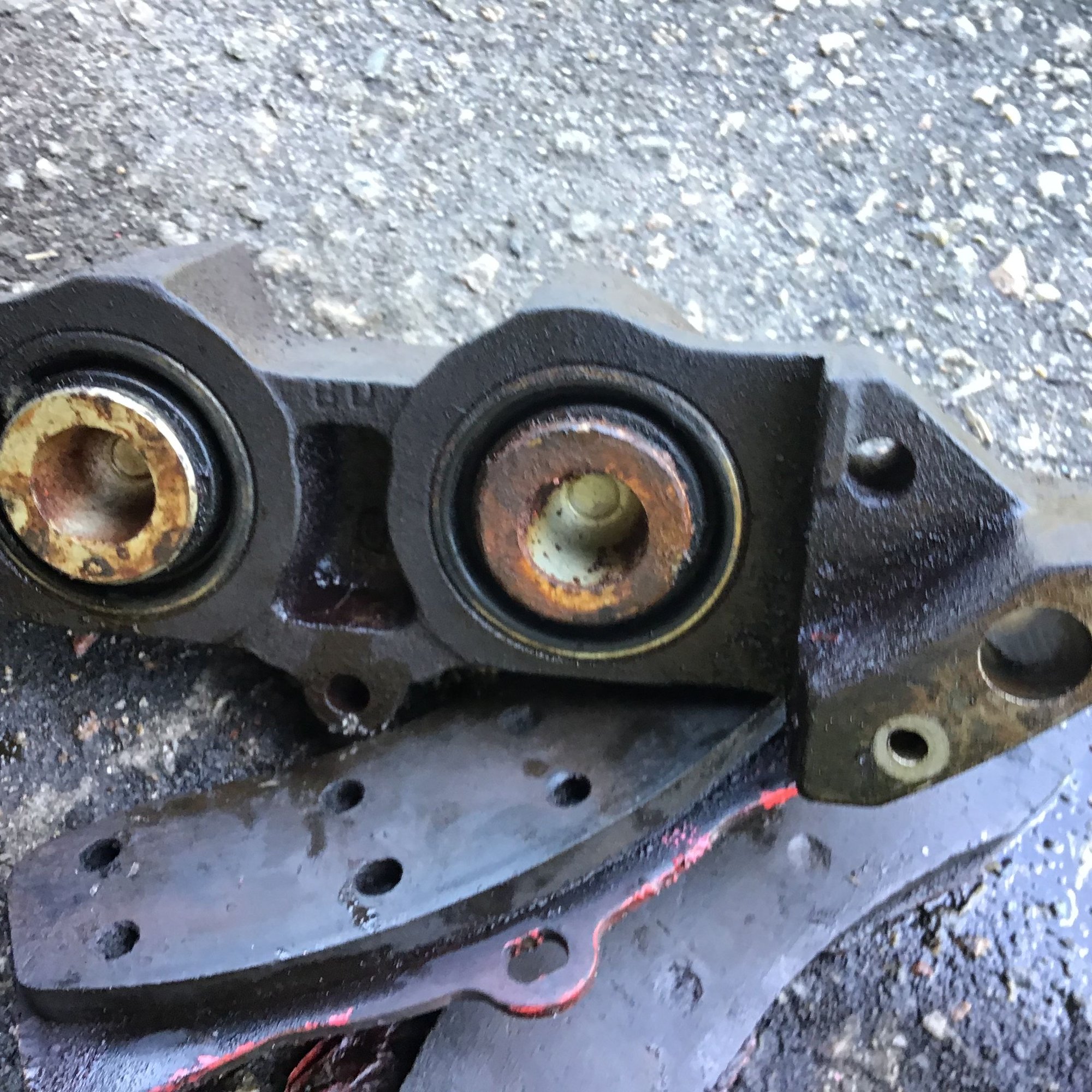

Here is the passenger front is it worth rebuilding or $80 buy remanufactured,Autozone has Duralast.
It looks rough,but it was not leaking

Open them up by removing the dust shields and popping out the pistons. See if they have been sleeved in stainless steel. If so, are the bores pitted or corroded? If so, they can be honed and rebuilt. I use O-ring pistons. You can thoroughly clean them with soap and water and finish the job with denatured alcohol. Really pretty easy. If they have not been sleeved, I would trade them in for stainless steel sleeved calipers. You can get the kits from Van Steel. If the fronts are that bad, the rears are, most likely, in the same shape. Lastly, replace the four rubber hoses at each corner and check the master cylinder. Don't forget to flush out the lines with new Dot 3 or 4 fluid. Jerry

I'm always pro DIY......They are super easy to rebuild, and then you know what kind of care was put into the assembly. The choice you have is lip seals or O-ring seals, and the piston will decide that for you as they are different. Now on those calipers you won't know what you have until the pistons are removed and the bore inspected for corrosion. They should have the stainless sleeves installed, but if not, I'd go the exchange route.

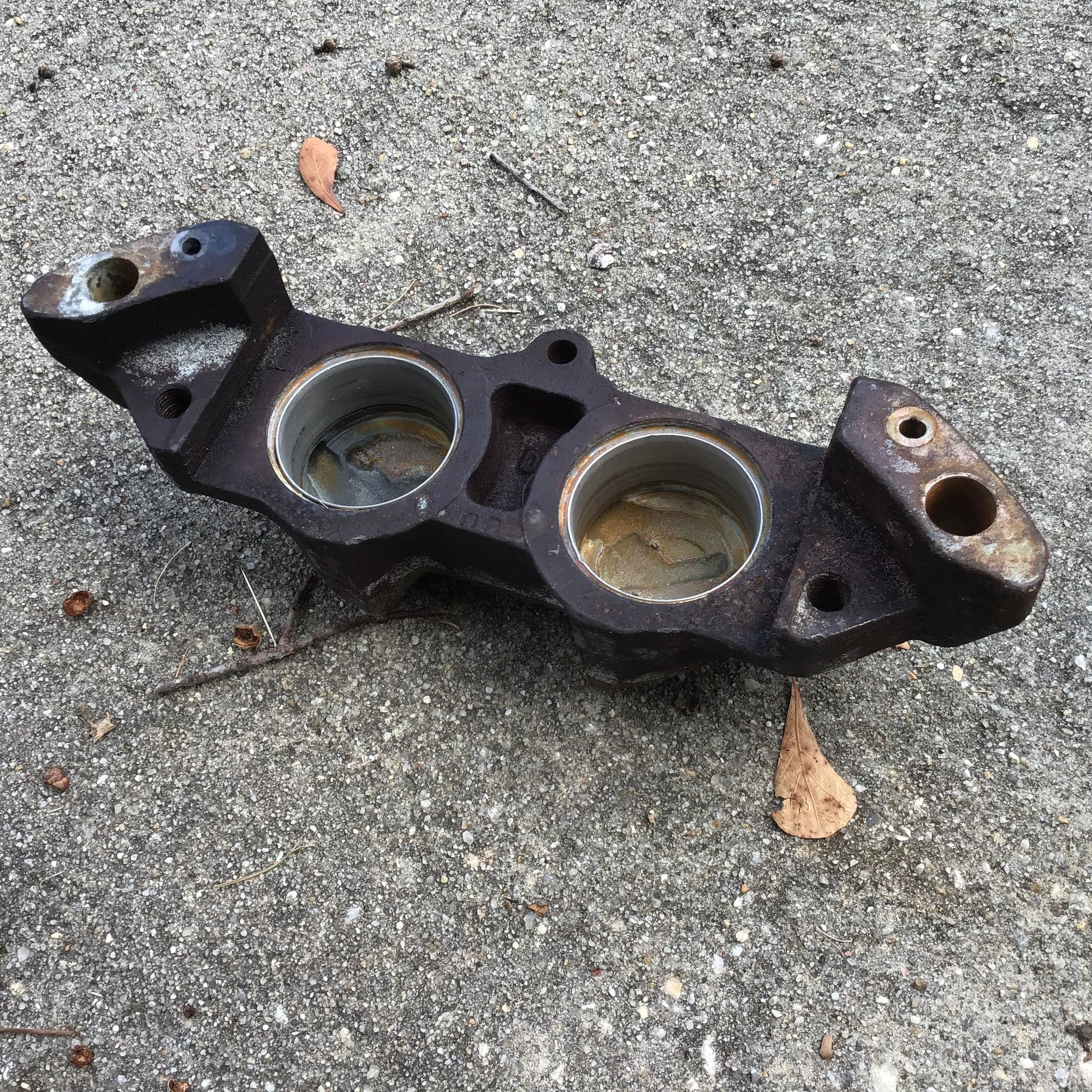

I opened one side,and they are sleeved and no rust,shiney but dirty,from sitting up,and yes I could clean them pretty easy,so have no problem replacing with a kit.and with O rings.

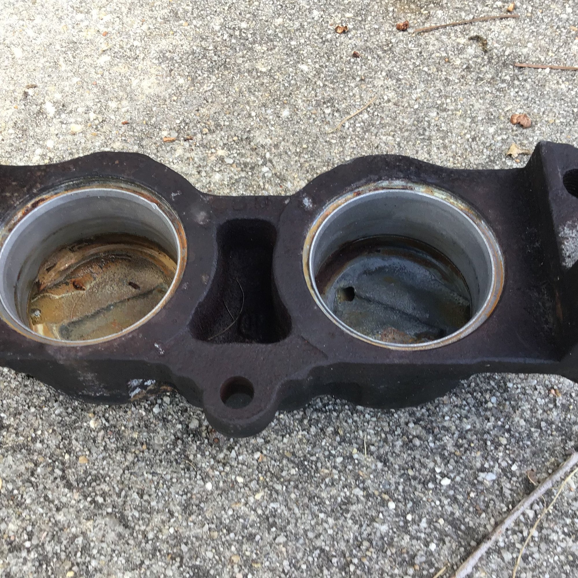

Is this so called sleeved or not.

I haven’t cleaned yet,just washed them.but these are SS sleeve or not.

Yes they are sleeved and it doesnt matter if they are or are not sleeved if they are smooth. The sleeving was to repair the pitting caused by water in the brake system. I have both on my car with the CSSBinc Oring kit and they stop great and havent leaked in 4 years
