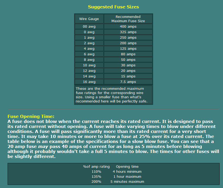

Running the 6GA straight to the starter solenoid removes any protection- you have the entire capacity of the battery ( 700+ amps) running all the way to the alternator through the engine compartment.
6GA is rated at 80A- so that charge wire unprotected becomes a fire hazard (see chart). If the alternator is shorted out- smoke comes out of the alternator and it stops putting out power.

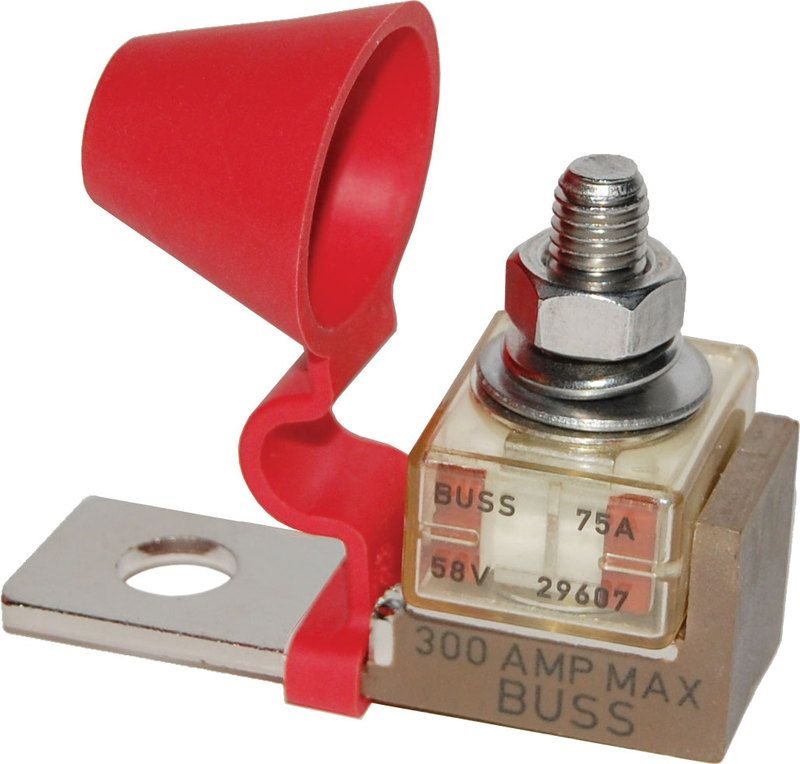

I HIGHLY recommend when upgrading the charge system/wires/alternator on harness that was designed 50 years ago with no thoughts on running 100A through it- This
A fuse at the battery- 225A seems to be the best from real world use Blue Sea is the company

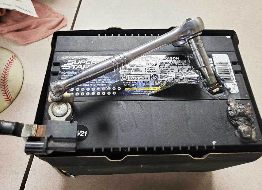

Batteries are dangerous in the hands of an untrained tech or a reckless homeowner. That one in your picture is proof positive. I have seen many burned or exploded cases from defective batteries. What really scares me now is the new battery powered Cars are using hundreds of volts and above 58 Vdc the DC current can and will kill you if you are not really careful.
