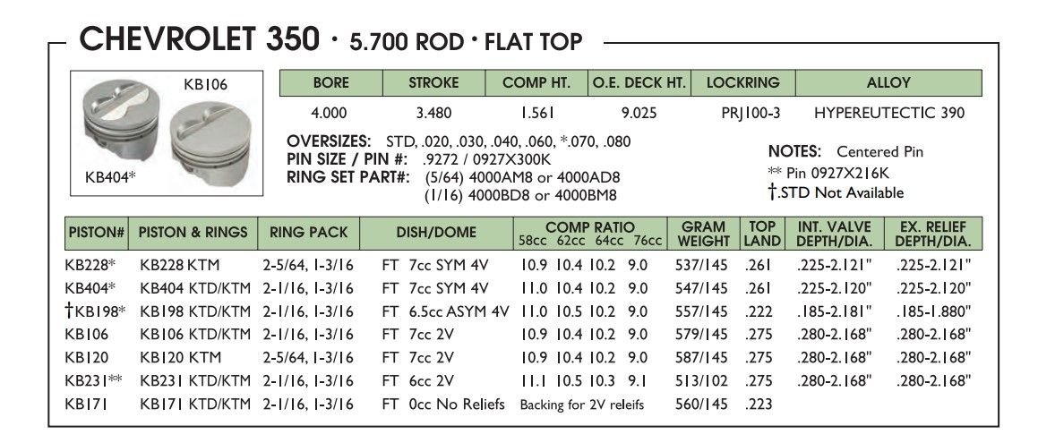

Here are 2 choices:
K-B Hyperuretic
ICON Brand forged
These CR calculations assume a standard deck block and .039 gasket per catalog notes. My math says the pistons will be .020 below deck. 9.025-3.48/2-5.7-1.565 = .020 (deck height, stroke, rod, compression height)
It is easy enough to download a catalog and browse.
It is not hard to get compression up with 64cc heads. You could even do it with the 76cc heads, just a diff piston, maybe a small dome.
But I would always double check both Compression and Dynamic Compression with a good on-line calculator, Wallace Racing has some very good ones.
Have the block carefully checked for flatness, by a machine shop, before determining it does not need to be decked. Buy pistons after that, not before.
All of this and your cam timing comes into play to stop your engine from pinging.
Keep your DCR below 8.4 with this calculator:
http://www.wallaceracing.com/dynamic-cr.php
You can build 350+HP into this very easy with 10:1CR
Try a 220 dur cam @ .050
The example above withe 9.025 deck and .020 in the hole with a .039 gasket gives you .059 quench. Which is OK but not great. With this quench keep the DCR below 8.0. With less quench you can run up the DCR some. Lots of places to juggle these numbers around.
DCR counts much more than static CR.
If your cam is too small with 10:1 you will detonate.
Al of these should be selected at the same time: deck height, piston, head size, cam duration.
