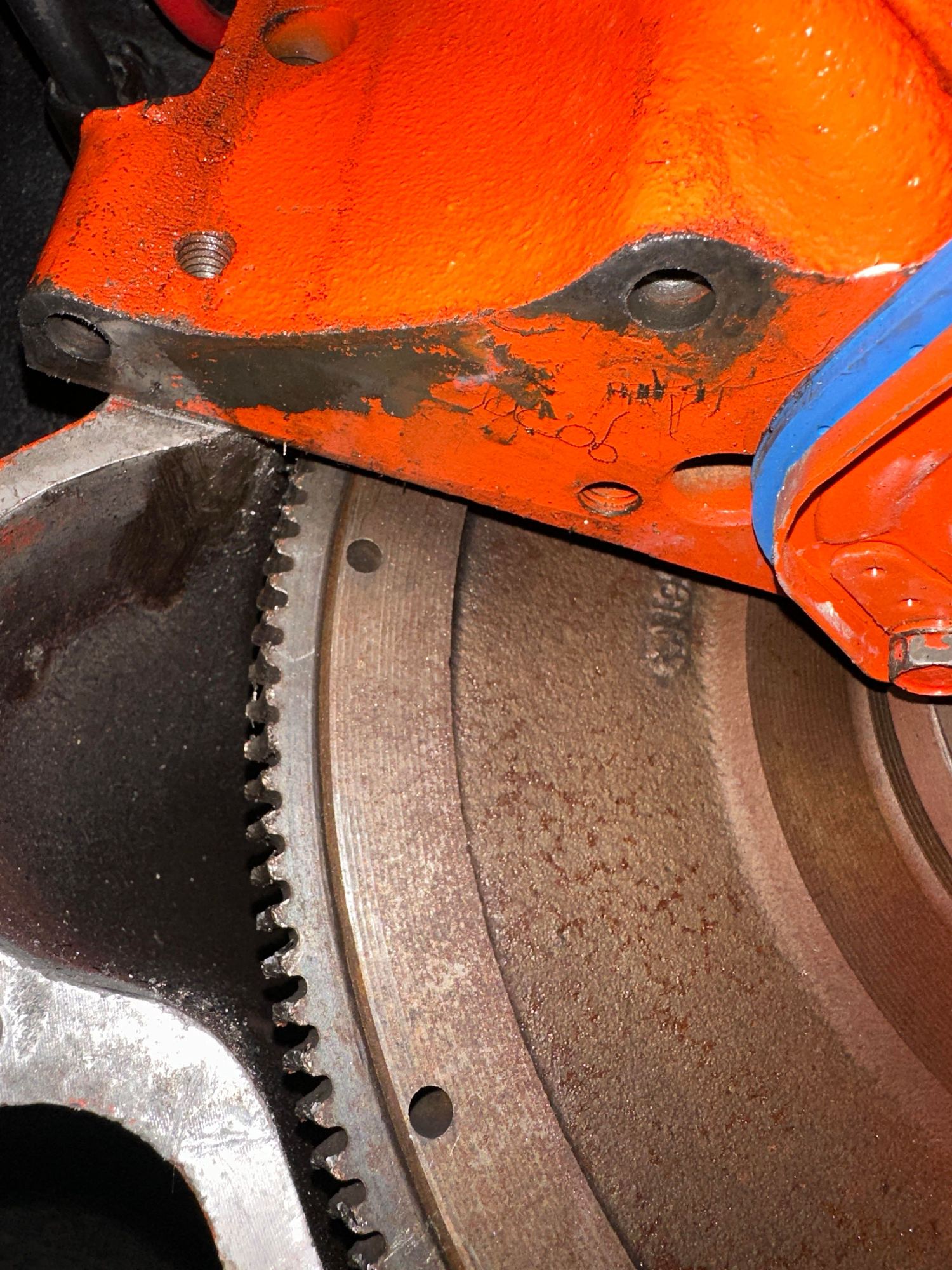

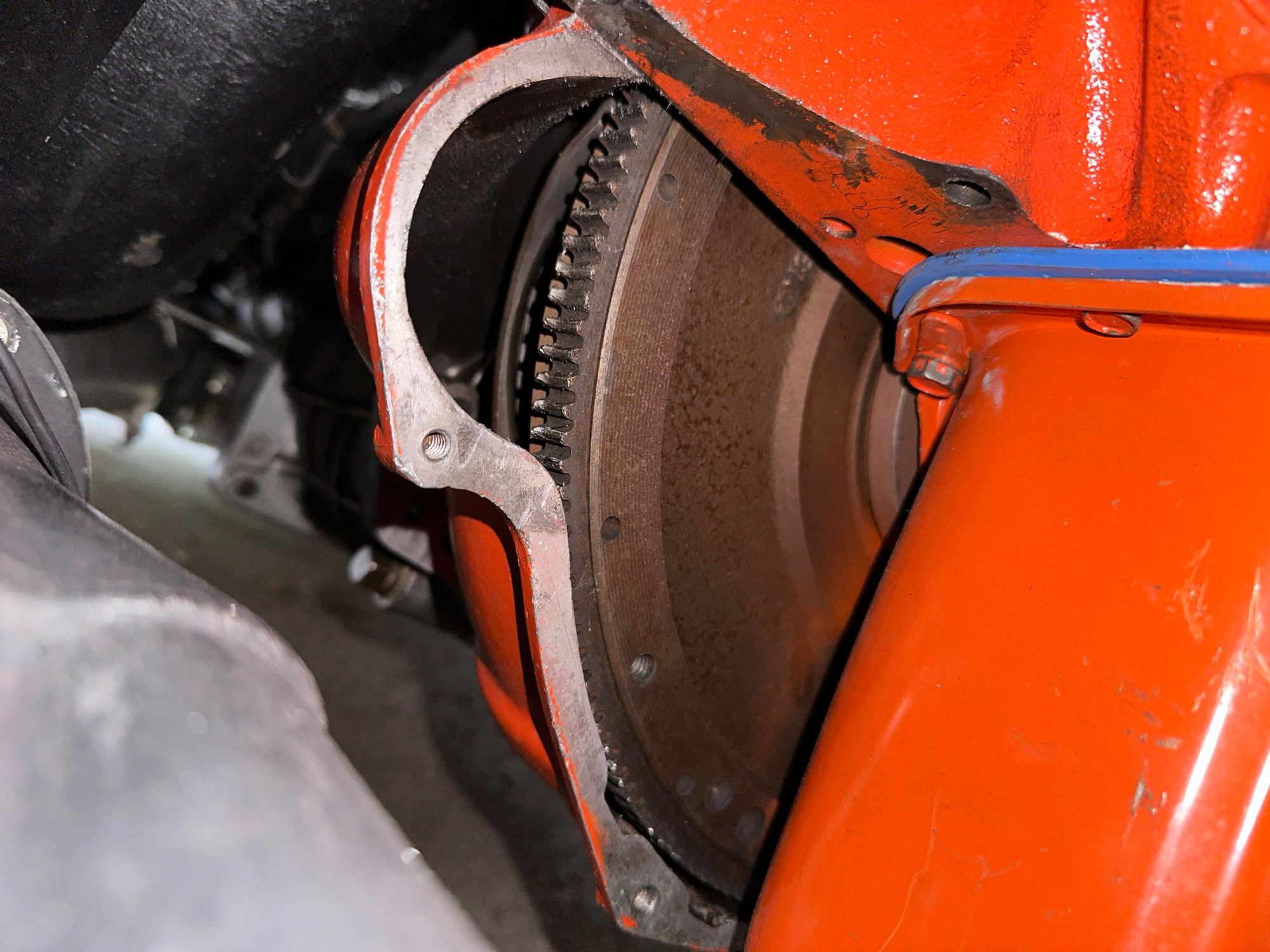

Hi. Excited to be a part of this community now
Just bought a 71 C3 that had an off frame restore with 383 stroker and 5 speed tremec with most everything new, rebuilt, or replaced.

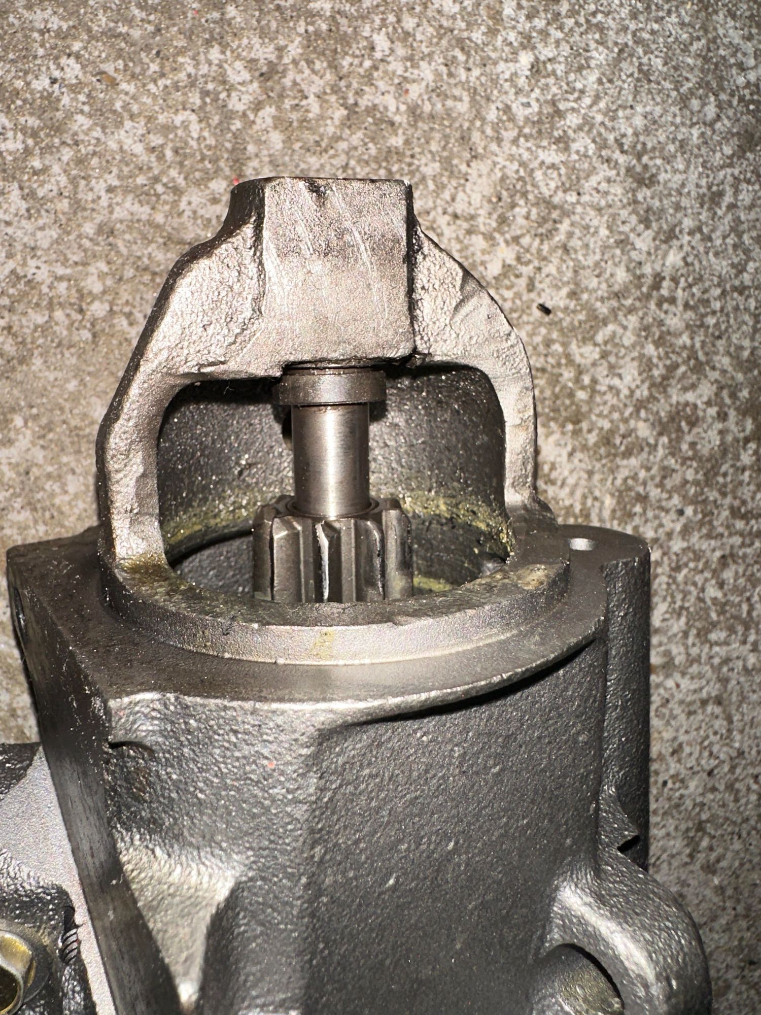

Unfortunately I need help already and can't even drive it yet. The prior owner threw in a napa 2461091 reman ac delco high torque starter last week to get it ready to sell. The issue is that it pulls away from flywheel/mount when torquing mounting bolts or after a few starts. If I am lucky enough to get it to mount 'right' it works perfectly until it moves and yes, I torqued to spec and tried with/without shims. I think the flywheel seems ok yet but don't want to keep grinding away.
Can someone please confirm the flywheel is still okay and recommend a good starter. Or is maybe this one just defective. I've seen some high torque ones but they seem to have a square mount without a cap. Not sure how that is supposed to work
Thanks!

Make sure you have the starter brace on it could solve your problem.

Sounds like you don't have the knurled bolts.

That flywheel is not OK.

Are you using the brace
https://www.zip-corvette.com/70-82-3...unt-brace.html

Flywheel is junk. Teeth are all but gone. It’s the reason the seller put on a new one to make the sale.
