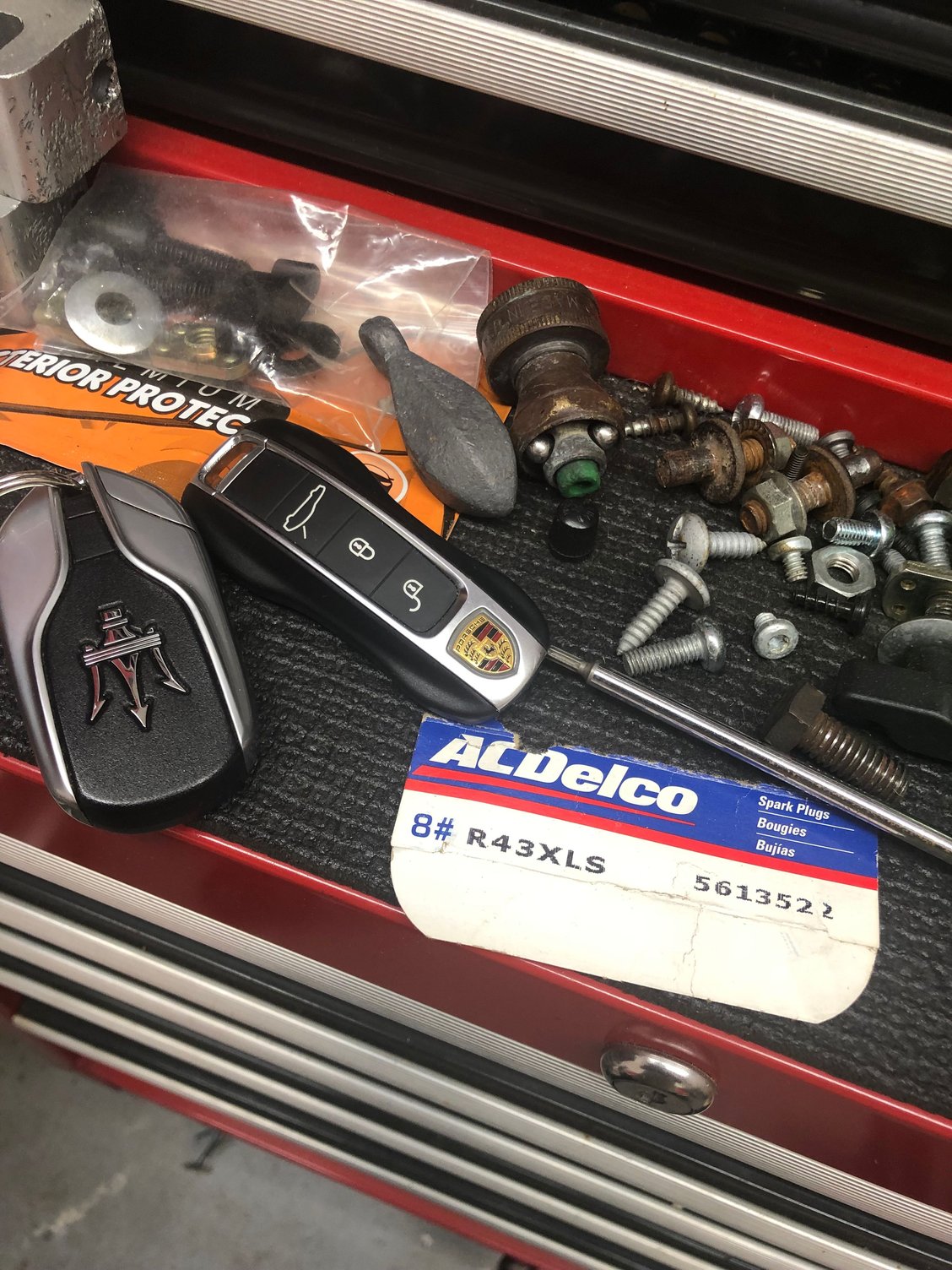

I'm using R43XLS # 5613522 in mine without any issues !
