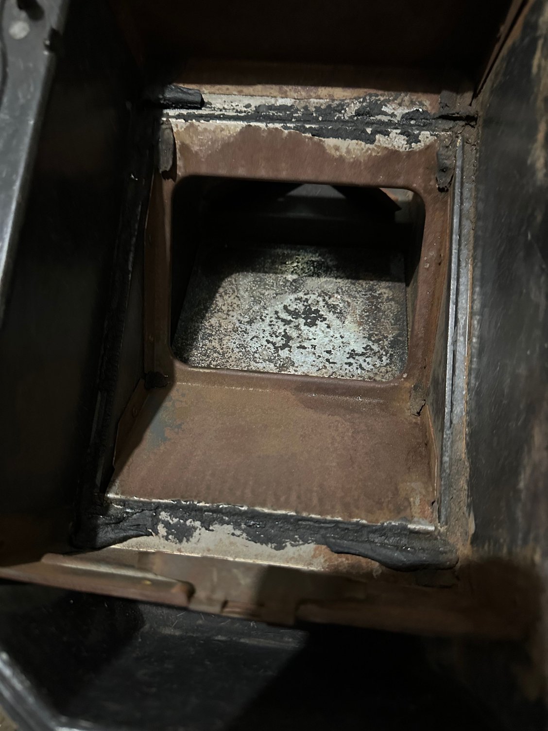

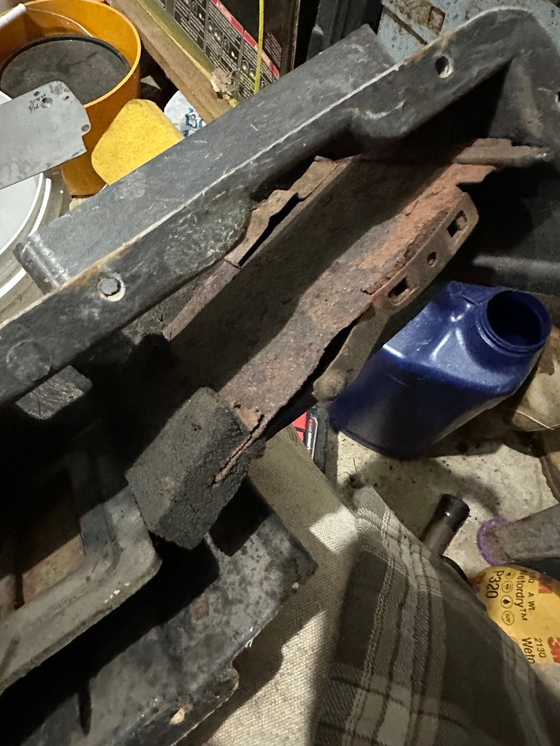

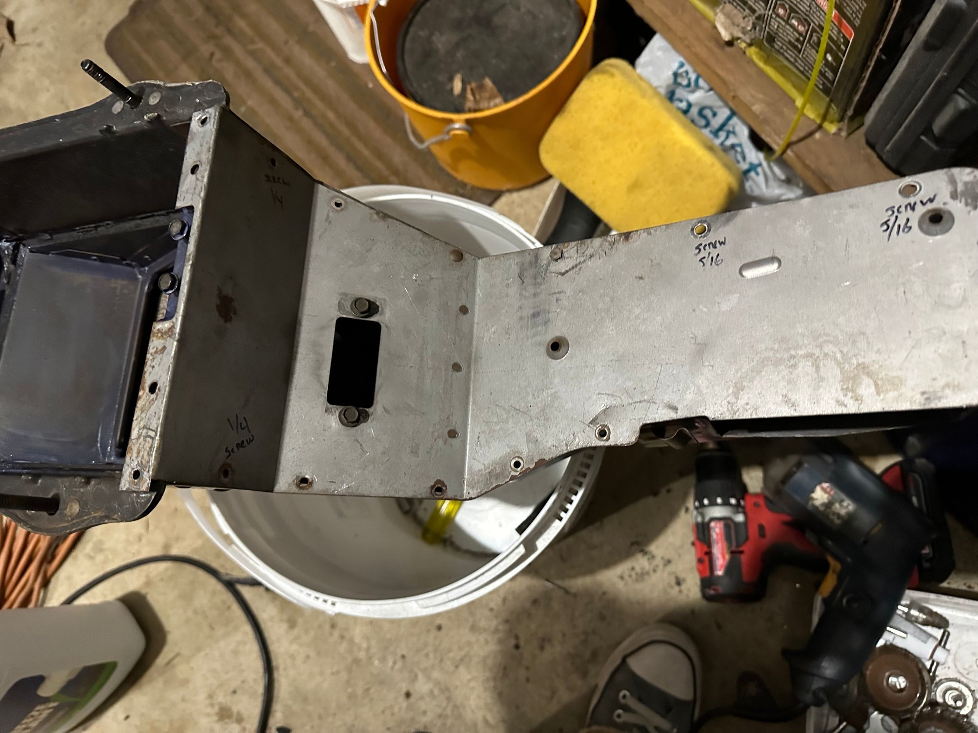

In the process now of rebuilding the heater box with new seals and rubber gaskets .
lots of surface rust on all internal metal parts that I’ve cleaned up and coated with a rust neutralizer.

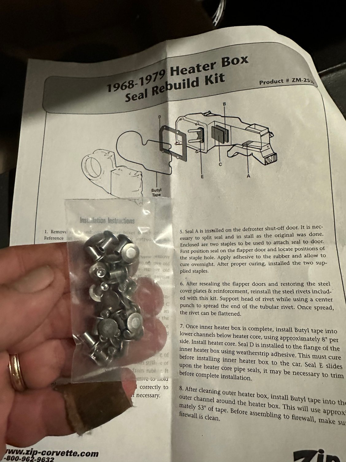

I had to grind out the rivets that holds the plate to the box and the kit provides replacement rivets. They seem awkward though as they say to install and flatten the ends. I guess I’m supposed to use a punch on the end that goes thru and hold the other side against something solid, maybe my anvil or a body hammer dolly, then when holding the punch tap it gently to expand it. Sounds like I’m going to need an extra pair of hand for that.
Wondering if I could just use pop rivets instead?
Anyone else tackled this project?

When I rebuilt my heater box , on my 69 with no A/C , I used 10/32 screws and nuts instead of rivets . No one will see it and they made it easier then the rivets .
Steven
