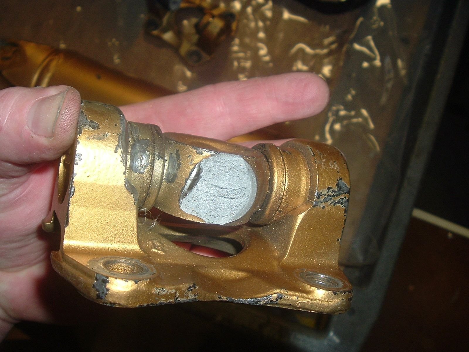

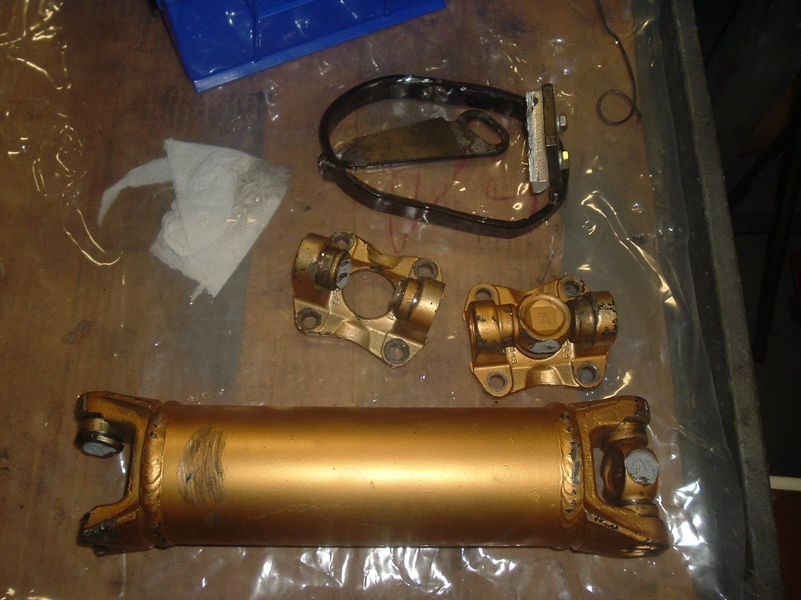

But here is the deal, the weak link is still the joint. We sheared Solid Spicer 1350 joints in half, both inner and outer, one dead hook. Bam - done, took out the shaft yoke too. The tubes were not damaged. Stepped up to 1480 and haven't seen that.....yet. In the same situation would an 083" tube or "HD" 090 tube have held up?

Here is the aftermath from that day at the track.

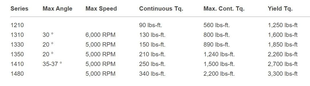

The specs of a 1480 u-joint say it would take 50% more TQ to break than a 1350.
A 500 ft lb big block stresses a 1350 pretty close to it's limit.
500 x 2.20 x 4.11 / 2 = 2260# , basically enough to permanently bend them, or worse. A clutch drop at full TQ with the sudden shock could be explosive.
A 1480 should work much better. It would almost laugh it off.
