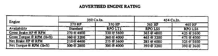

I'll give you a build recipe, step by step. First thing you need to know is your 76 was rated in net HP, and almost all engine builders, etc, talk gross HP.
1971 was the only year GM rated them both ways. A basic 350 L48 was rated at both 210 net HP and 270 Gross HP.
The good news is your 180 HP engine (net) is very similar to that engine and is only 30 weaker. So yours is really 240 Gross HP right now.
The main difference in those 2 engines is your single exhaust and catalytic convertor. If you can legally put true duals on it, you basically get the 30 HP back. The exhaust helps a lot, I did that on my 75. Headers will help some more. Turbo mufflers too. So now 290 HP already (gross) That is your biggest bang for the buck. Better heads definately help a lot, like the Vortecs, maybe 25 HP, so 315 HP now, A camshaft change would help some, but you want power at like 1200 to 5200 rpm for a cruiser, so it's not much bigger than you have now. Say a 212-215 dur @ .050 type cam. (The old 300HP cam is only 195). Keep the cam mild. 330 HP now. The Q-Jet carb is a really good carb, when un-molested. If it runs well, keep it, But a better Q-Jet style intake might add another 10-15 HP. So 345 now. You haven't even spent much money yet. But now you have the foundation to make it stronger. If you want to change the pistons the block needs to go to a machine shop. Hyperuectic pistons are fine for your use, but upping the CR from 8.5 to like 10:1 will really make it feel crisper, and help MPG. Might be worth 10-15 HP. So now you around 360HP with a real strong low to mid rpm TQ monster. Perfect for the street and cruising. More cam gives you more rpm, and you may not want that. The engine takes longer to wake up, say 1500-1800 to 2000 rpm, that's too much for what you are describing. More expensive, new aftermarket heads would help even more. They make the biggest difference. You could add another 20-30? with some really good heads. Say 385HP now. That's 60% more power than you have now, with similar driveability & manners, It would be a rocket!

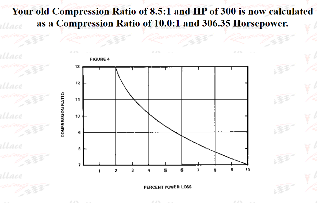

The compression does not buy you all that much HP at this level, but it sure feels better than what the numbers say!
So if the short block is good don't even touch it. Spend the money on the heads instead.
