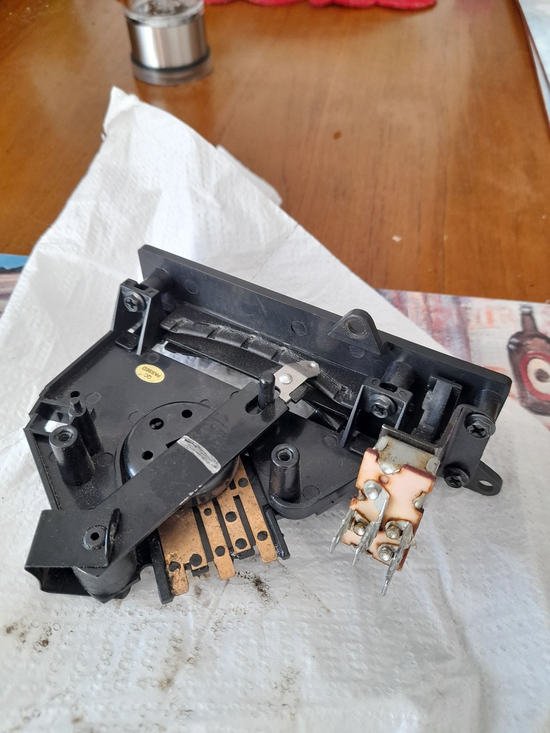

Yes I have. The lever that you slide for heat/ A/C / vent. Does 2 things under your console. One it moves the vacuum switch that controls the doors that move to direct air up middle or down, and on the other side is a electrical switch that directs power to the blower switch and to the compressor clutch.
looks like this.

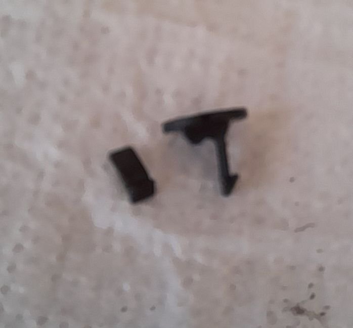

Now under that metal strap over the center of the round part of the switch is a plastic rivet that let's go with age just like the one on the vacuum switch.
here's mine.
When this let go, the switch "tipped" on a angle allowing electrical connections in some areas but not all. Exactly like your car now.
so I repaired the switch the same way we all repair the vacuum switch which suffers from the same broken plastic rivet problem. Except, due to clearance I had to counter sink the nut on the far side by melting it into the plastic. Not hard but great care is needed to not melt to far or to much.
Looking like this.
Was a real "putzy" project. Cost zero cents and my blower control is perfect again.
