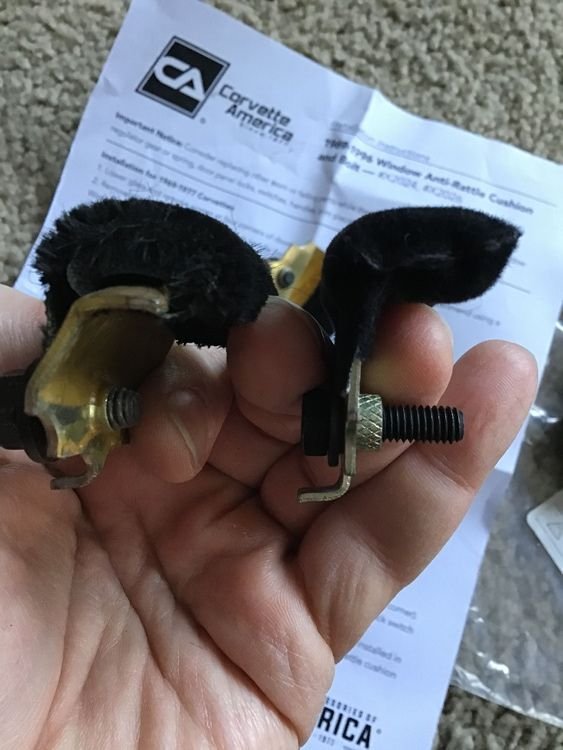

Also check and adjust felt bumpers..they wear out and align wndow

After removing drivers door panel, they're definitely wasted.
Any suggestions for a window refresh kit?
