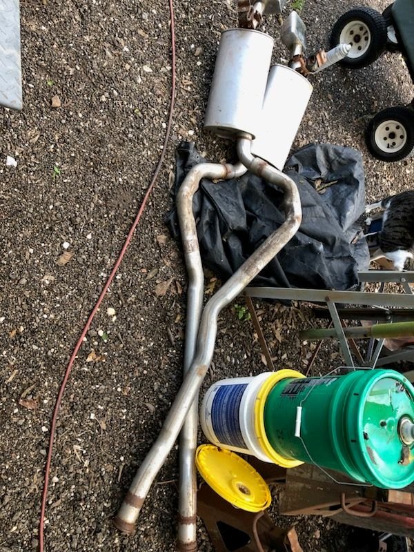

I recently removed the headers from my 71 Corvette, 350, auto trans. I installed the factory manifolds and purchased a factory reproduction exhaust from a well know vender. The exhaust fit perfectly on the passenger side. The drivers side is a no go. Muffler won’t line up and mid pipe seems to be too short. I can force the system together but the muffler is way off. Something isn’t bent right. I contacted the vendor I purchased the system from. They had to contact the vendor they purchased from. I was asked to send pictures of the system on and off the car. I’m still waiting for a response. Has anybody else had this issue? All the drivers side parts were marked drivers side.

It looks like the muffler is for the passenger side compared to my welded pipes..

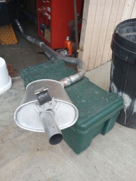

Here are a couple of pictures of the driver side muffler rear attachment point.... before I drop it. I will take more pics after I drop the exhaust. Hope this helps.

And here is a picture of it removed so you can eyeball from that perspective:

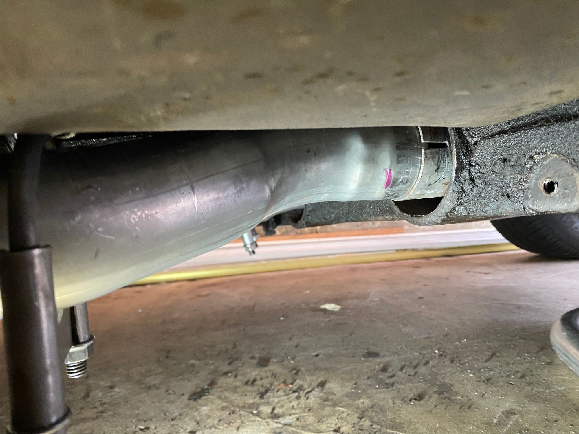

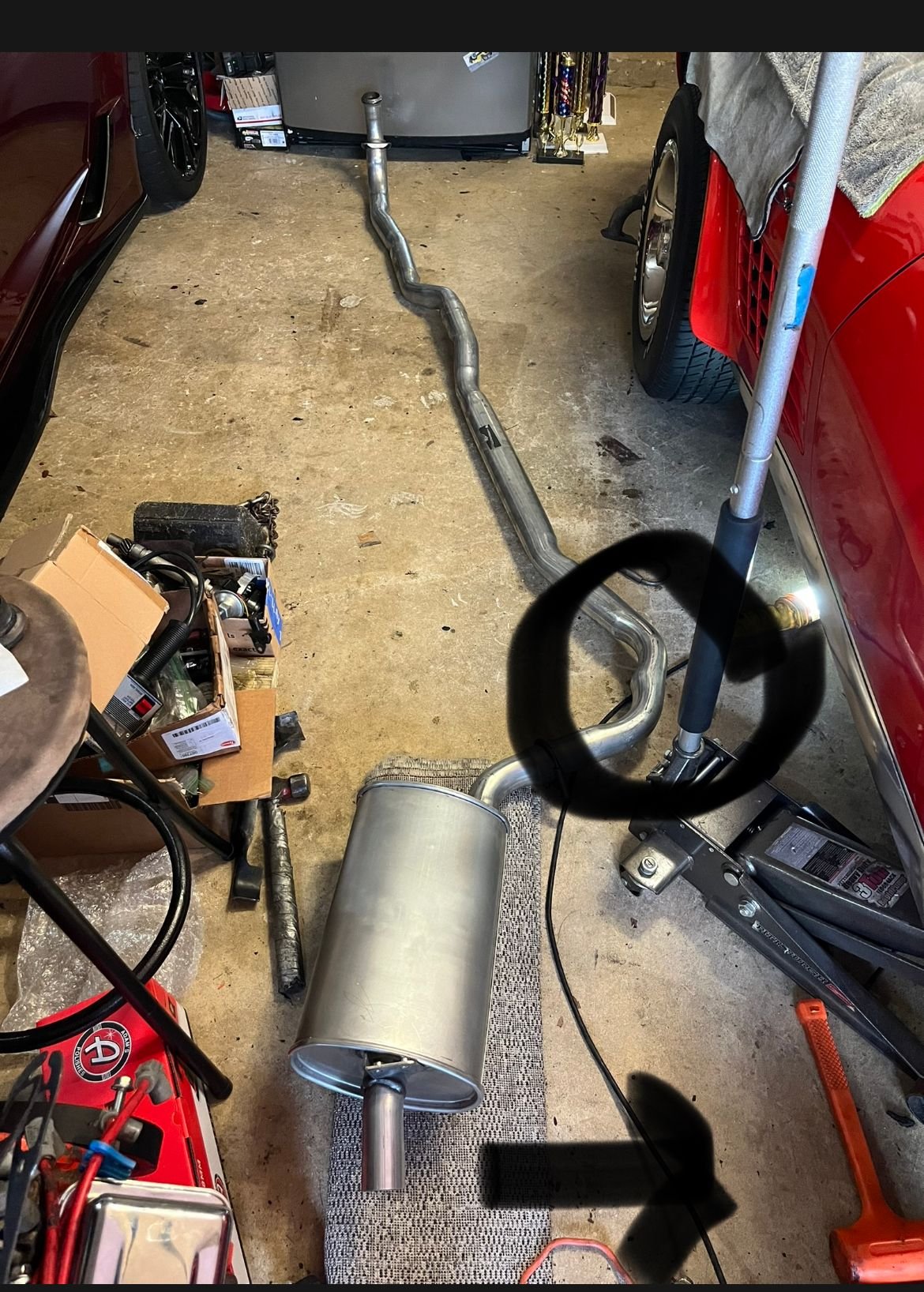

Thank you! I appreciate the pics. I think the problem is the area circled in this pic. Don’t mind the mess just installed the engine as well.

I can't tell if you are using a clamp to attach that muffler.
My intermediate pipe is "semi flattened" so that it stays farther above the deck as it passes under the rear suspension. I cannot really tell what is going on with yours but it does not seem "flattened" like mine.
If there is a problem there then it is just built incorrectly, eH?
The only part that is flat is the center section, nothing is flat in the location I circled. Probably just going to take it to a muffler shop. The vendor isn't being very helpful.

Found another picture. You can kinda get a different perspective from this angle and see where it is get "flattened" for the section that goes under the differential.
Since I can drop my exhaust straight down with the pass-under tranny crossmember I removed those clamps and welded my mufflers on yesterday (after ensuring it was tucked in nicely),
