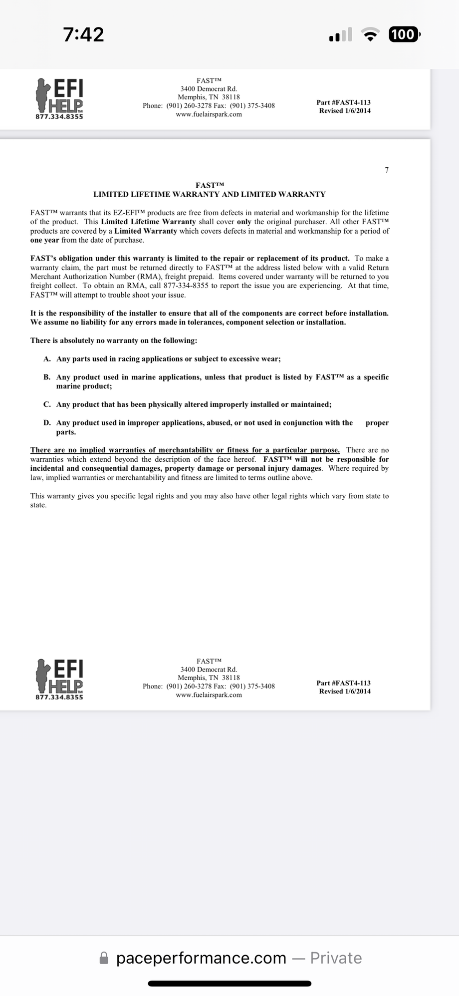

The "band" in the distributor "1 is throwing me too. The new cap I got from Fast didn't even have one.
instructions are attached. The first line references the band.

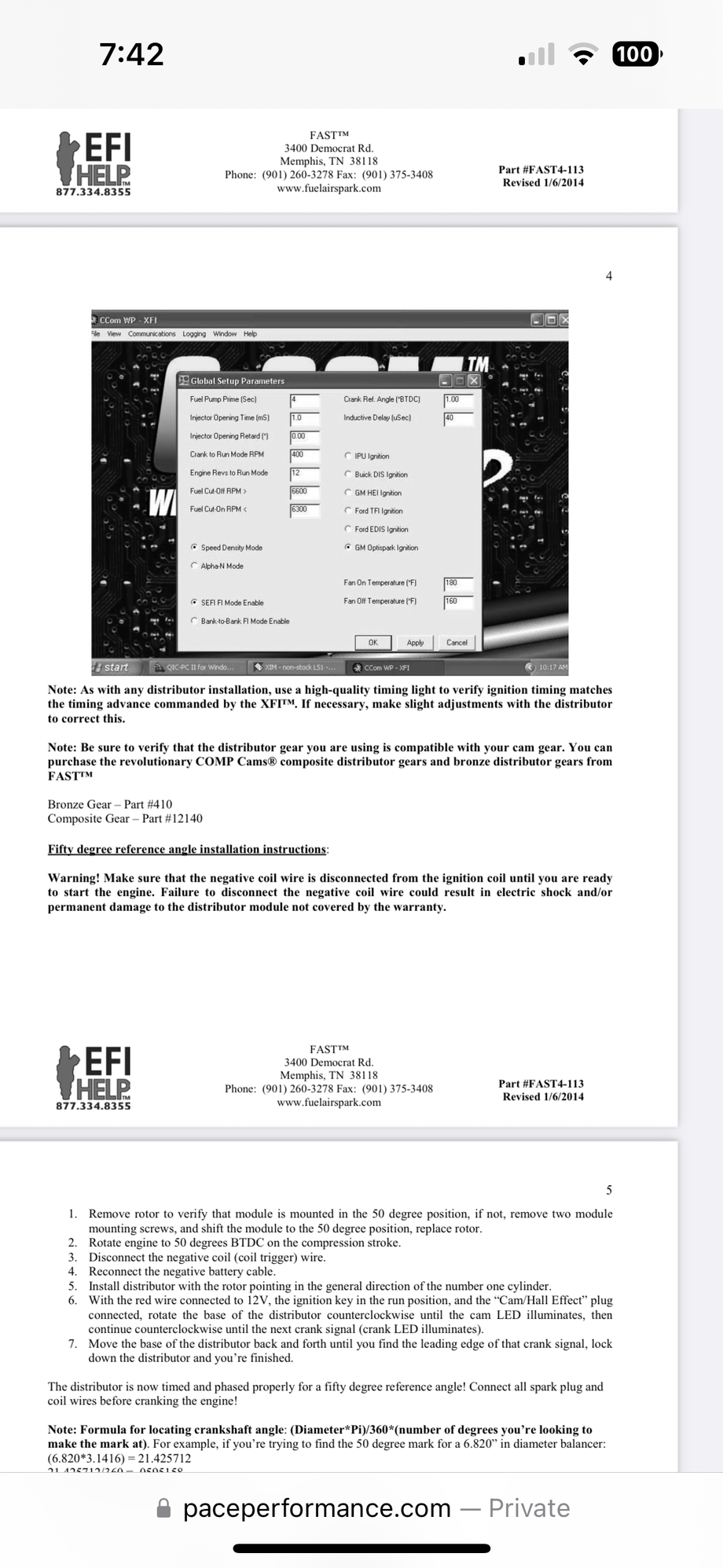

Rest of
the instructions

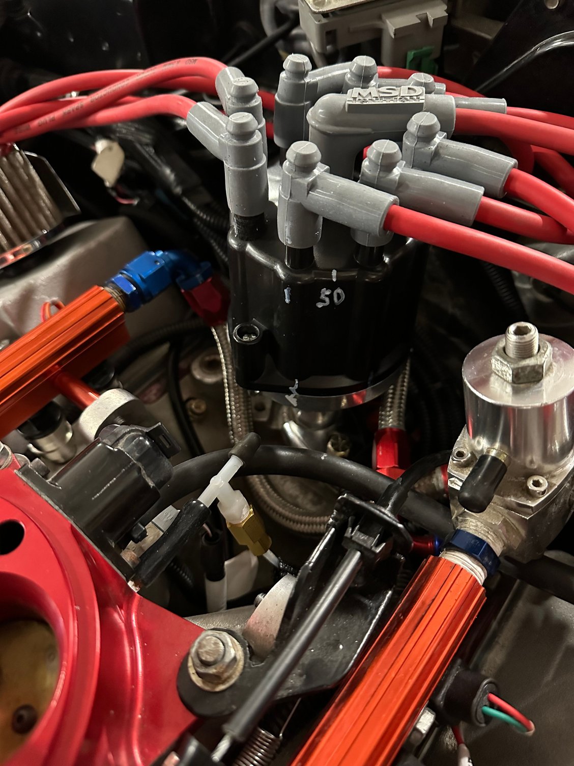

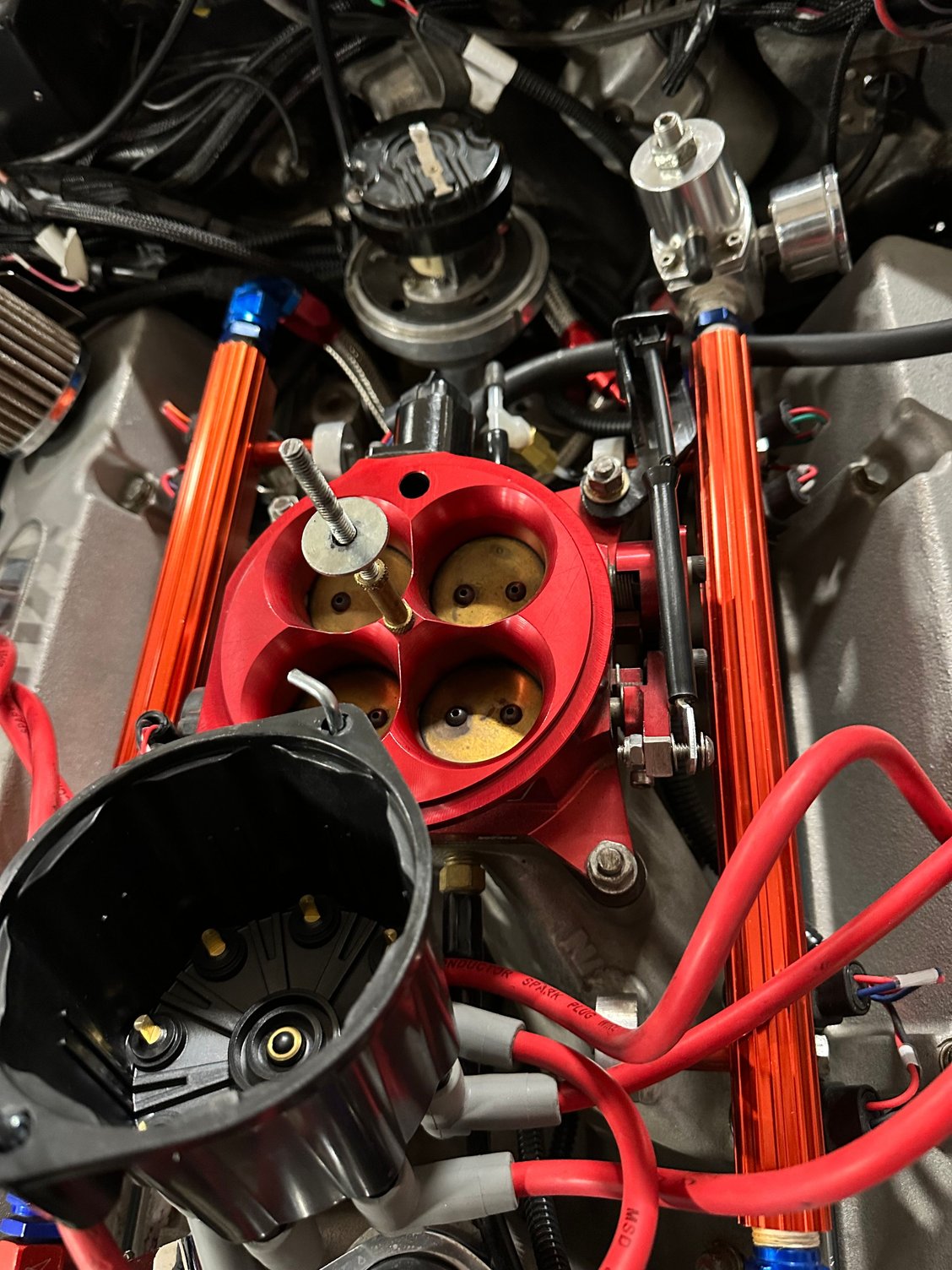

This is how I setup the distributor yesterday using the 1deg process. Balancer was at tdc and the software settings were changed per the instructions.

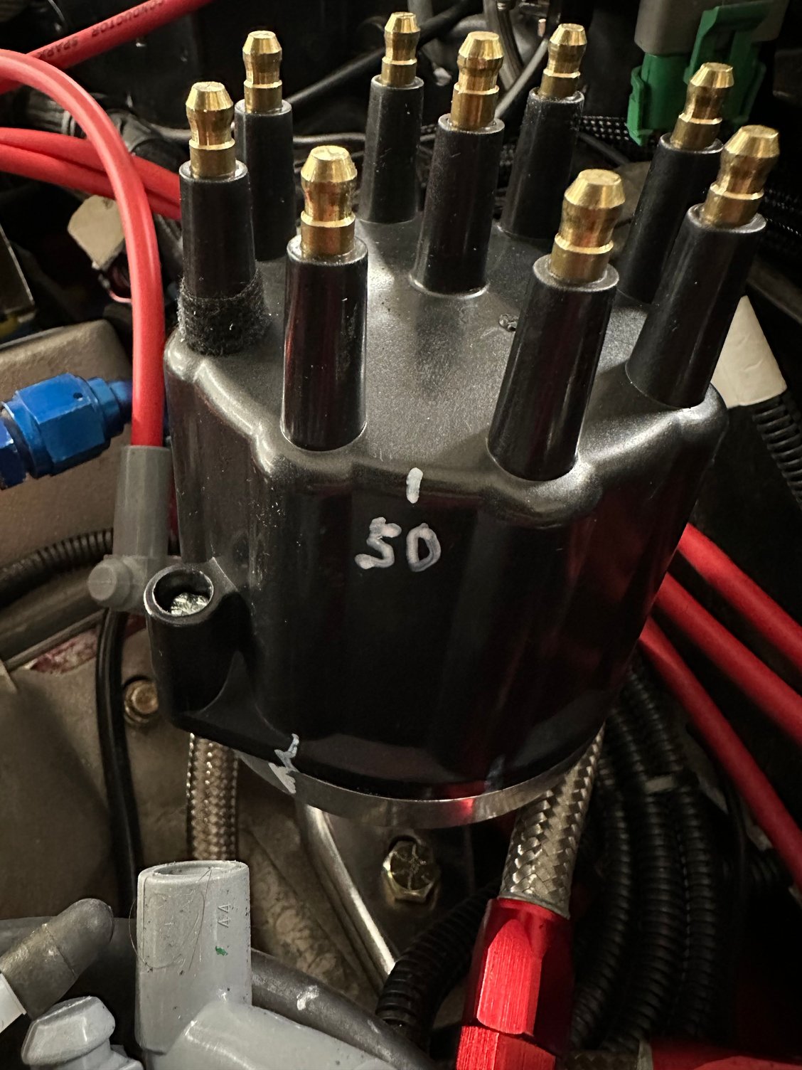

I got it running and idling at least. Timing is still off but I didn't have time to mess with it more. Next time I'll likely try swiveling the distributor back and forth to see if I can get it right.
I used the 50 degree method
distributor is pointed between #1 and #2 terminals. Otherwise the red LED/crank pulse isn't lined up at number 1 per the module (#1 is the first crank pulse counter clockwise to the green led/cam pulse). I might try the "trailing" edge of the distributor instead of the "leading edge" per the instructions.
