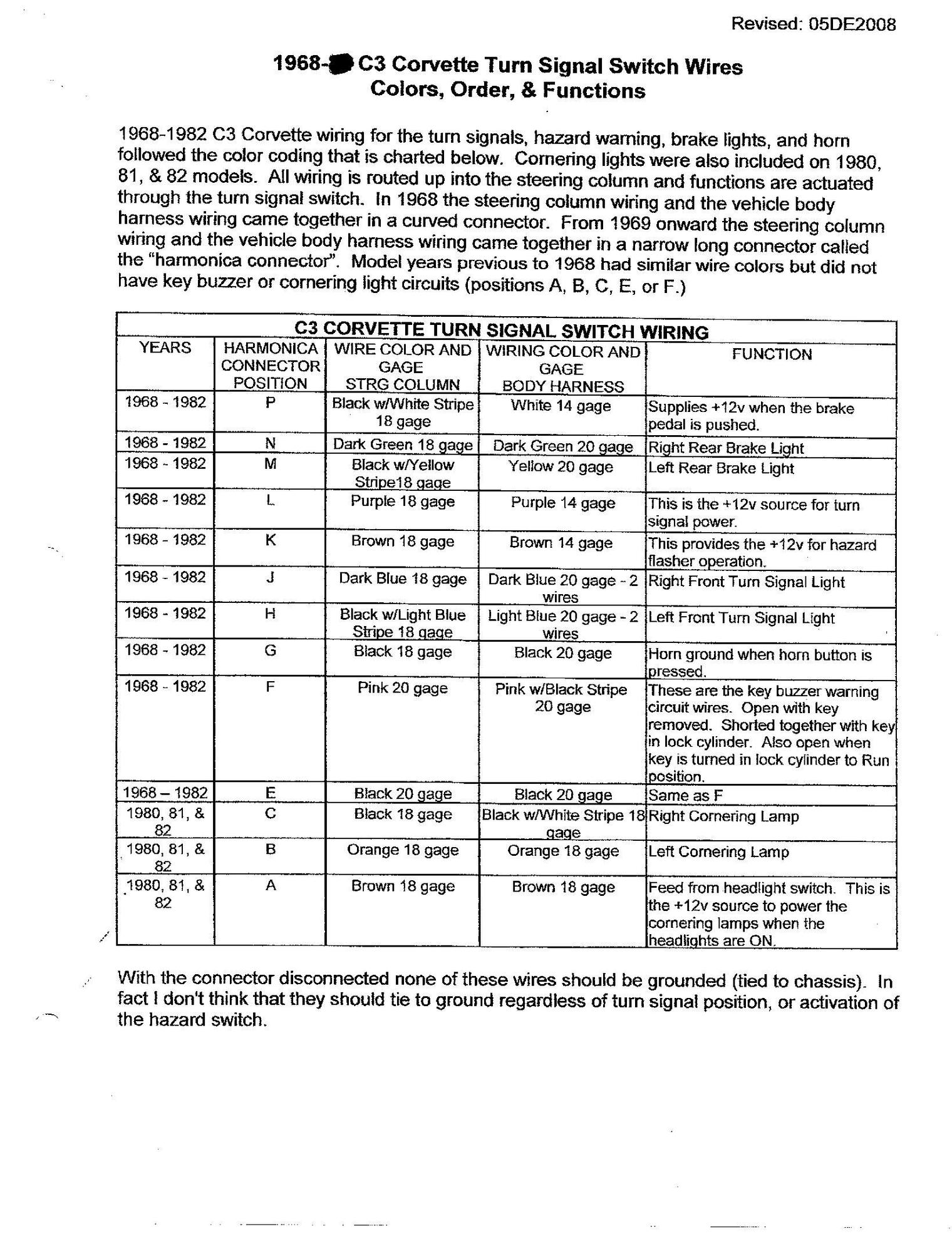

The problem is in the key switch. The buzzer was to remind you to take the key out and with you. Reminder that you left the key in the ignition.
My 71 does this as the contact in the column is stuck closed.
On a friends I was able to spray contact cleaner. plastic safe and his freed up.
KeyBuzzerDiagnosis.doc (live.com)

This attachment is helpful.
Thank you

While you're waiting to replace the switch in the column, you can disconnect E or F at the harmonica connection to silence the buzzer.

Thanks. That's what I was looking for.
