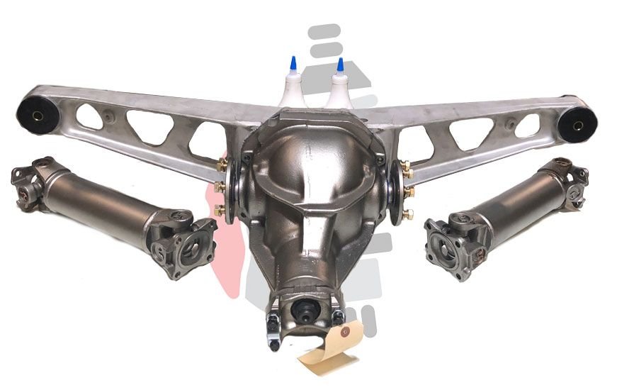

Try kit from VanSteel
https://www.vansteel.com/index.cfm?f...p=1994&ID=3596
Cast Iron Rear End Conversion. Mostly bolt in, but due to some frame variances you may have to make adjustments to the differential pinion bracket.
Kit Includes:
  • Cast Iron Rear End***
  • Your Choice of Gear - New US Gear
  • New Posi Unit
  • New 30 Spline Inner Yokes (1350)
  • New 30 Spline Spider Gears
  • New Steel Clutch Pack
  • New 1330 Pinion Yoke w/U-Bolts
  • New Poly Pinion Bushing Kit
  • New 3" Half Shafts w/Solid Spicer U-Joints (1350)
  • New Spindle Flanges w/Mounting Bolts
  • French Locks
  • New Adjustable Strut Rods
  • Strut Rod Bracket w/Mounting Bolts
  • Pinion Bracket w/Mounting Hardware
  • Labor to Machine Posi
  • Labor to Machine Housing
  • Labor to Set Up Rear
  • DOES NOT INCLUDE TRAILING ARMS, see 8082-CONV-1350C
**Photos shown with optional Van Steel offset t-arms**
***Batwing not included, some minor grinding required on your differential mount***
8082-CONV-1350

There are some questions in the advertisement above. Hopefully anyone looking for a conversion knows what to look for and what questions to ask.

Yeah, I don't think those half shafts are going to bolt on. Bet the posi isn't 'tuned' either.

No the axles are Tom’s and have the bolt pattern for the stock flanges
Tuned posi correctly done, I will not comment

The stub axles looked to have more than 4 bolts, but I'm old & my eyes are weak.

They’re dual bolt pattern
