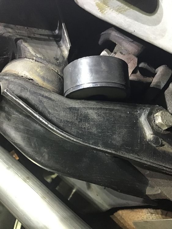

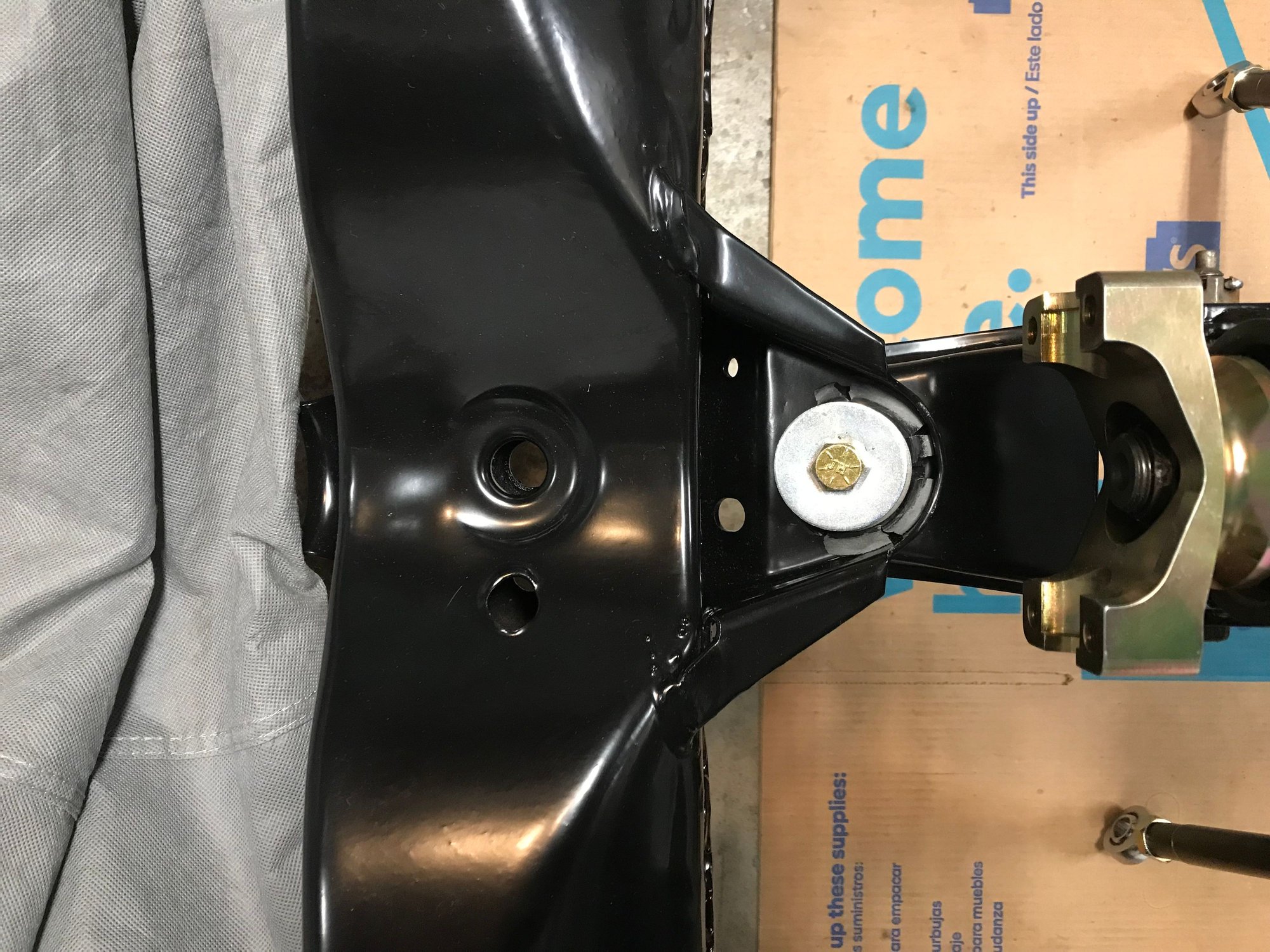

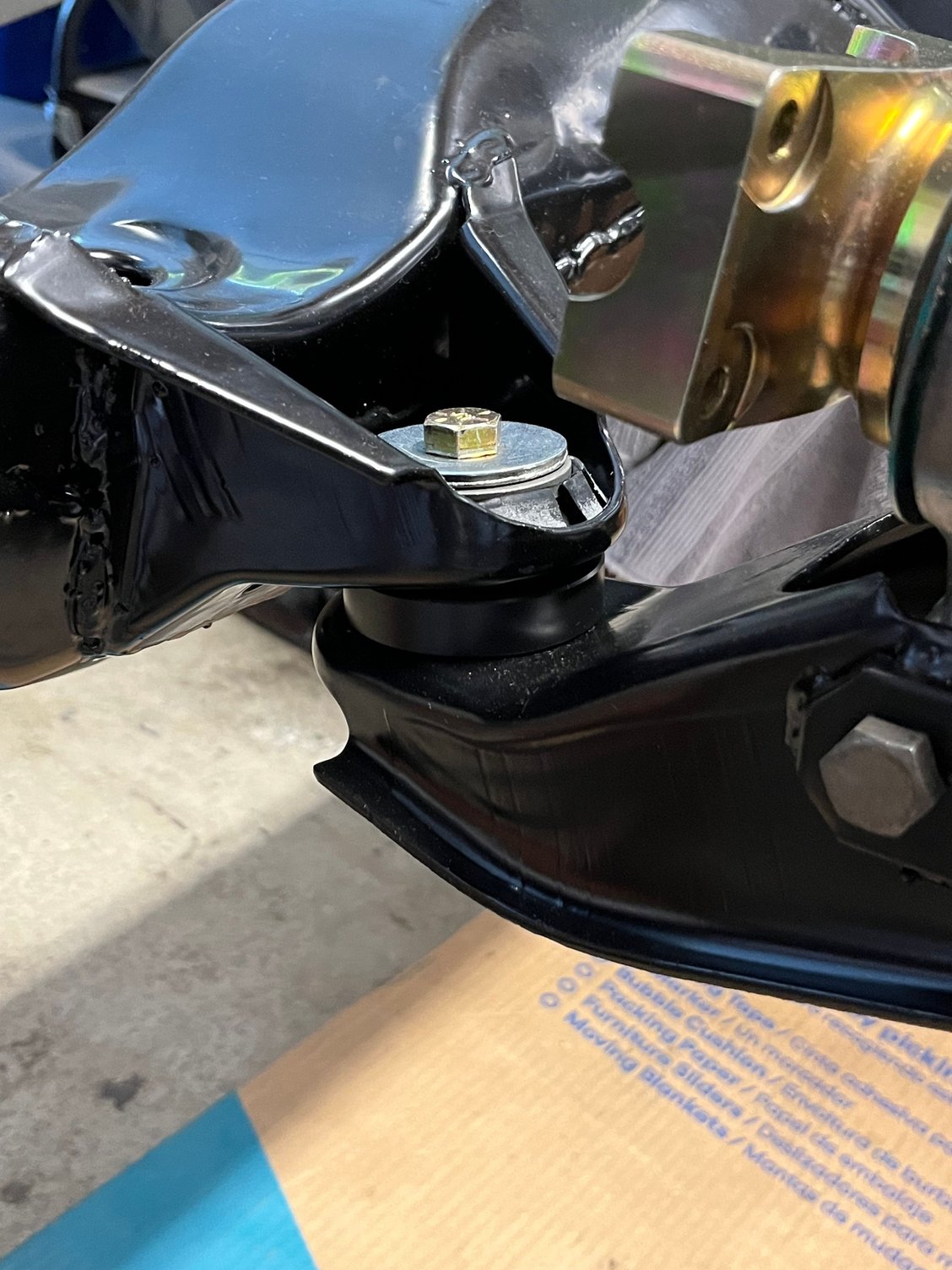

As part of my Restomod Project I purchased a couple of the best quality Polyurethane bushings for my build.
The poly bushings came as part of an assembly and I was told by the vendor and manufacturer that they never had a failure reported to them regarding the poly bushings.

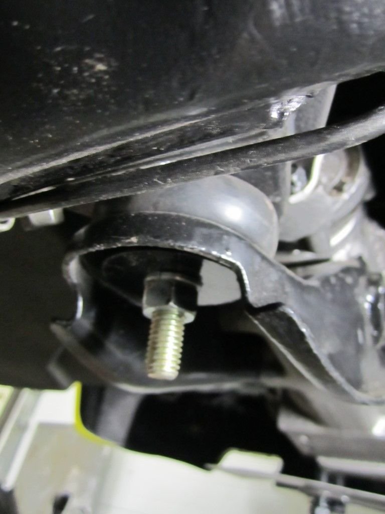

Last week I installed the first poly bushing which consisted of a poly top bushing and Delrin cushion to mount the front differential snubber bracket to the frame bracket.
I installed it pursuant to the instructions and torqued it to the required 70 ft lbs torque.

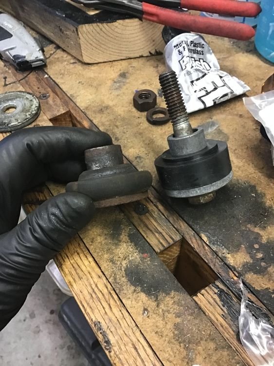

Two days later I went out to the garage to install my strut bracket and immediately noticed the new poly bushing crumbled.
At first I was told the only way that bushing could fail was if “I” over torqued it, Nope, torqued to spec.
Next came the accusation that I installed it in a bind, Nope, the differential was supported by a transmission jack, there was nothing in a bind and the mating pieces slid together before the bolt was tightened then torqued.
I am being sent a new poly bushing and Delrin cushion in the mail, no charge.
I wasn’t going to post this but, this is the first and only poly bushing I have installed in my project and it lasted two days.
That’s a 100% failure rate in my calculations, so I decided to start a thread letting my fellow hobbyists know.

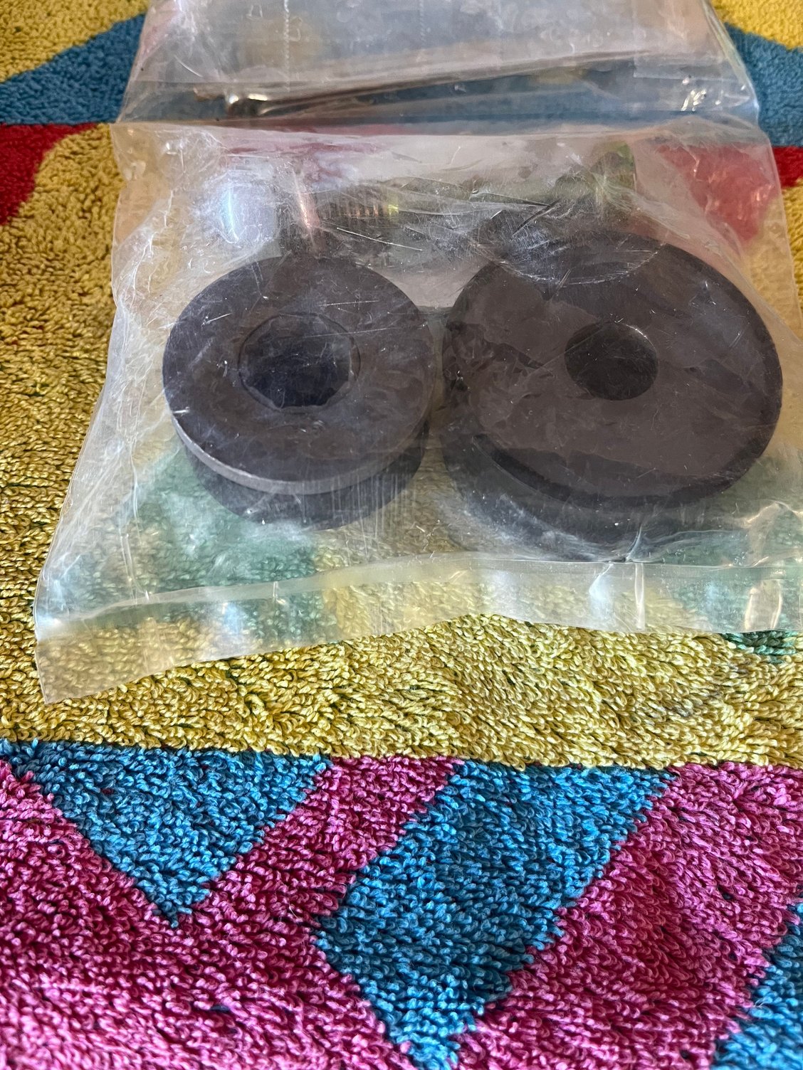

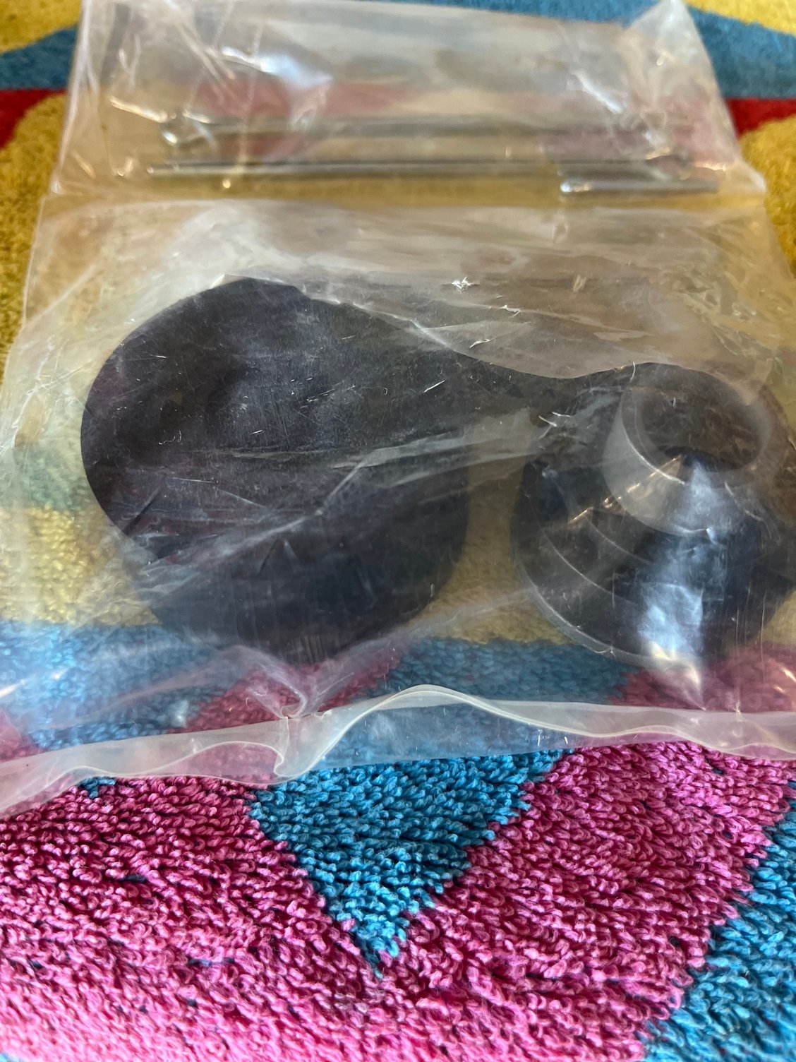

I have a new Moog rubber snubber bushing that’s been stored in its original packaging, up on my shelf for the past six years and I might toss the poly and go with a six year old rubber bushing instead.
One thing I did notice is that the Moog rubber cushion is 1” thick and the Delrin cushion is only 1/2” thick.
That is a big difference.
What do you guys think?
Do you see anything wrong in the way the bushing was assembled in the pictures?

Clearly either the vendor lied to you or started working this morning when he said that he had never had a complaint about poly. This forum is full of posts about them. Regarding the differential mount, you are correct, they are too thin. I put one in and the U joints hit the tunnel with a passenger in the car on turns and over rough roads. I switched back to rubber and all is well many years later. I also put poly in the trailing arms in my 66 and 68 coupes. They turned to glass and crumbled. Back to rubber. Beautiful frame and under carriage by the way. Jerry

I highly recommend you do not use poly, especially a poly snubber. My opinion is that they are junk, no offense to those selling them every day without a care. The snubber poly I have seen were too large and caused a change in the driveshaft length. correction- meant to say driveshaft angle.

I think I will go with a rubber bushing and get rid of the poly.
Do you think the six year old one on my shelf, still sealed in its original packaging, is still good to use or should I go with a new one?
Old Oct 29, 2023 | 01:10 PM
GTR1999's Avatar
GTR1999
Joined: Aug 1999
Posts: 15,154
Likes: 3,959
From: Connecticut, USA
If there is no cracking in it and it doesn't appear to dried out I would use it. You never know how long they were sitting on a vendor shelf.
Thanks Gary!
I’ll use what I have.
The AIM says to torque it between 55ft lbs and 75ft lbs.
I generally torque somewhere in the middle of any specs.
Is it best to torque these rubber snubber bushings toward the lower specs so the bushings aren’t smushed out too much?
Thanks,
Greg

Keep in mind you're also slightly affecting the diff angle. Worth having a look at. I had to actually thin out my bushing to help get it to sit "right" without squishing the living crap out of it
M

It sounds like the best plan is to leave it alone for now.
Once I set the engine and transmission into the chassis I can install the drive shaft, check drive shaft angles and torque it accordingly.
If needed trim the bottom cushion.
