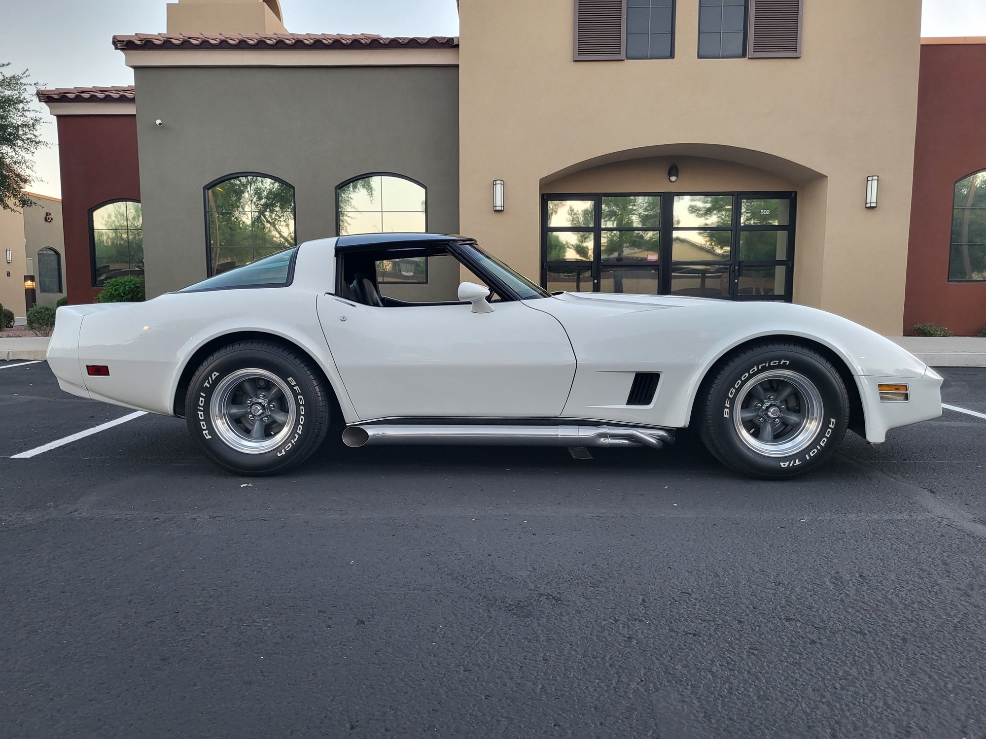

Old Nov 7, 2023 | 06:26 AM
Golfobsessed's Avatar
Golfobsessed
Joined: Aug 2016
Posts: 1,794
Likes: 936
From: Arizona
8" bolts installed, taken down about 1" rear

Old Nov 7, 2023 | 12:50 PM
RFine73's Avatar
RFine73
Joined: Jan 2022
Posts: 57
Likes: 36
From: Brighton, CO
Love that stance @Golfobsessed. That what I'm going for.
