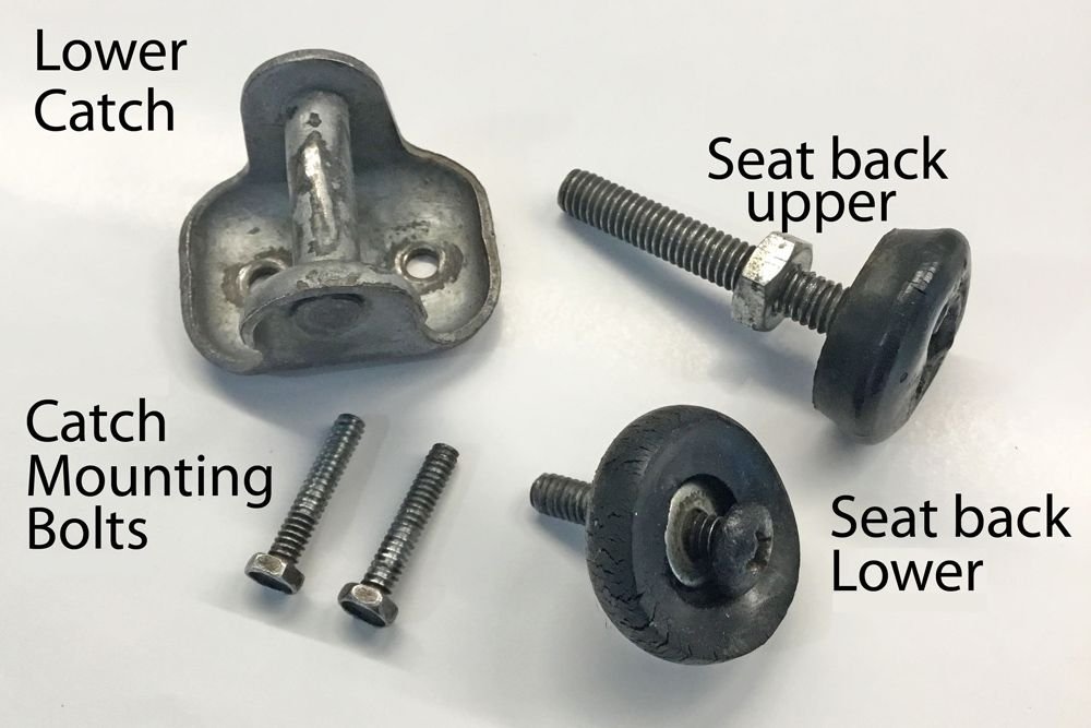

When I was working on my interior of my '69 I looked at the available hardware from the vendors and saw that what my car originally had not what they showed for a 69. I have had my car since 1974 and knew what I has was the original pieces.
It appears that they changed the seat hardware sometime during the 69 run. My car was built in late June of 69 and the picture shows what it came with from the factory.
Thanks Robert!
That explains it perfectly. That is exactly what my hardware looks like. My car is a mid November, 1969 build. I bet the upholsterer lost that upper bumper and just put it together without it. The car had 10,000 miles on it from 1978 to 2017 which is the year I bought from the 2nd owner. Doubt it had much passenger use!

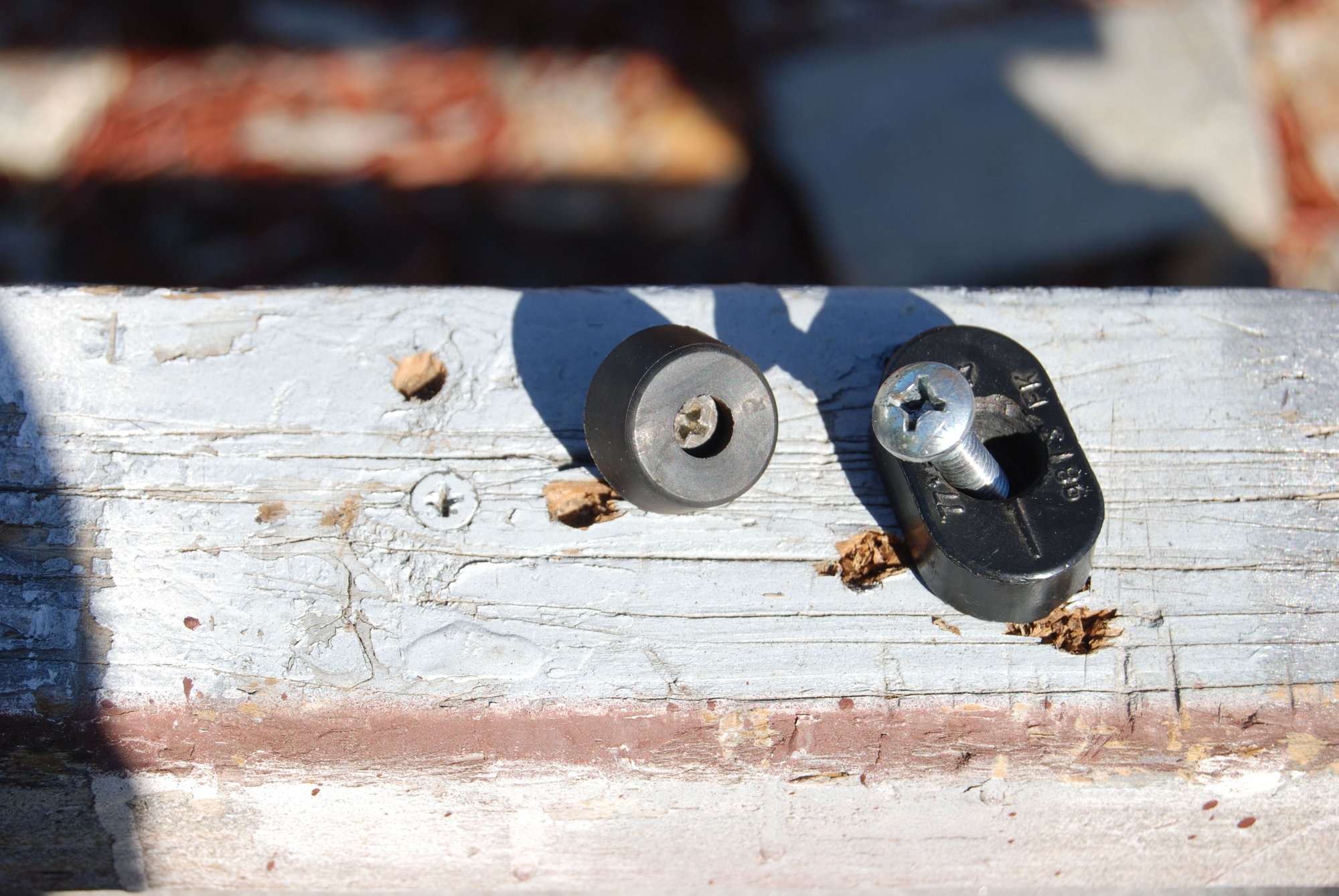

This is what's on my January 69. Bottom is an oval rubber bumper with a threaded fastener. Top is a sheet metal screw into another rubber bumper. There is no adjustability and it looks like the upper fastener hole is correct for sheet metal, it's not threaded that I can tell. I was hoping it looked like the posted pictures, but it doesn't, so no adjustability.
AFAIK they were adjustable via use of shims.
Old Nov 9, 2023 | 12:28 PM
ignatz's Avatar
ignatz
Joined: May 2004
Posts: 4,364
Likes: 1,588
I could do that I suppose, but I would rather drill and tap into the upper to retrofit the newer style. That's a chore I'll save until I, hopefully never, have to take both seats out.
