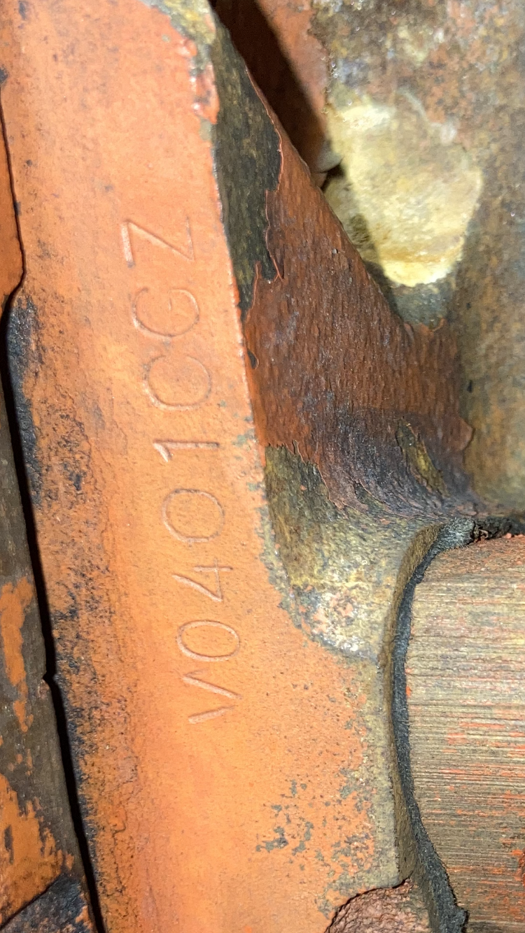

It looks like this with "CGZ"

Personally there is an issue with the number 4 in your photo. It is not the typical font seen. Do you also have the photo of the VIN number stamped next to the suffix and the casting number on the rear of the block. Also the paint on the pad area should be removed to have a better view of the pad. Use paint thinner to remove it as to not damage the pad with tooling marks.
