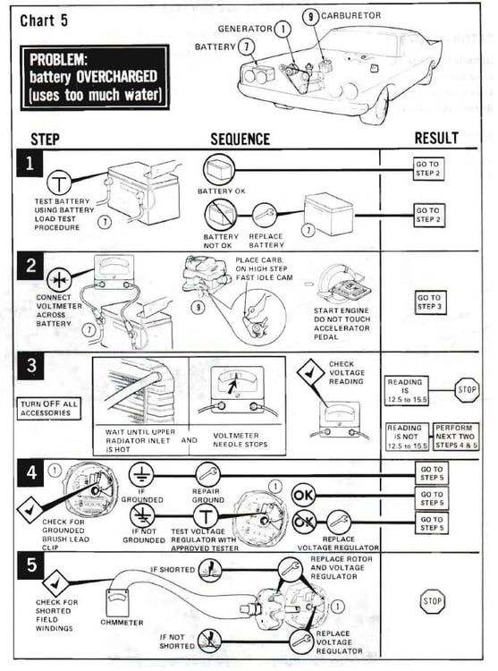

I am not sure it is over charging.
my 79 hits 15.4 volts with no issues measured with fluke and surprisingly accurate on my volt meter a hair below red which I’m pretty sure is 15.5 volts.
just replaced battery at 6 years water level fine. Original alternator.
below @bmotojoe 77 manual posted prior.
i wouldn’t toss old alternator if original..the new chinesium rebuilds are terrible and draw hp compared to original in my experience.

Originally Posted by 4-vettes
First off, Tuff Stuff and others supply USA made and or rebuilt alternators.
And I am absolutely certain that anything over 14.5 volts is DEFINITELY over charging. This is hard on your battery and can also blow bulbs throughout the vehicle.
If you have any doubts about this I suggest you read a service manual.
i said chinesium rebuilds..not the ones you mentioned USA , specifically ac delco rockauto.
i suggested to op to not toss the old one if original bases on my experience.
my alternator puts out up to 15.5 volts at idle low draw.. it drops under load.
I never had a boiling or lack of water in my battery that lasted 6 years.
the pic i posted is from 77 passenger car service manual posted in thread below. There s zero voltage at alternator information n my 79 service manual
post 114 and 115 shows video of identical load on engine comparing oem to chinesium rebuilt ac delco…fyi the ac delco was 14.8v .06 less than my oem one.
too bad many do not test load on various alternators..would be interesting 🧐
https://www.corvetteforum.com/forums...uestion-6.html
