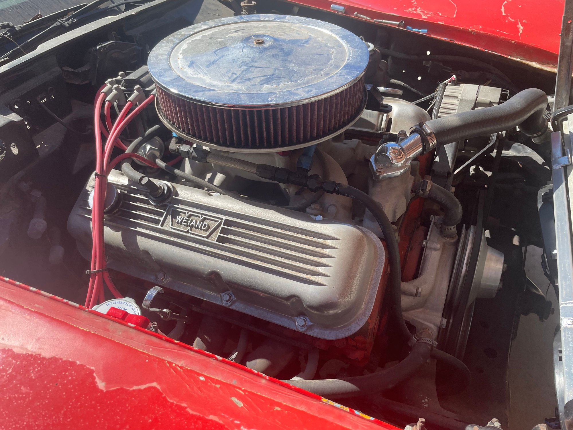

So I bought a 69 convertible with a 468 4 speed. I’m pretty sure the carb is too big for the motor and was thinking of going to an EFI set up. Has anyone used the new Aces EFI yet? Reviews look pretty good. Want reliability. Which one should I look at?

How big is the carb? Why do you think it is too big?
The Aces has not been on the market long enough for me to even see one in the field.

I agree with Jebby. Generally there is not a carb too big, only a carb that is improperly jetted.

So I asked the guy I bought the car from. Says it’s an 850 Quickfuel holly. Is this carb too big for the street? How would I go about tuning and trying to get the raw gas smell down.

Depending on the engine build, you could be spot on with an 850 cfm.
If it’s a mild build and you just cruise, a 750 cfm would work good on the street.
Either one, if tuned and jetted properly would work fine.

that 850 should be fine with that Air Gap intake manifold you just need to get a QF rebuild kit unless you want to spend a lot of money
