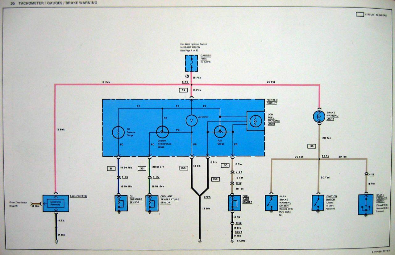

Dark blue is oil pressure sensor according to this drawing
That schematic is not for a '72 - the tach is mechanical; there is no low fuel warning light; nor is there any sort of printed circuit board in a '72!
