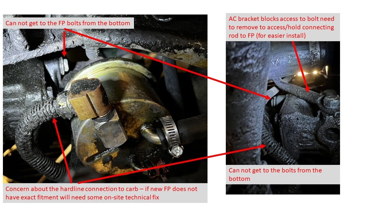

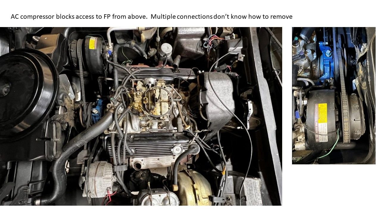

If you own a classic car you really need to learn how to do the maintenance, otherwise it will break your bank, paying others to do it for you and they probably won’t do as good of a job as you the novice will.
From bottom I can disconnect hoses, but that is about all I can do.
From side well the FP is still sitting below the top suspension arm - not really accessible as AC comp still in way
From top - need to remove AC compressor. I can see the hardware mounting points, but I don't know how to deal with the hose connections. I have not found any source that goes into more detail than just "remove the AC compressor". all the videos I have seen lack an AC.
So, if I get to the point where the fuel pump can be removed, I then put on the new one - but I am seeing multiple times people finding that the new pump does not align with the hard hose going to carb and have to make modifications. This is a bit concerning to me as I am already out over my skis on experience here.

I don't understand why the A/C bracket is anywhere near the F.P. I had the same A/C compressor on my SBC and never had any problems getting at the F.P. bolts.
And you need a safer shroud.

You really can't reach those bolts with a long extension through the wheel well?
Is your AC pressurized? If it works, leave it alone. Or if you are hell-bent on removing it, be sure to have it evacuated properly before you delete the compressor. If it's not pressurized, perhaps you needed a new compressor anyway, so no great loss.
I'm really surprised you can't get to the fuel pump, though. Are you on jackstands with the wheel removed? You can take off the CAI duct by removing two screws.
