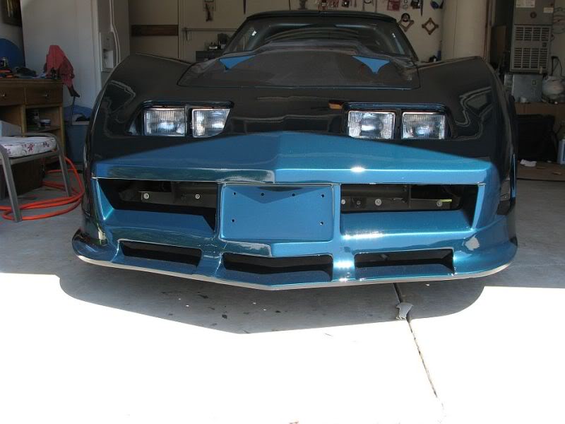

QA-1's are so nice with the dual adjustable. I can turn them up for ride height street driving and down for track days. Oh, I forgot to say that many years ago I installed a bump steer kit so my camber has very little change on vertical up and down front end movement. heavy springs also limit it to a couple of inches under braking.
Just after repairing the front end from a track day. I don't have the headlight covers on yet. 1981 daytona front end fiber glass kit that took 150 pounds off the front end. No grills and the front air ducting scoops installed

Doing the fiber glass work at home. The front air dams ride right down on the road under the radiator to keep air out from under the car and make water cooling better.
Power steering dripping again. Even with power steering 10X11 cooler radiator. I've done the control valve and power steering pump even with pulley ratios many times because of 295 front road racing slicks. Shifting many times around a track at 7500 rpm you have to think about water pump, alternator, power steering rpm
