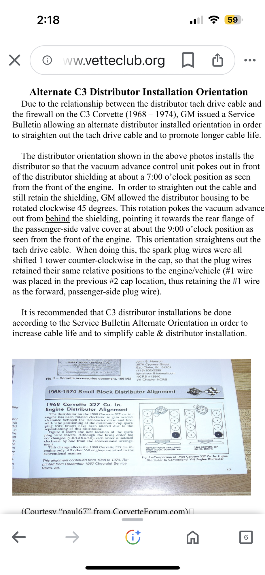

Do you have the distributor properly clocked? Chevrolet released a bulletin concerning the tach cable and repositioning the plug wires in the cap. Google for a paper by Lars Grimsrud on how to install the distributor and page down for the reclocking of the Corvette distributor.

So just read the paper I suggested to confirm whether or not it's correctly clocked

Ok I I’m reading this right mine has been reclocked. The vacuum advance is reorientated towards the valve cover as seen in the photo on the right.
