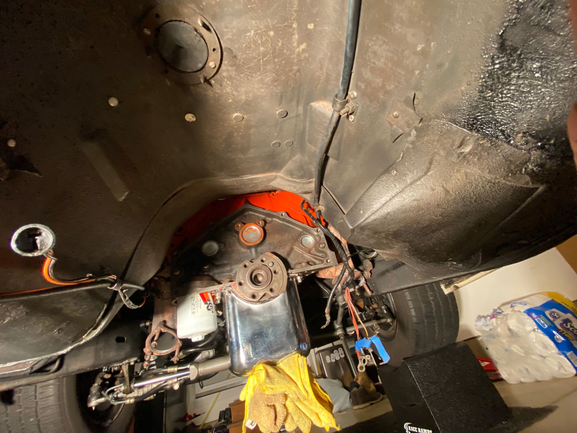

I did it 2 years ago. Honestly getting the pedals out/in was probably the hardest part of the swap. I pulled the gauge cluster, center gauges and console, steering column and drivers seat out to do it. I used the opportunity to fix some wiring issues and swap to all led bulbs in the dash. I rebuilt the steering column while it was out too. I took my time throughout the conversion and I had it done in a month or so working in the evening when I had time. I did the hydraulic clutch too and I definitely recommend it.
Now after all that, it was worth every, swear, busted knuckle and penny. It completely changed the car, brought it to life (and I have a 454)! It is such a blast to drive now, I recommend it completely. I got my kit from SilverSport and they were great to deal with.

Here’s some pics

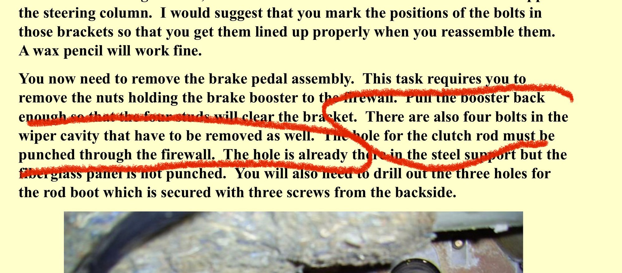

I am still hoping someone will give me a “yes or no” answer as to whether i would need to remove the wiper door or not.
i have wore out the internet searching and reading about this😊, it seems that there are bolts in the wiper cowl area that need to come out for the pedal box removal.
most of the detailed info i found, wasnt doing this swap on a chrome bumper year car with a wiper door.
No you don’t have to remove the wiper door, just the grille in front of it. If you shine a flashlight in there you can see the 4 bolts.
