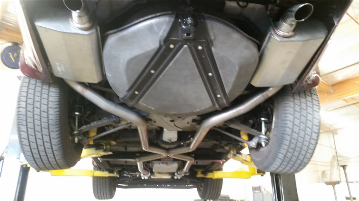

No idea what you have now. Like mentioned, go check it. Yes, you must install an O2 bung and sensor into the new exhaust if you rip it all out. If you are in a state that doesn't require emissions, bonus. Heddman makes a set of headers with the AIR tubes if you want to keep everything as well. Also, if you want to run true dual exhaust 2.5", you will have to replace the crossmember. Here is what I did I my 82 and works just fine, direct bolt in crossmember as well. I also installed 2.5" Hooker Maxflow mufflers. GL

Nice looking set up! One suggestion on the part where it runs under the leaf spring, I would recommend a heat shield or DEI wrap in that area. I am not a 100% on this but I feel that the accumulated heat in that area before it goes out the muffler will heat up leaf spring, which eventually will cause it to sag. Just a theory. Even though my car has low mileage, I think that and of course age caused that to happen to mine. I am currently waiting on my 360lb composite leaf spring from Van Steel.

I haven't noticed any issues with the spring and it is somewhat new and will probably out live me, so I don't really care. I do not like the composite springs and never have. I rode in one a long time ago and was probably not the correct spring for that 82 and it was down right HORRIBLE on the ride quality. Mine is stiff and works well, I had custom leafs made locally.

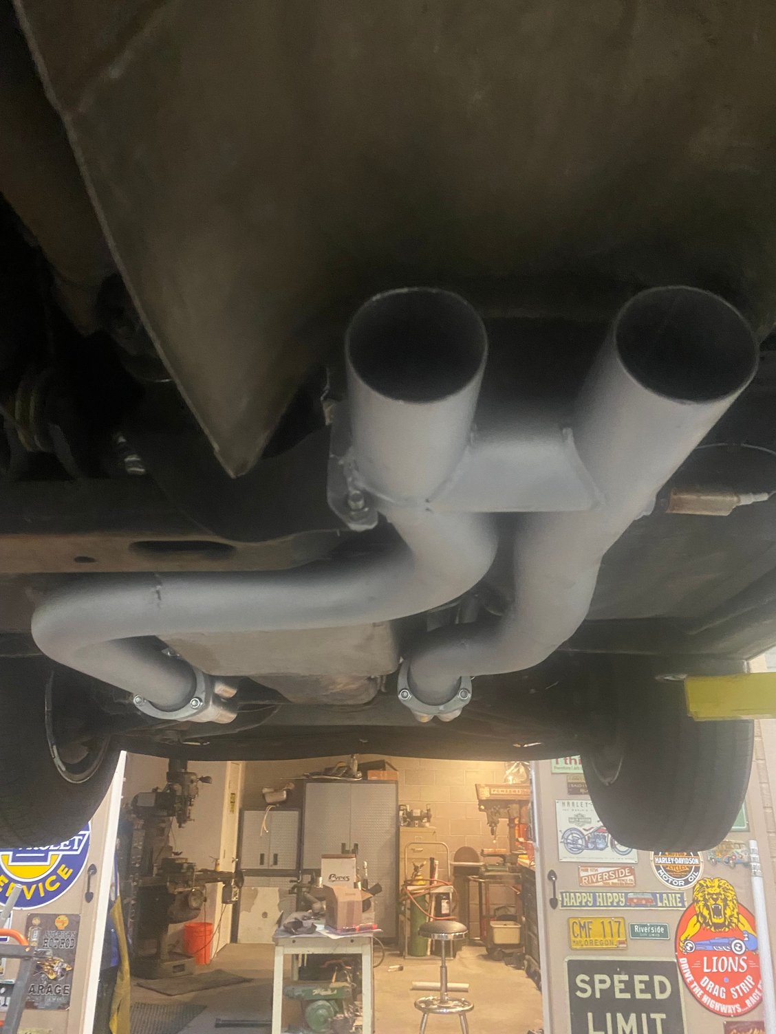

Here's a recently purchased 82 CE with the steel FE7 spring. You can see the stock exhaust routing in the photos. My understanding is that even with the replacement crossmember, the low floor for the power seat can cause issues in 82s and some 81s when using dual-exhausts meant for chrome-bumper C3s. You can see that @Buccaneer's solution avoids this problem, too.

I used the Pypes dual exhaust that routes both sides to the passenger side. Works slick on 81 & 82 cars with the driver side dropped floorpan. And you don’t have to swap out the crossmember. The Pypes system goes in easy but you will need to work on the center hanger.
I added O2 bungs in the header collectors on both sides just in case I wanted to upgrade my fuel injection system down the road.
