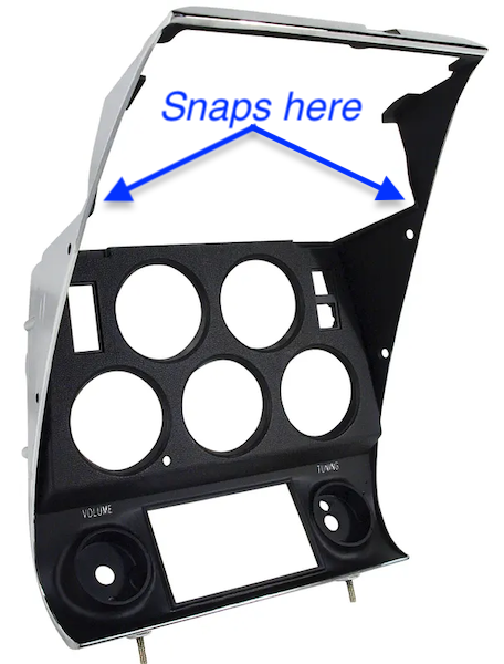

Which year C3 do you have?
The earlier models ('68-'76) have a center gauge bezel that has a very weak point below the wiper switch. The deal is that the switch itself must be grounded to work and that ground comes through the bezel. With the break, it may not have a continuous, reliable ground path. If you have this style and it's broken, but don't want to replace the bezel, some folks have run a ground wire between the top and bottom sections.
